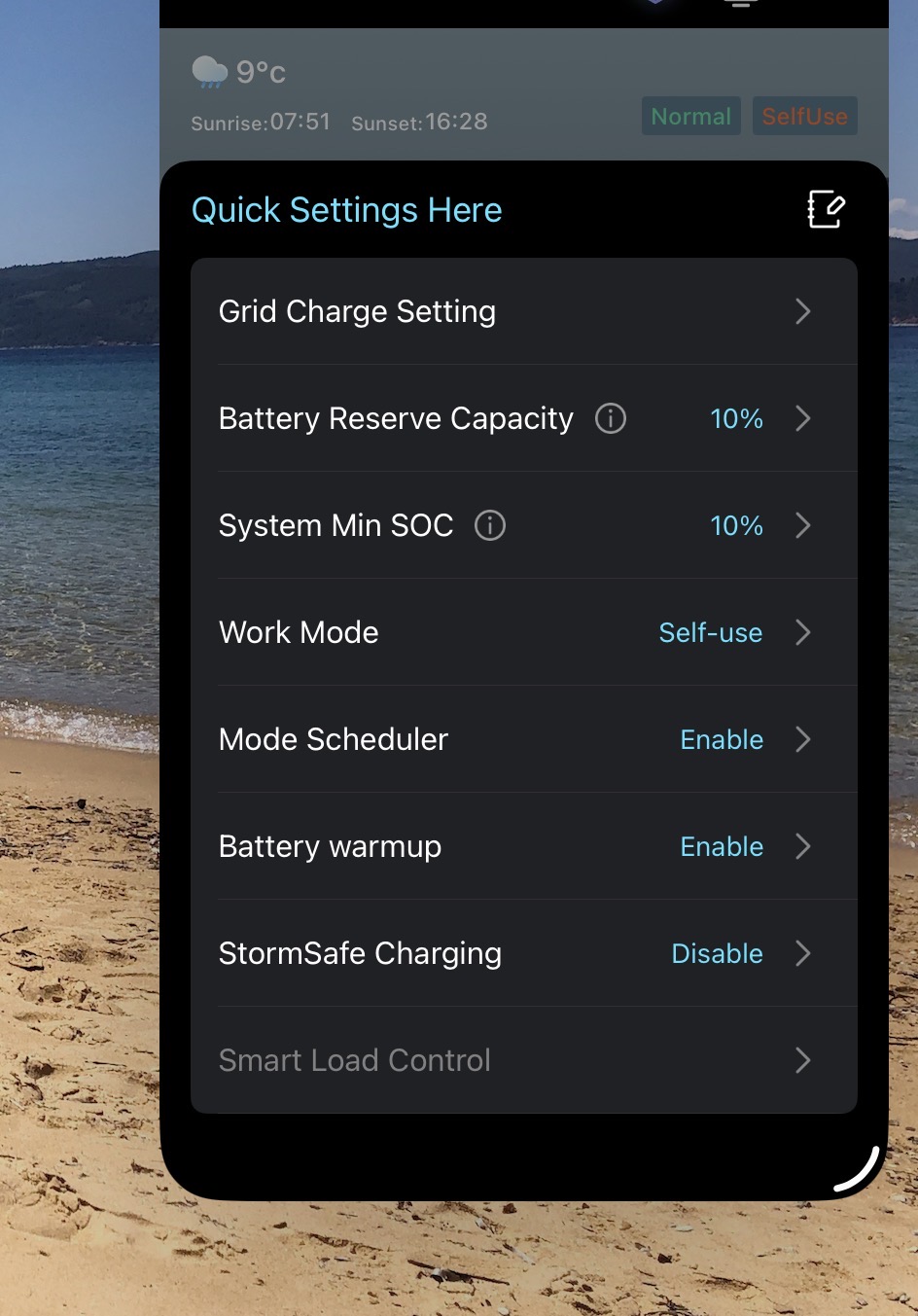

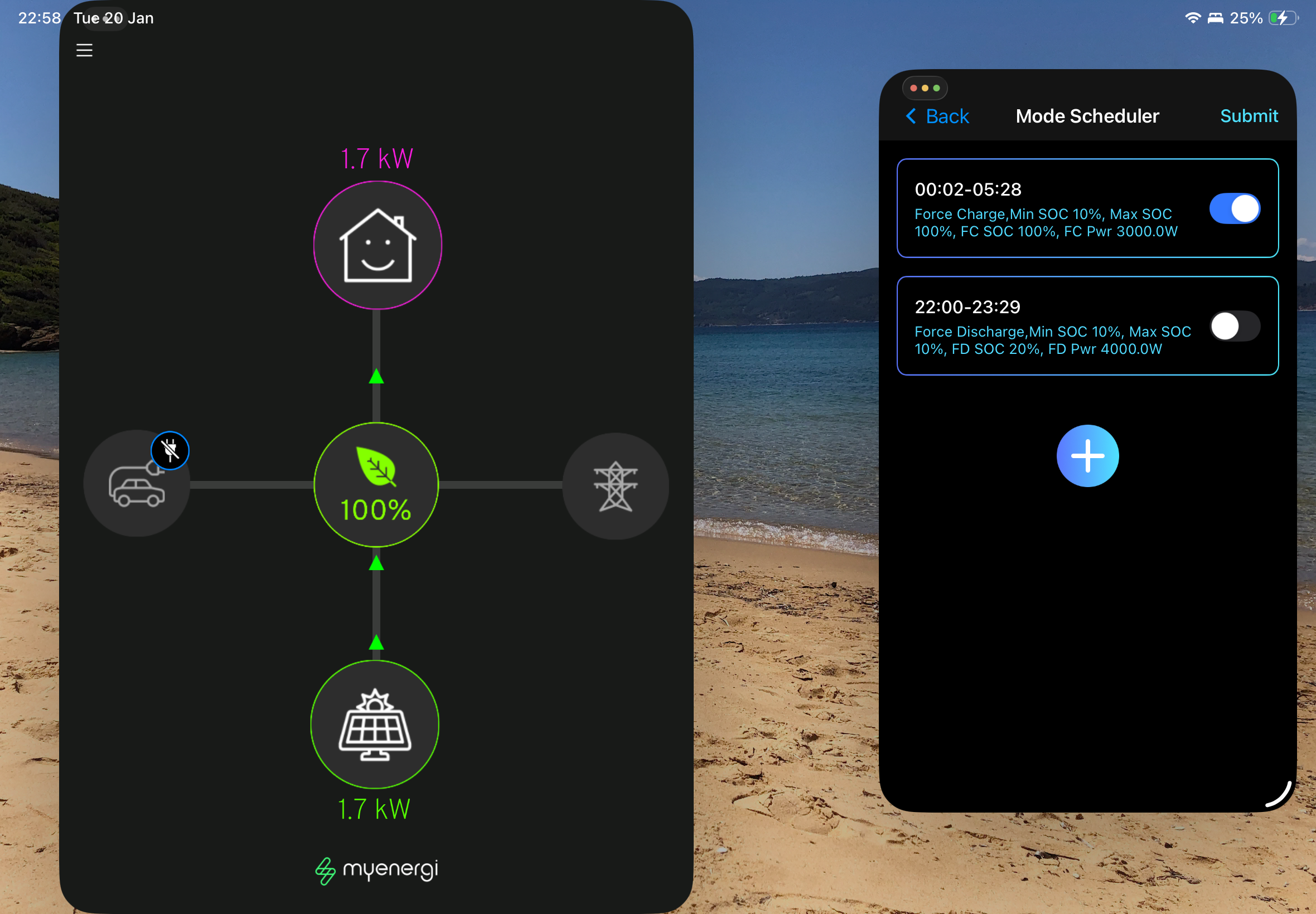

FYI A number of people have reported that old / disabled schedules got activated & run after performing a firmware update. So as well as checking the CT setting, it's probably worth also checking the mode scheduler to confirm that it is in the expected state.
