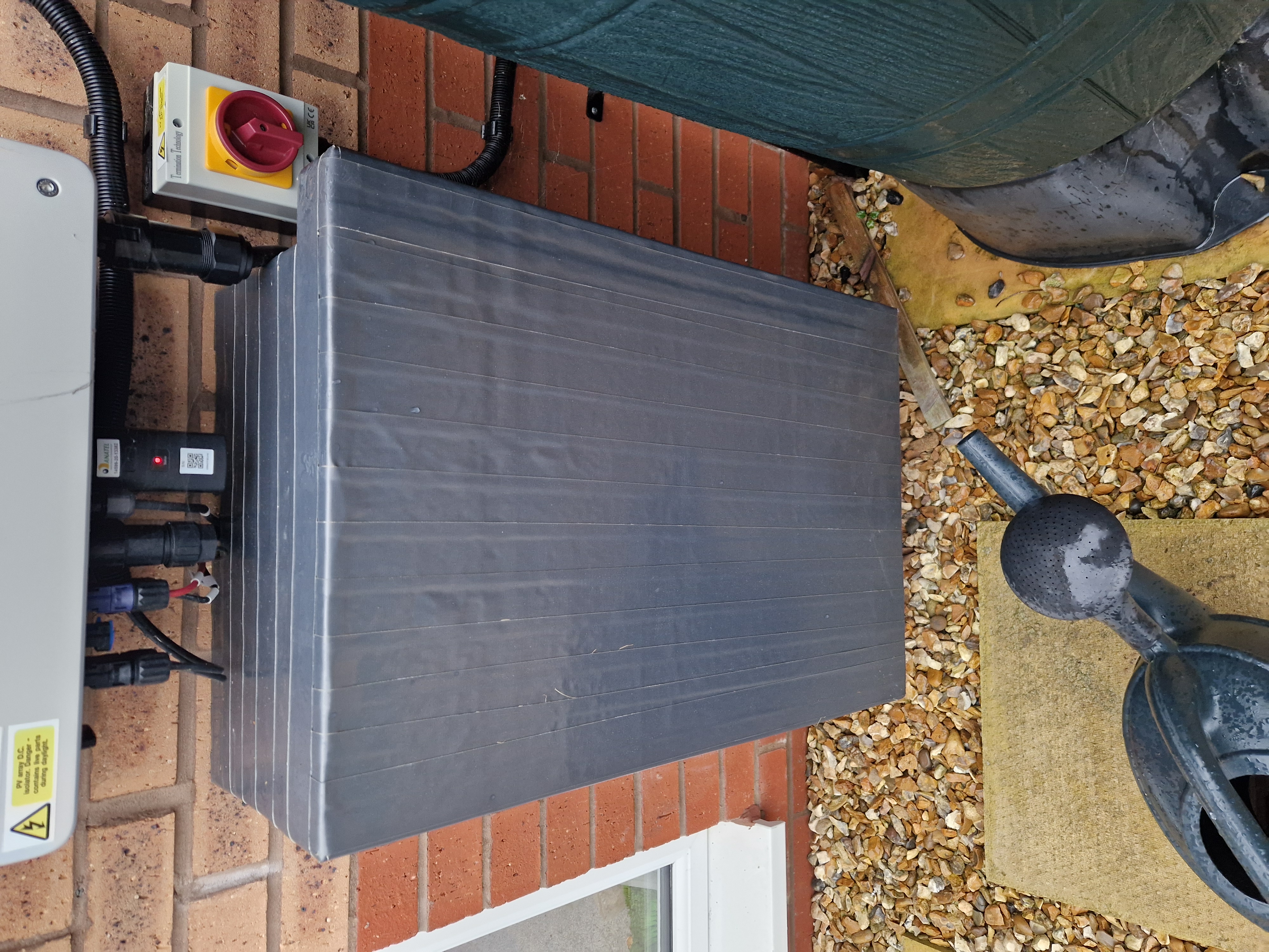

Thanks Dave - great help. Overnight last night, the ambient temp got down to 0C, but the battery (possibly as it still had plenty of charge) only got down to about 3C, and continued discharging all night and this morning despite the cold. Although interestingly the discharge current has fallen from 20 this morning to 10 now. But it does seem like it performs better at keeping the discharge function on when at a higher SOC. I wonder if that's what others have found? Barely any solar coming in today so tonight will be another learning night as the battery approaches minsoc.
I will look into that 50mm Kingspan sheeting - some sort of removable, vaguely rainproof 5 sided box I can shove against the wall for winter sounds ideal. Location is fairly sheltered although not under a roof. I will see if I can tap up a mate with some tools and the capability to construct something. Have you done that kind of setup yourself, or seen it done? How would I fix those sheets together? Appreciate construction might not be your area of expertise

I will look into that 50mm Kingspan sheeting - some sort of removable, vaguely rainproof 5 sided box I can shove against the wall for winter sounds ideal. Location is fairly sheltered although not under a roof. I will see if I can tap up a mate with some tools and the capability to construct something. Have you done that kind of setup yourself, or seen it done? How would I fix those sheets together? Appreciate construction might not be your area of expertise![]()

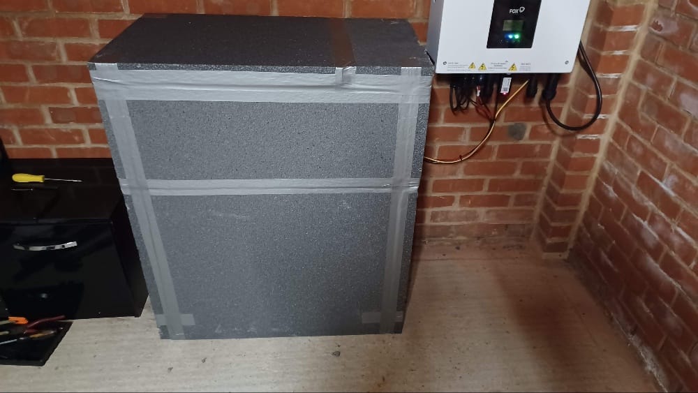

The 50mm Kinspan (or Recticell etc..) is very rigid and stands up on it's own, whilst my batteries are sat on insulation and lifted off the floor with 4x2" beams I have them surrounded by 50mm insulation sheets and a piece on top with cable cutouts - all held together with duct tape - this stuff is extraordinarily strong and will hold the edges together really well https://www.amazon.co.uk/dp/B0BXB7X9HZ?th=1 - it holds together well and can be taken apart when needed.
It is just the battery that needs insulation, the inverter is air-cooled via the rear fins and will get hot when worked hard (when charging or lots of solar generation) so having good air flow is important.
