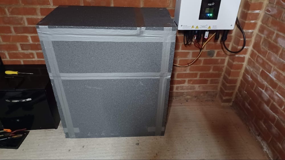

It’s a popular move by users that have external batteries or where they are prone to low temperatures, it works really well.
Most people go with Kinspan (or similar) 50mm insulation boards to make an enclosure, you need to leave an air gap inside - Fox recommends 300mm but many people reduce that, particularly where they have either air flow or they remove it in the warmer months.
This is an image i’ve seen posted quite a few times.

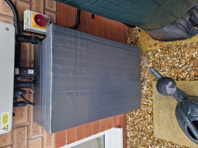

I did insulate, attaching a photo here. I went with a 50mm Kingspan 5-sided box with cutouts for the cables (property wall makes the 6th wall of the sealed insulation). Wrapped entirely in the weatherproof thick gorilla tape. It's very tight fitting, deliberately, so it can be left on permanently in winter without moving, and removed for summer. In case it's not clear from my photo, like yours the battery is part way up the wall, not sitting on the floor, and therefore there is a 'bottom' to my constructed insulation. This keeps it held on nicely. Materials cost about £50 and that's including having half the board left over due to the sizes available. Cutting the insulation to size was a messy job and needed a mate with a workbench and saws, outside as I have no garage space, but didn't take very long and the cleanup was ok with an hour or so of sweeping and spraying down the patio.
My very non-scientific estimate is that it keeps the temperature, noted in the app, maybe 4 or 5 degrees C above what it would otherwise be. This has been enough to keep it online overnight on the few sub-zero nights so far. Whereas last winter it seemed to regularly get down to about 2 or 3 degrees and then switch off, before taking ages to warm up enough the next day to even start charging, I've only noticed a low so far of 5 or 6 degrees on the coldest night. I will say I've yet to have a long sub zero night followed by a day where the daytime temps remain very low, which will be the true test. But early signs are promising. I have had cold nights followed by multiple days of zero solar, so no warmth getting to the battery at all, and it has kept the battery online.
Another benefit seems to be that, during average winter daytime temps, if you do get a long sunny day, the insulation keeps the battery up to almost 20 degrees during charging from solar, which means you get the more efficient charging speeds. Much warmer than it would otherwise be on my north-facing wall.
I'd say overall definitely worth doing - obvious benefits of keeping the battery just warm enough to work overnight, but also generally it keeps it warmer when it has been working, so it starts from a higher temp before it cools down overnight. So you're benefitting round the clock.
