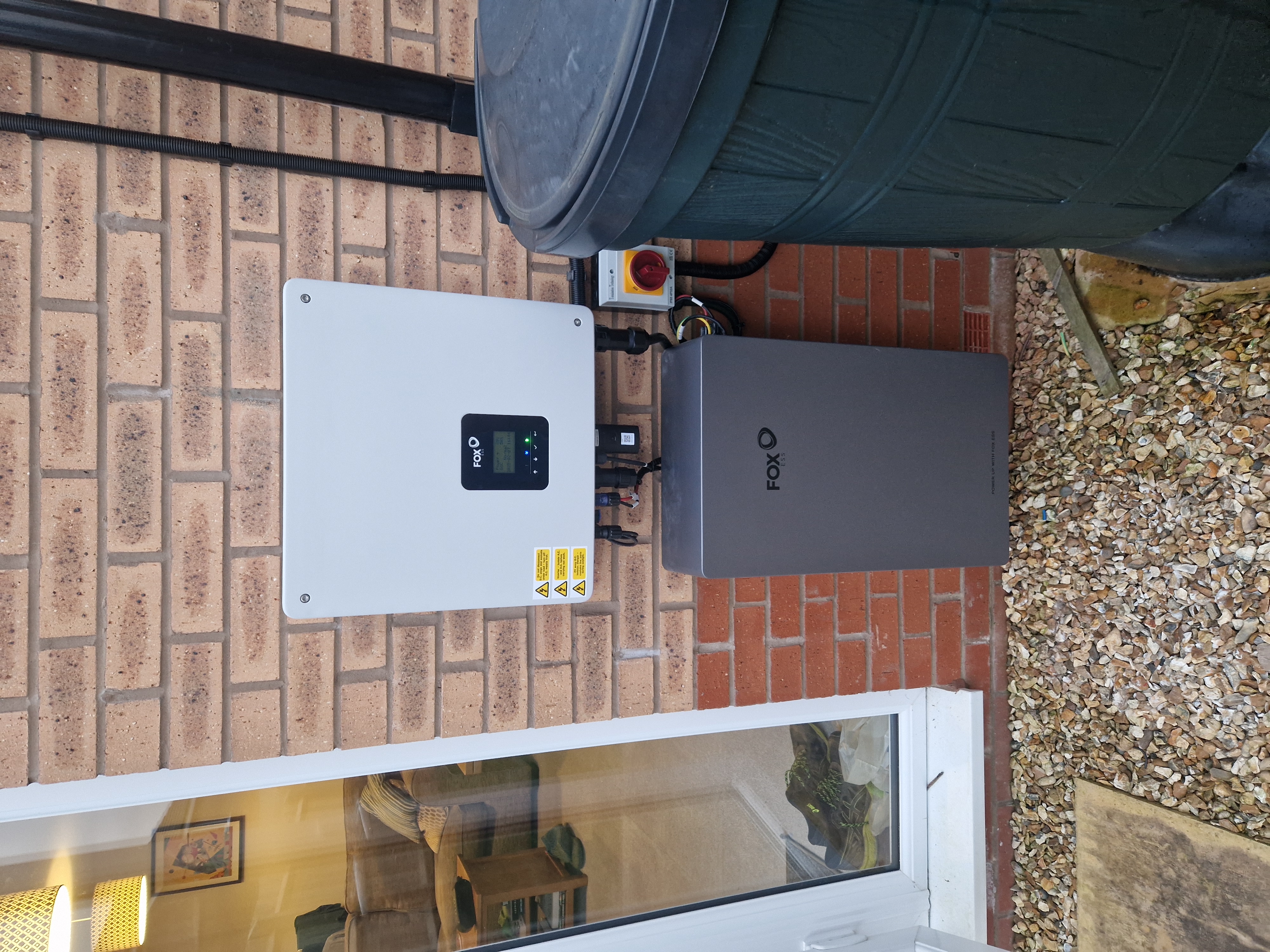

Apologies for the long post, I have had a new solar panel + battery system installed via my local council's Solar Together scheme, and the battery and inverter have unexpectedly had to go outside. I've had little to no guidance from the installers and there seems to be no Fox end user guide or manual, only installation guides. And although Fox do respond to tickets raised very quickly, I can't exactly raise a ticket saying 'teach me how to use this and keep the battery warm'. So I'm a little desperate for some assistance.
Initial surveyor wrongly informed me the battery and inverter could go inside the house. A few days before installation I was told this is against the fire regs of the scheme, so on the day, with no guidance or knowledge, I had to pick somewhere outside on the wall of the house. This means I have a completely uninsulated battery outside that, although rated to be weatherproof outside, which is a positive, it slows to trickle charging in the cold, and for the last two nights has switched off discharge until well after midday the next day as it won't warm up. Installers basically told me how to download the app, warned me 'the battery won't work in the cold, that's normal, not a fault', and left me to it.
I have now scoured the internet for a week or more, and I gather the battery will throttle charging significantly according to temperature - I saw a helpful table on this forum, and I think I have this part figured out. Hopefully this means in summer everything will be great, as the system is installed on a north facing wall, and should stay within the good range even in our increasingly hot Midlands UK summers. However, the battery temperature (not ambient temp) is going down to as low as 2C overnight in this winter, which seems to prompt a charge from 10% SOC to 60% overnight from grid, even though charge from grid was disabled. Add the cost of this charge to the fact that I'm then not able to use the solar the next day to charge the already nearly full battery (as there is so much it exports to grid), plus the battery takes a long time to warm up enough to discharge, and I'm concerned I've been sold a system that is going to be next to useless for my needs through winter. I had planned to use overnight cheaper tariffs to charge the battery and (in future) an EV. Not great if the system throttles the charge/won't discharge on just averagely cold nights, not even deep frosts.
Some initial questions:
- At what temperature does the battery shut off discharge? And how can I prevent this happening?
- Is the automatic 10% SOC charge from grid to 60% a known reaction? Will it happen every cold night? Is there a set temperature this process is triggered? And can I prevent it in any way?
- I watched a very useful video from Will on here about insulation solutions. Unfortunately, I do not have 300mm around the battery to construct insulation (see image - any insulation structure would extend across my windows and into the garden gate/downpipe/water butt to the right). Nor am I able to do much DIY for reasons I won't go into. How can I insulate the battery? Ideally with something temporary that I can put over the battery through winter, then store in my shed the rest of the year. Every solution I can find online seems to involve building a shed around it (not possible) or is for internal/loft solutions and involves constructing a cube of non-weatherproof foam substances (presumably not ideal outdoors). Any other suggestions I've seen online seem iffy at best, e.g. putting on lagging of the sort you might put round a hot water tank, insulated covers of the sort you might tie over garden furniture... Any cheap and easy to handle suggestions gratefully received.
Thanks for any help you can give,
Marc

Thanks for the quick reply Dave, and no problem, ask away! I should say, I'm happy with the setup generally - I'm generating lots of solar, I'm quite a low user of electricity currently, and my daily usage bill is already significantly lower, so I'm aware that anything I generate and store is better than not having solar at all! But mildly frustrated with the storage side of it.
Yes, I'm on the V2 app and I think I understand how to work everything on there. Got my firmware updated straight away based on posts on here. App seems fairly intuitive. No charge periods set currently (though for a couple of days I set it to fully charge from the grid, then discharge fully through use, based on a previous post of yours suggesting it would help the battery get working), Minsoc 10%, Battery reserve 10%. Battery reserve was 20% by default, but that caused a drain overnight to about 15% (while the grid powered the house load, it was weird, as if the 20%-15% charge just disappeared!) then charging from grid back up to 20%, which I saw as needless cost, so I reduced it to match the minsoc. One thing the installers have told me gave me the impression the battery would just sit at a certain SOC (perhaps the minsoc?) overnight, such as the minimum, or only use a little amount to run the load overnight, whereas I seem to be seeing lengthy charging overnight as mentioned previously.
No sticker saying WARM anywhere I can see.
Discharge definitely was not working yesterday and today overnight and until about midday, at cell temps no lower than 2C, and then discharge only seemed to go back up to the standard 20A once cell temp was about 4C, which was only after solar had trickle charged the battery for several hours. Keeping tabs on this in Detailed Parameters in the app. Battery discharge remained at zero yesterday even at 60-70% SOC and drawing load i.e. when it should have started using the solar first and then the battery as well, but instead drew from grid. Temperatures nowhere near the -10C which the sticker states it might continue to discharge down to.
Battery currently has about 80% SOC so will check in in the morning, I'm assuming it won't need to charge overnight as cell temp is still as high as 5.7C now, it has been charging all day from solar so is warmer.

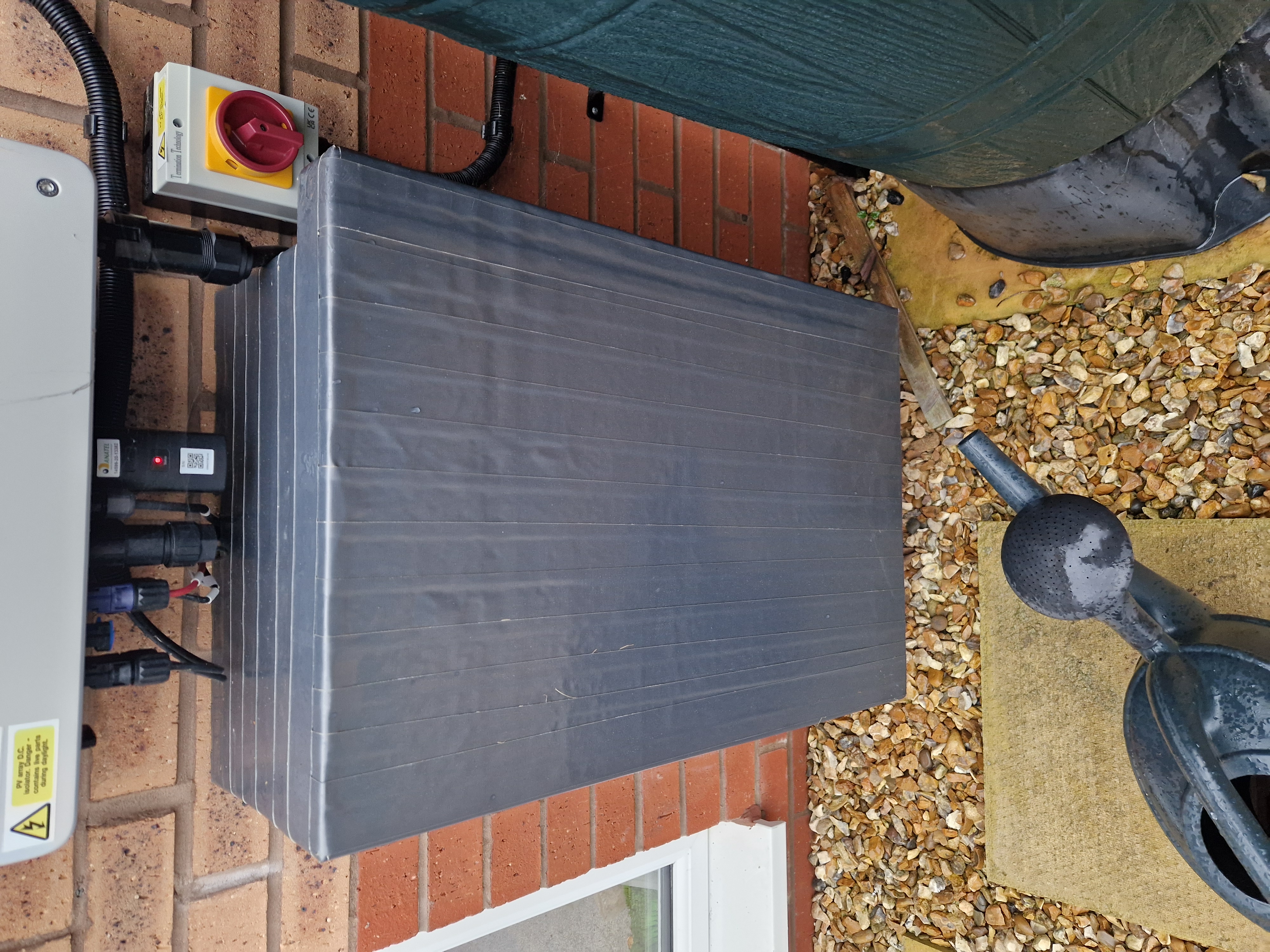

I haven't built it yet, but the plan is to build the box, and cover it with the weatherproof tape mentioned earlier by Dave. The tape is thick and waterproof. I have the insulation board in front of me waiting for it to be cut to size, and while it is relatively sturdy, it's a soft foam that bits flaked off just from moving it off the truck into the house, so it'll need covering.

May I ask what insulation board did you go for? For the moment, I ordered a big heavy duty 0.3mm thick tarpaulin to wrap them up when the weather gets ugly and cold, but I might add some insulation to either the tarpaulin itself or enclose the batteries with the board as needed. Thanks!March wrote: ↑Wed Jun 11, 2025 3:11 pm I haven't built it yet, but the plan is to build the box, and cover it with the weatherproof tape mentioned earlier by Dave. The tape is thick and waterproof. I have the insulation board in front of me waiting for it to be cut to size, and while it is relatively sturdy, it's a soft foam that bits flaked off just from moving it off the truck into the house, so it'll need covering.
I've got the 50mm Kingspan. Will have to see how it goes in the winter

Did you insulate the battery in the end? Any improvements? And any pictures? This is my first time with the battery near 0C and I see a low continuous charge at 1kW since 21.
Planning to cover them before the next sub zero temperatures.
