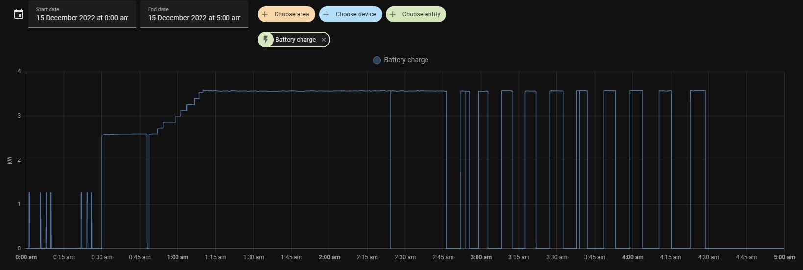

These seem to happen more commonly when the battery enters a “force charge” period (usually overnight for most with off-peak tariffs) and there seems to be a varying degree of results in terms of the alarms that occur and when.
I suffered with this for a couple of weeks and my issues varied from an alarm at the beginning of a charge period and never recovering (zero charge!), to a seemingly random alternating alarm every 5/10 mins but still managed to charge to roughly 60%(less annoying, but still annoying!) – examples of problematic charging profiles and the fixed one below.
Examples of problematic charging profiles.

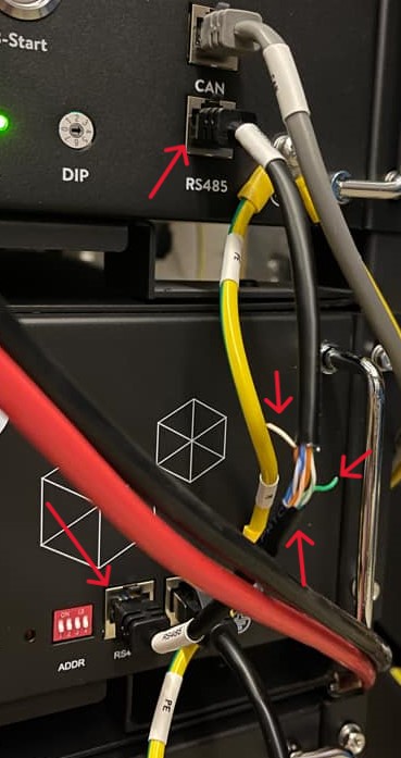

See the image below for how this should look when finished.

Connect this modified ethernet cable to the RS485 port of the V2 BMS and to the RS485-1 port on the first battery in the series.
It has also been reported that connecting the modified cable between the COM port on the BMS and the BMS port on inverter also works - so take your pick!
It should be said though that, in my opinion, it is probably easier to connect the BMS to the first battery as this doesn't involve trying to fumble about under the inverter!
Please note: It’s not clear if this is important but it’s probably best that the V2 battery(ies) are first in the series.

The end result will look like this:
