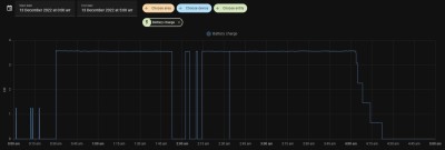

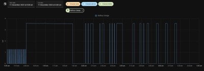

There are initial signs that the so called ‘reverse compatibility’ has not gone smoothly. The mixture of V1 and V2 batteries along with the V2 BMS has resulted in a number of unwanted BMS & Battery Voltage alarms which interrupt the force charging of the batteries. Mainly the “BMS Hardware Protect” (211) and “Bat Voltage Low” (198) errors.
These seem to happen more commonly when the battery enters a “force charge” period (usually overnight for most with off-peak tariffs) and there seems to be a varying degree of results in terms of the alarms that occur and when.
I suffered with this for a couple of weeks and my issues varied from an alarm at the beginning of a charge period and never recovering (zero charge!), to a seemingly random alternating alarm every 5/10 mins but still managed to charge to roughly 60%(less annoying, but still annoying!) – examples of problematic charging profiles and the fixed one below.
Examples of problematic charging profiles.
How the charging profile should look (aside from a random point.. who knows what that was).

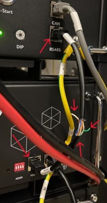

See the image below for how this should look when finished.
Before beginning, shut down the system by firstly throwing the breaker on the BMS and turning the AC/EPS isolators to off. Lastly, turn the DC isolator off on the inverter itself. The screen will go blank and the lights on the BMS will all be off.
Step 1:
Peel/cut away about an inch of the sheathing of the spare ethernet cable – DO NOT CUT THE WIRES.
Step 2:

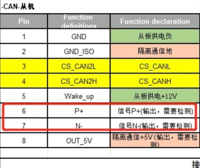

Of the 8 strands of wire inside the ethernet cable, identify 2 out of the 8 wires to cut - the solid green wire and white/brown striped wire.
It's not clear what these wires (number 6 & 7) do, or why they cause an issue - I'm sure this will become known in time but for now - it just works!
Step 3:
Isolate those wires and cut them carefully so as not to damage the others – you should have 6 wires inside the ethernet cable intact.
It would be best practice at this point to wrap a length of insulating tape around the exposed wires or any other fancy technique you may have up your sleeve!
Step 4:
Connect this modified ethernet cable to the RS485 port of the V2 BMS and to the RS485-1 port on the first battery in the series.
It has also been reported that connecting the modified cable between the COM port on the BMS and the BMS port on inverter also works - so take your pick!
It should be said though that, in my opinion, it is probably easier to connect the BMS to the first battery as this doesn't involve trying to fumble about under the inverter!
Please note: It’s not clear if this is important but it’s probably best that the V2 battery(ies) are first in the series.
Step 5:
When done, start up the inverter in the reverse order to that at the beginning of these steps.
The end result will look like this:
If successful, and it certainly has been for me and two others on this forum that I know of so far, you should no longer experience any of the alarms described here and you can breathe a sigh of relief!

Thanks for posting this. I have now got a V2 BMS, some V2 and V1 batteries. I'm seeing exactly these faults/errors, i.e.:
The manual screenshot you'd put in (google) translates as:
Negative power supply from the board
Isolated communications ground
CS CANL
CS CANH
Power Supply +12v from the board
Signal P+ (Output, needs detection)
Signal N- (Output, need to detect)
Isolated Communication +5V (output, need to detect)
- Communication Fault Between battery and Device

It’s a a good question and I’m not sure if you’ve had an answer already.
I believe the pins are the same in most if not all Ethernet cables. I have opened one up and found that rather than being a striped colour, it’s just white and bound to the corresponding solid colour.
I’m no expert in these cables…

I'd like to add another successful (and very grateful!) +1 to modifying the supplied RS485 cable solution!
I'd installed the BMS V2 with 2x new V2 batteries in front of the 2x Version C I had previously.
For 3 nights I saw forced charging working fine with no errors, then errors started before the next charge, 194 Battery over voltage ↑
194 Battery over voltage ↓ 211 Bms Hardware Protect ↑ 211 Bms Hardware Protect ↓ as others here seen.
I was reluctant at first to break into one of the cables supplied with the BMS/Batteries so made a patch cable with CAT5e/RG45 plugs with the 6 green/7 brown & white wires cut.. but then on powering up the BMS there was an audible alarm and flashing red LEDs.
Other than lots more shielding and maybe heavier gauge wires I can't see a difference, but modifying the supplied cable then worked fine, I've seen no more errors and now charging again over the last 2 nights.
My firmware versions (before and after) also:
Master 1.54, Slave 1.02, Manager 1.57
