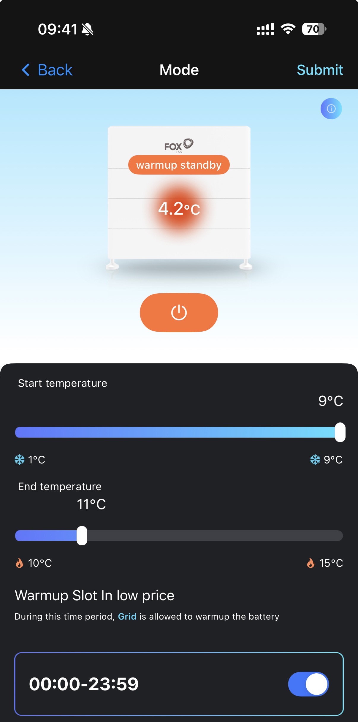

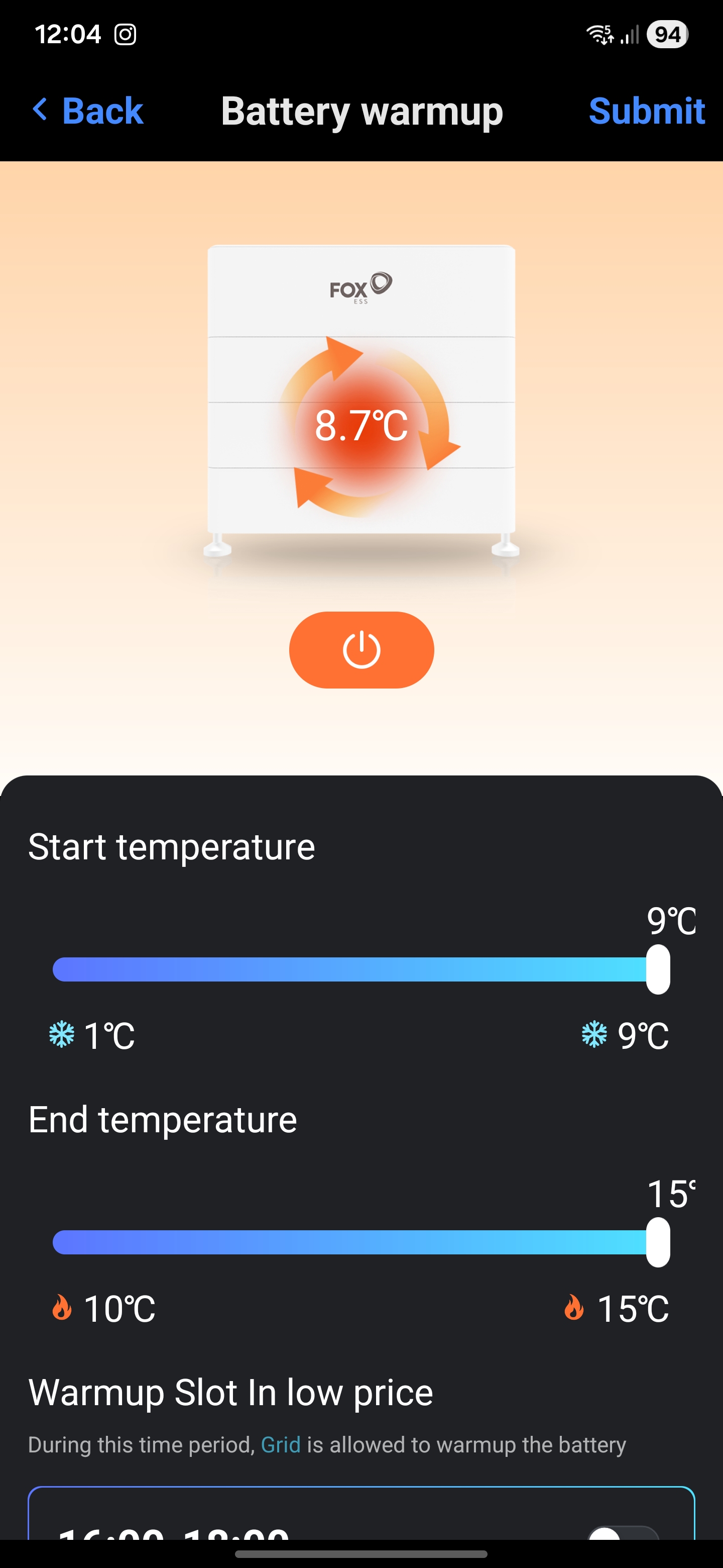

Mine is refusing to even try to heat this morning. Heater on, allowed on grid all day but heating on standby rather than on.
I’m on version 1.009 and not convinced the heating has ever worked. Having it on will sometimes cause overcurrent faults as well which takes the inverter offline entirely. Maybe I have a faulty unit?
Re: EP11 with heater
hamgeezer wrote: ↑Wed Dec 31, 2025 9:44 am Mine is refusing to even try to heat this morning. Heater on, allowed on grid all day but heating on standby rather than on.
That certainly looks correct, though I would extend the heater higher than 11C.
I would contact Fox Support and get them to investigate, as the heater unit is not high power and shouldn't be taking your system offline.
Ask for firmware update from 1.009 as it was reported above that it may have been pulled due to bugs, and ask about your inverter getting upgrade at same time.

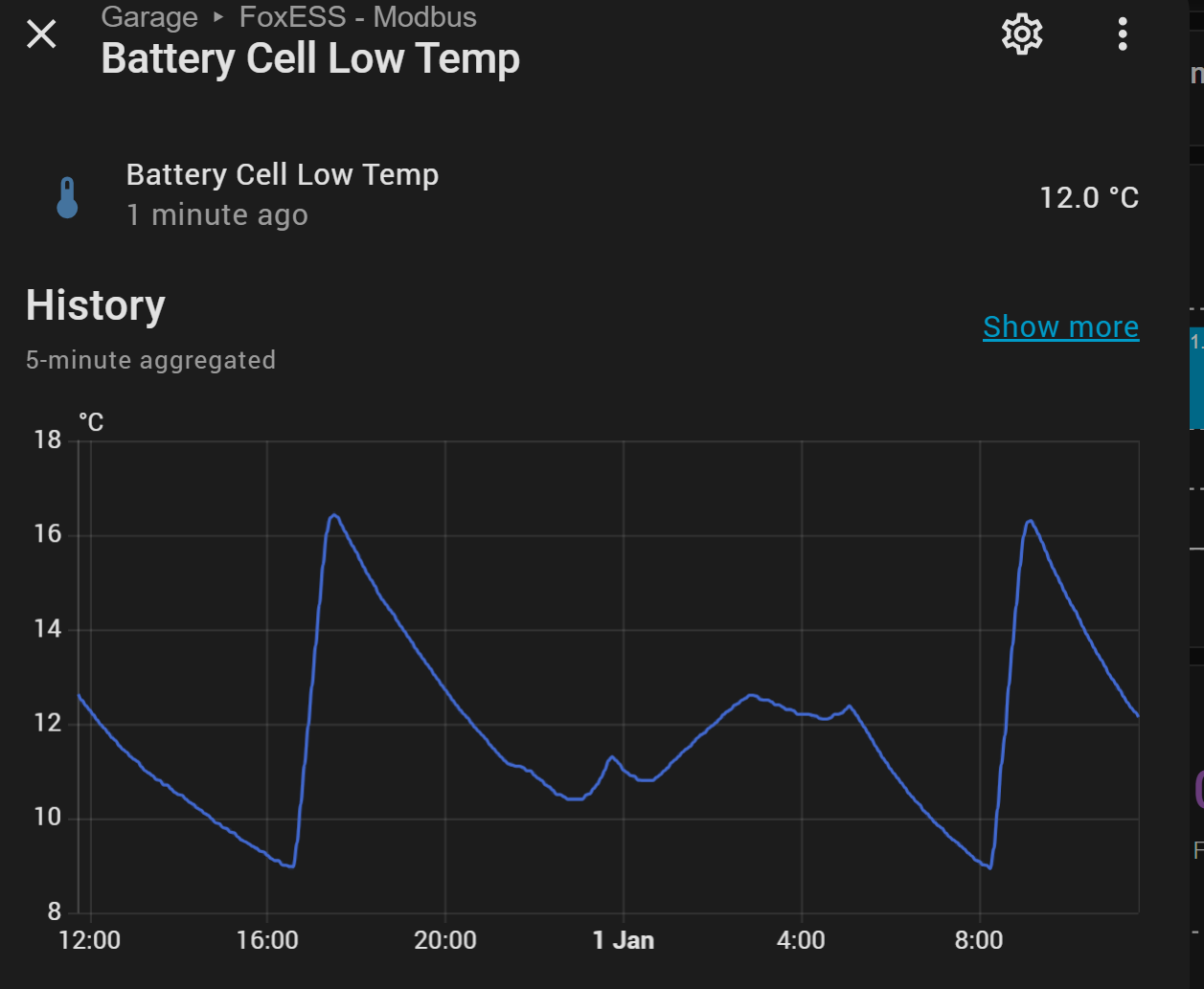

My 2 EP11Hs are working well with BMS 1.009. The battery heaters trigger on at 9C and off at 15C (typically over-shoots to 16C). I'm not going to upgrade my FW until the spring unless I get major issues before then. Attached image from Modbus lowest battery cell temperature sensor in Home Assistant.
iew100 wrote: ↑Thu Jan 01, 2026 11:46 am My 2 EP11Hs are working well with BMS 1.009. The battery heaters trigger on at 9C and off at 15C (typically over-shoots to 16C). I'm not going to upgrade my FW until the spring unless I get major issues before then. Attached image from Modbus lowest battery cell temperature sensor in Home Assistant.

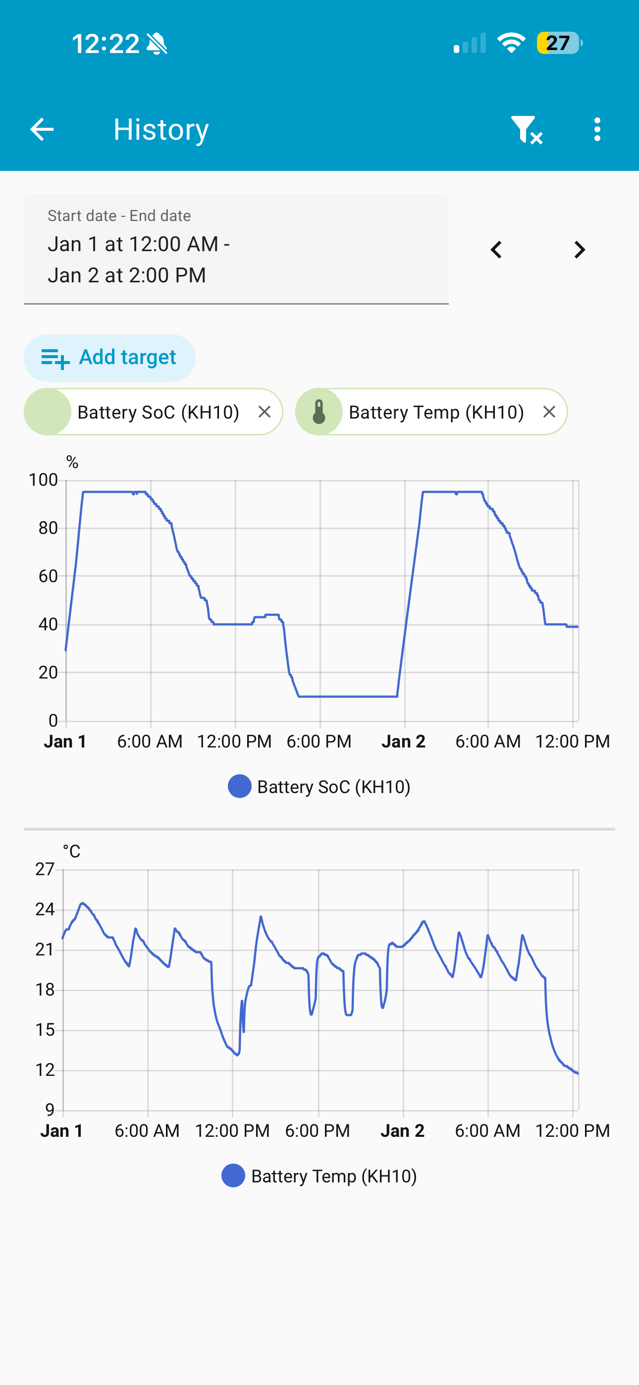

Also with the 1.009 FW version, and my chart looks just the same as yours. I am also going to leave the FW version alone for now, if it is working I am leaving it as is for time being.
I also noted that the battery which normally charges at 23:30 didn't as the battery heater kicked in at this time.
After approx 30mins of heating time, it reached about 10C and then it began to charge from the grid, whilst still heating.

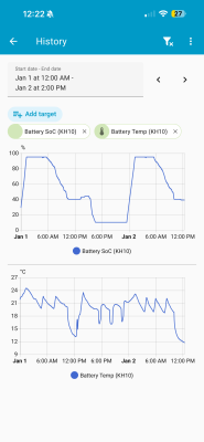

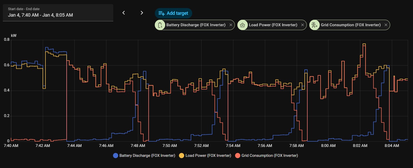

I am still having the same problem, with when heater is active, the battery keep stopping to deliver charge to cover house load, and imports from the grid. I have raised this with Fox already ..but I just do not seem to be getting a response
Battery is still on 1.09
I have sent them the graphs below, to show the drop
albie999 wrote: ↑Mon Jan 05, 2026 8:00 am I am still having the same problem, with when heater is active, the battery keep stopping to deliver charge to cover house load, and imports from the grid. I have raised this with Fox already ..but I just do not seem to be getting a response
When this happens what is the SOC of the battery, what is the temperature of the battery, what is you minimum SOC set to, do you have the heated version of the battery and do you have heating turned on, what mode do you have the inverter set to?
Things that might stop battery use include the minimum SOC, the temperature, the mode

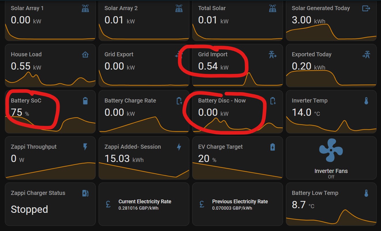

This is an ongoing issue, that I have posted in this thread previously .. and which "Fox" said they had resolved .. but definitely not. Please see below screenshot, showing battery charge is way above the minimum ... also .... my battery is set to heat at 9c ... and it is when this battery warming kicks in .... that this issue happens

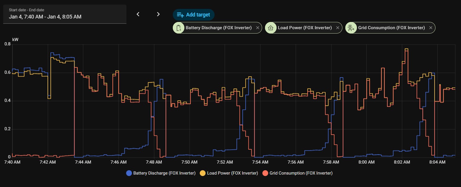

I am on 1.009, I was going to await a future date and upgrade the battery FW, but today I have asked for the latest.
I have my battery set to charge each night 23:30-05:29 via Home Assistant, working fine. What I observed at 23:30 is the heater kicks in (heater grid charge is set to same as above times only) and the battery didn't take any charge (around 8C) then at 10C it began to charge from the grid. I have not looked at discharge when the heater kicks in, but perhaps I do need to look at the logs.
I asked for a FW upgrade, because this morning after 09:xx it began a heating cycle... now issue was it was using grid power despite a 97% SoC, I was thinking it should use self-power above 55% SoC (or some such value) but clearly wasn't.
