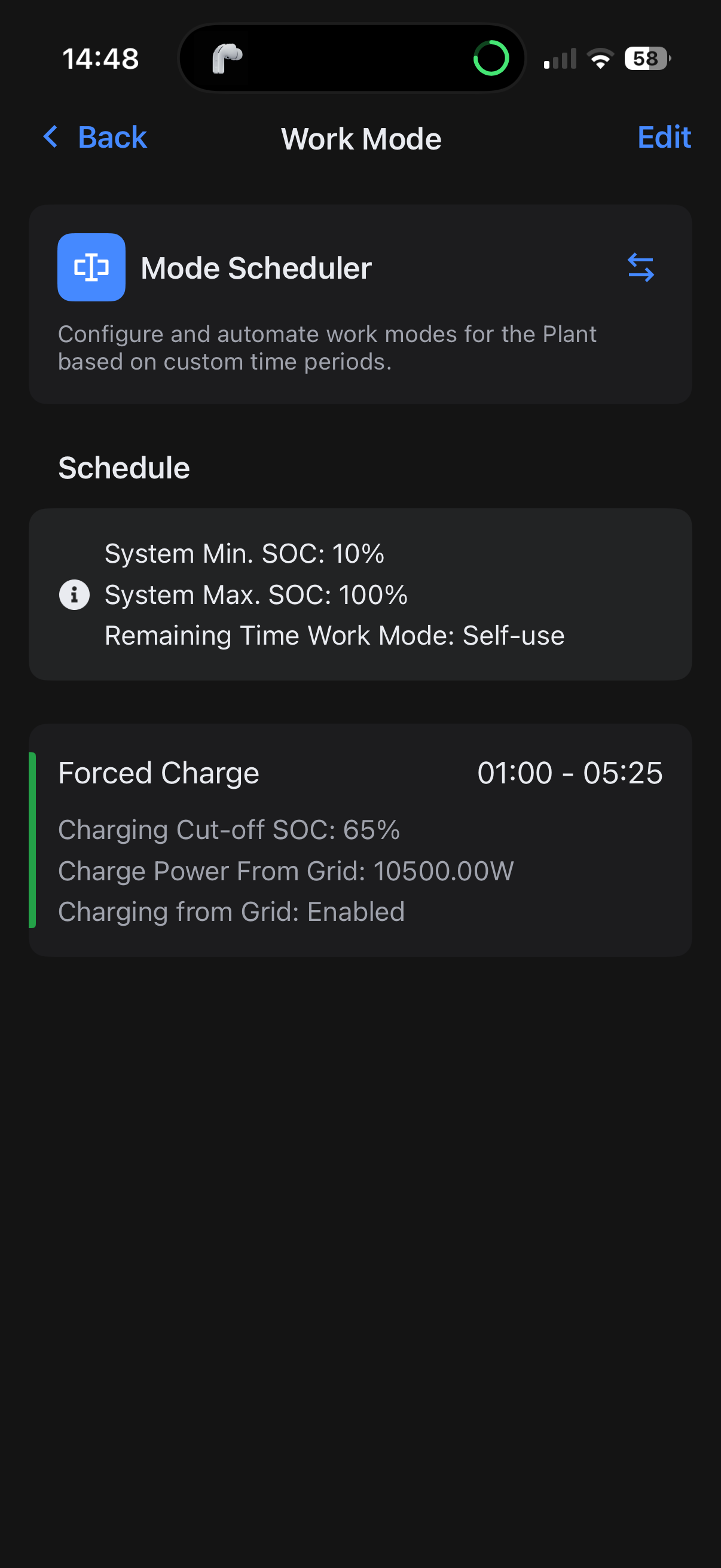

Sorry do you mean change under work mode. It’s currently on mode scheduler

rolotwix12 wrote: Wed Mar 04, 2026 2:49 pm Sorry do you mean change under work mode. It’s currently on mode scheduler
Hi Rolotwix,
I'm a little confused, the earlier attachment showed you were in quick settings trying to adjust your System Max SOC
But the latest attachment shows you back in work mode.
If you want to change the system max soc you need to be in quick settings.
But as Barracuda mentioned some people have issues
