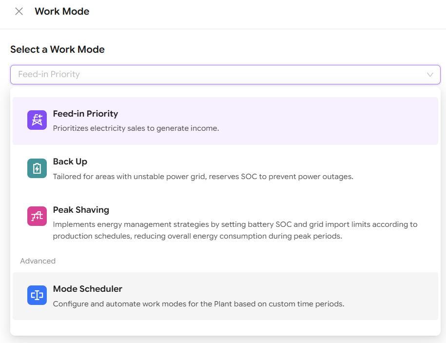

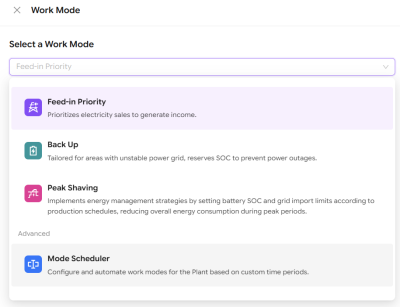

Sorry do you mean change under work mode. It’s currently on mode scheduler

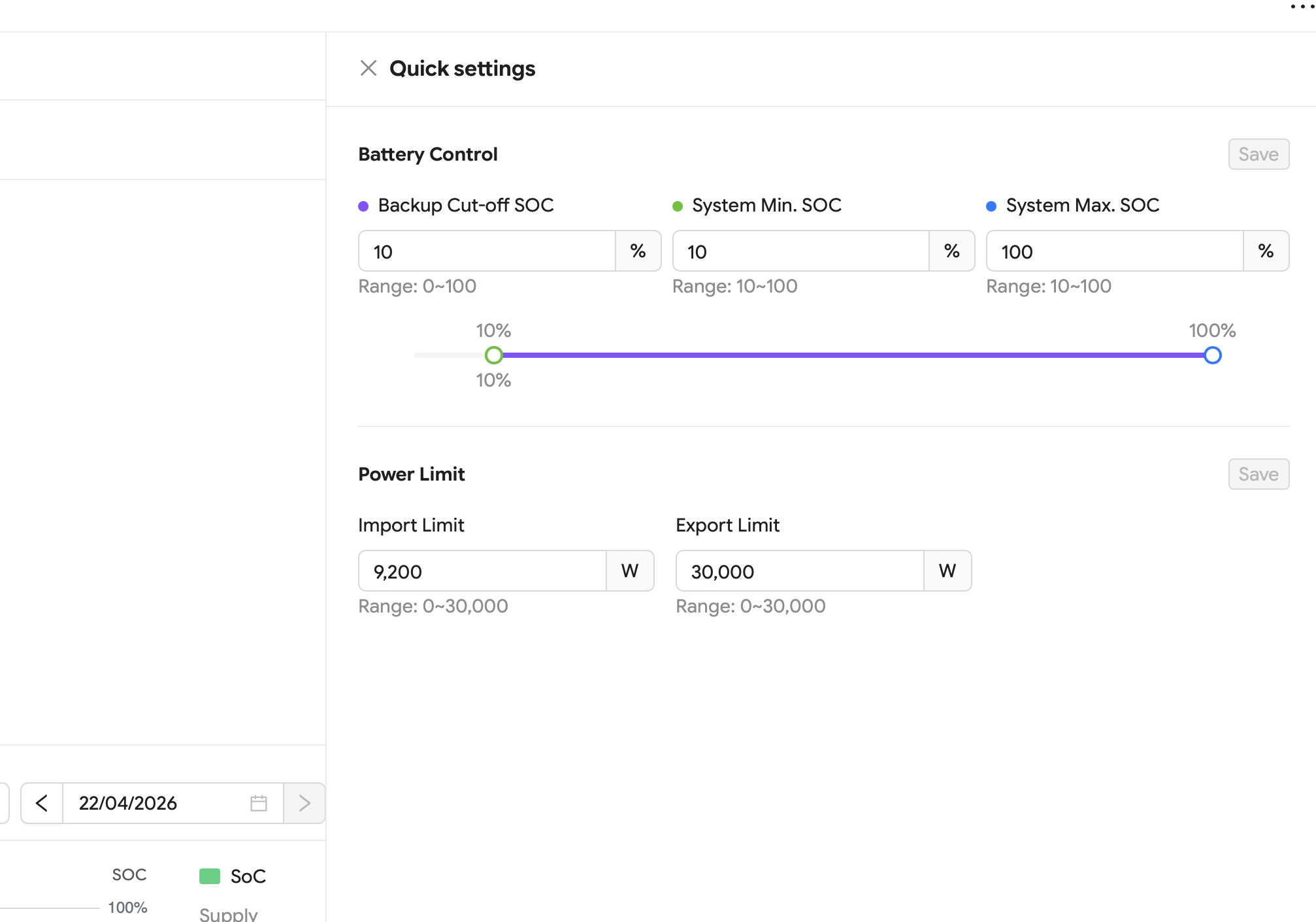

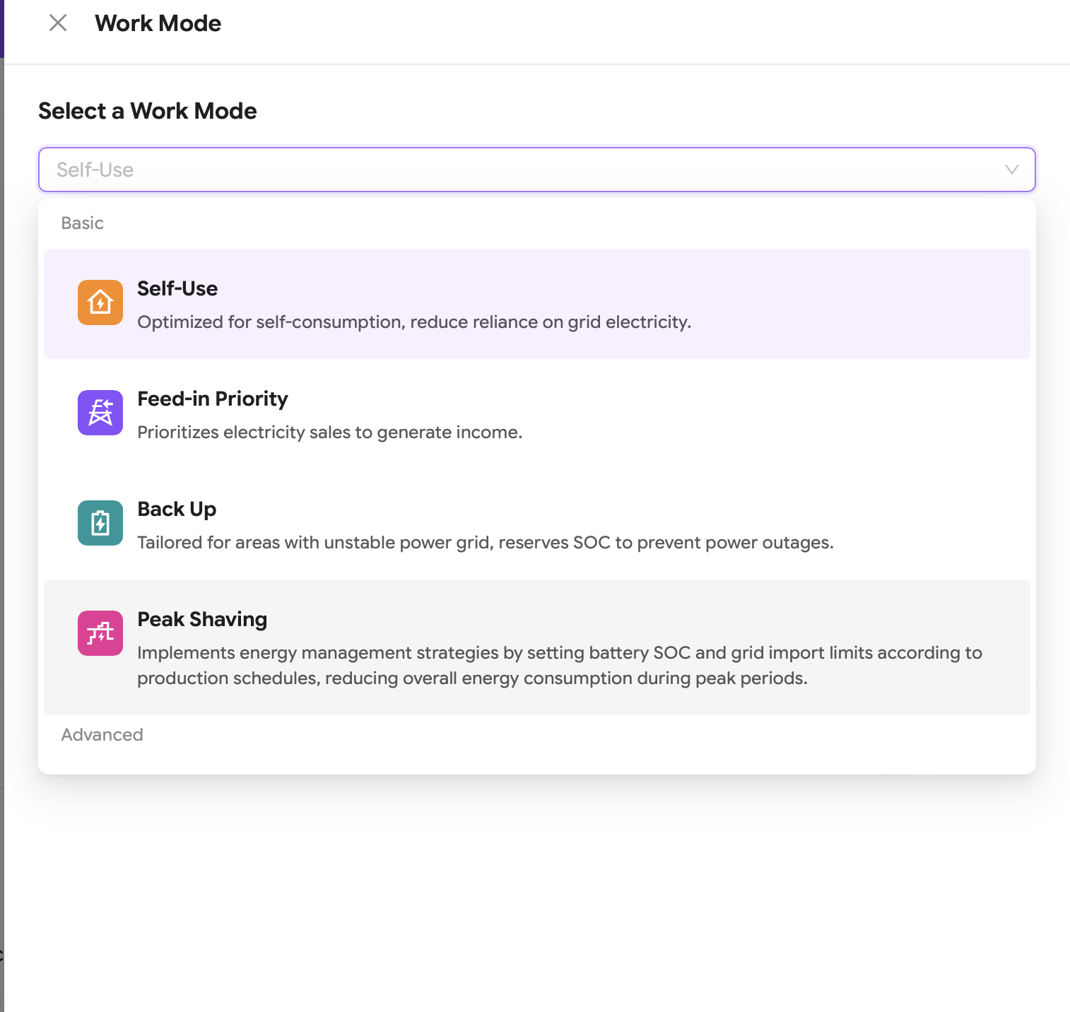

Hi Rolotwix,
I'm a little confused, the earlier attachment showed you were in quick settings trying to adjust your System Max SOC
But the latest attachment shows you back in work mode.
If you want to change the system max soc you need to be in quick settings.
But as Barracuda mentioned some people have issues

Okay, so we all seem to agree that the battery charge scheduler on the app used to be simple, but has now gone. I tried to alter my charging through the desktop version vis the "quick settings" which now doesn't seem to have the screen I am looking for. Just get this instead, which has no option to change the charge (which i w at to switch off during the sunny weather). It's such a confusing site, made more complicated by having two versions available neither of which I can find what I want in them).
Re: Option to schedule charging disappeared
In addition to above, I read in the thread that its a good idea to set maximum charge at 90%. I do this but get a message when I save that it won't do this, tried altering the minimum and it does that. There are so many problems with the one thing I have ever tried to do on this system. Anyone got any suggestions?

They have changed the v2 website now to look like the App.
On the right side of the page, just under your plant name, there is 'Work Mode' and you can press the 'Details' button to get to the 'Mode Scheduler' under 'Advanced'.
Click on the drop down box, and scroll down until you see this
Thnaks, getting closer but Advanced is greyed out, this is what I see.
