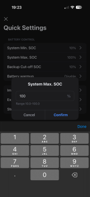

rolotwix12 wrote: Wed Mar 04, 2026 10:28 am Thanks. How do I set that, I have tried to set it under quick settings, which has the option to set max at 90%, but when I did that and saved. The save failed.
Open up Fox Cloud 2 app,
Tap plant
Tap Quick Settings
Tap System Max Soc this opens abox
Change the figure to your requirements
Tap confirm
It should come up "successfull" at the bottom of your page.
Sorry I tried to attach screenshot but couldn't
Re: Option to schedule charging disappeared
Thanks I tried that but it comes up as failed.

rolotwix12 wrote: Wed Mar 04, 2026 2:39 pm Thanks I tried that but it comes up as failed.
Change the mode from schedule to something else first.

Sadly Alan, the value cannot be adjust whilst you have a schedule setup.
It is a common error, that works once you have turned scheduling off, then it accepts the value.
It does not help Fox has stupid error codes that mean nothing to end users. They could take the error code and say "please turn off any active scheduling and try again"

rolotwix12 wrote: Wed Mar 04, 2026 2:39 pm Hi
Did you tap on 100 to change it to your required figure and then confirm?
