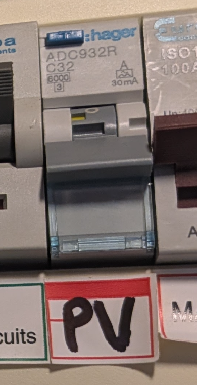

Is it a 32A MCB or RCBO one is simply a circuit breaker (and unlikely to trip unless faulty), the other will trip if it detects too high a leakage current.
If it is an RCBO it will likely be rated a 32A and RCD at 30ma - this can cause trouble, the reasons are complex but humidity is a part of it and that would be high at 1am - Fox recommend that and RCD (RCBO) should be rated at 100mA.
Re: Fox ESS Error Code-1 No Utility, Error Code-26 Grid Voltage Fault, Error Code-27 Grid Frequency
Dave Foster wrote: ↑Thu May 15, 2025 8:46 am
pm wrote: ↑Thu May 15, 2025 4:06 am We've had this trip three or four times in the last few months
Inverter is inverter H1-6.0-E and the Trip is 32A
When reset, the system works normally again.
In at least two of these cases, the first error seems to have been logged at around 01:00. We don't charge the battery from the grid.
Any thoughts?

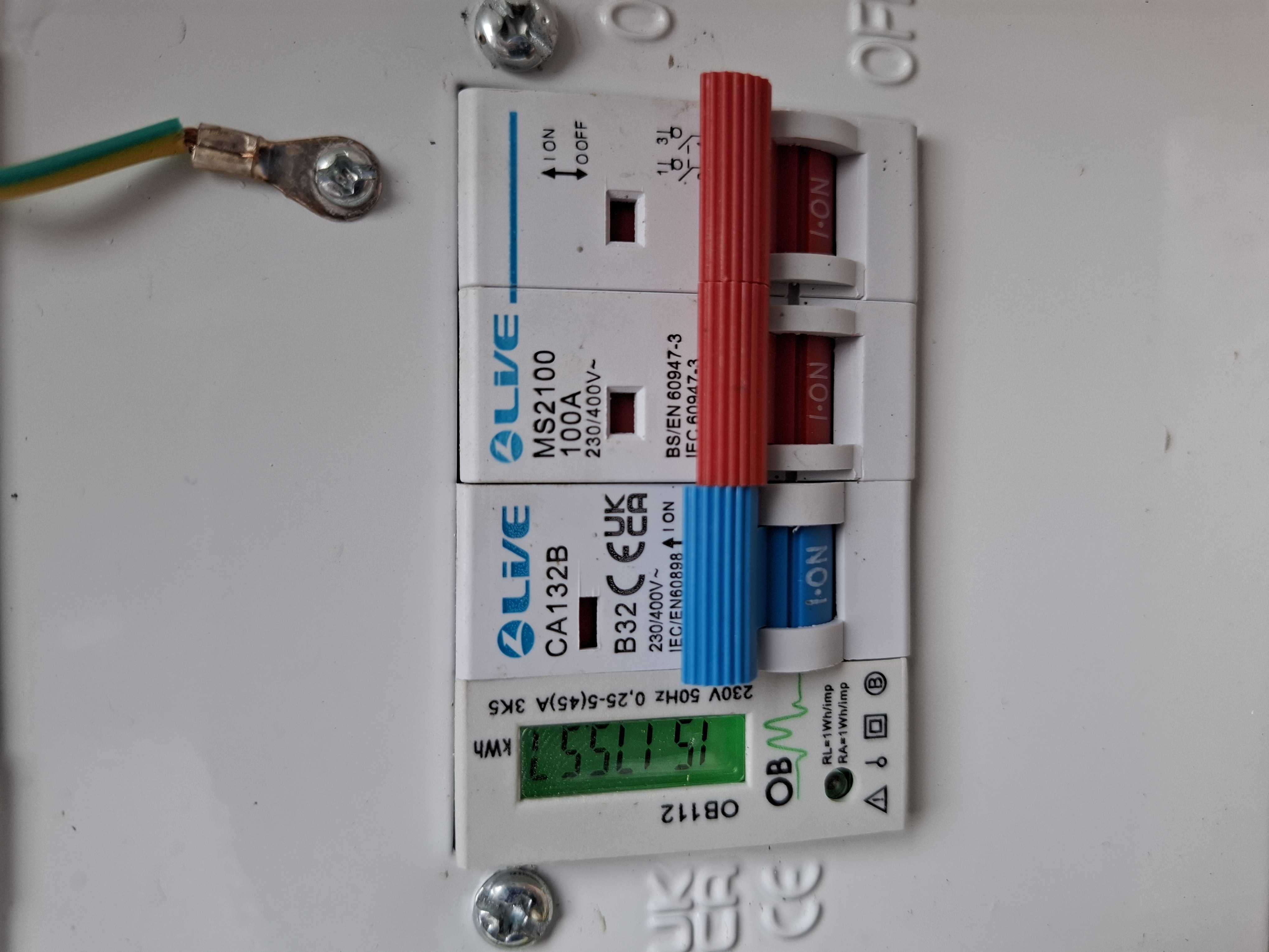

Here is the box (sorry, not an expert at all)

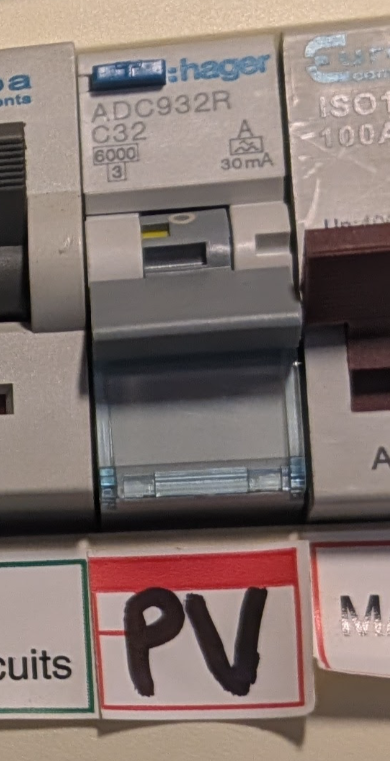

I had this happen to me do the first time a few weeks ago when the weather was bad. So started to look into this and noted that my installation has a 32A type B breaker.
I also noted that when the breaker went, the house lights etc were fine which leads me to think that the MCB may have been the culprit. So looking into it further I have read that a Type C breaker should have been installed as it has slightly looser tolerances but still within Fox recommendations.
Does any body else have any steer on this? Is replacing with a type C breaker likely to work?

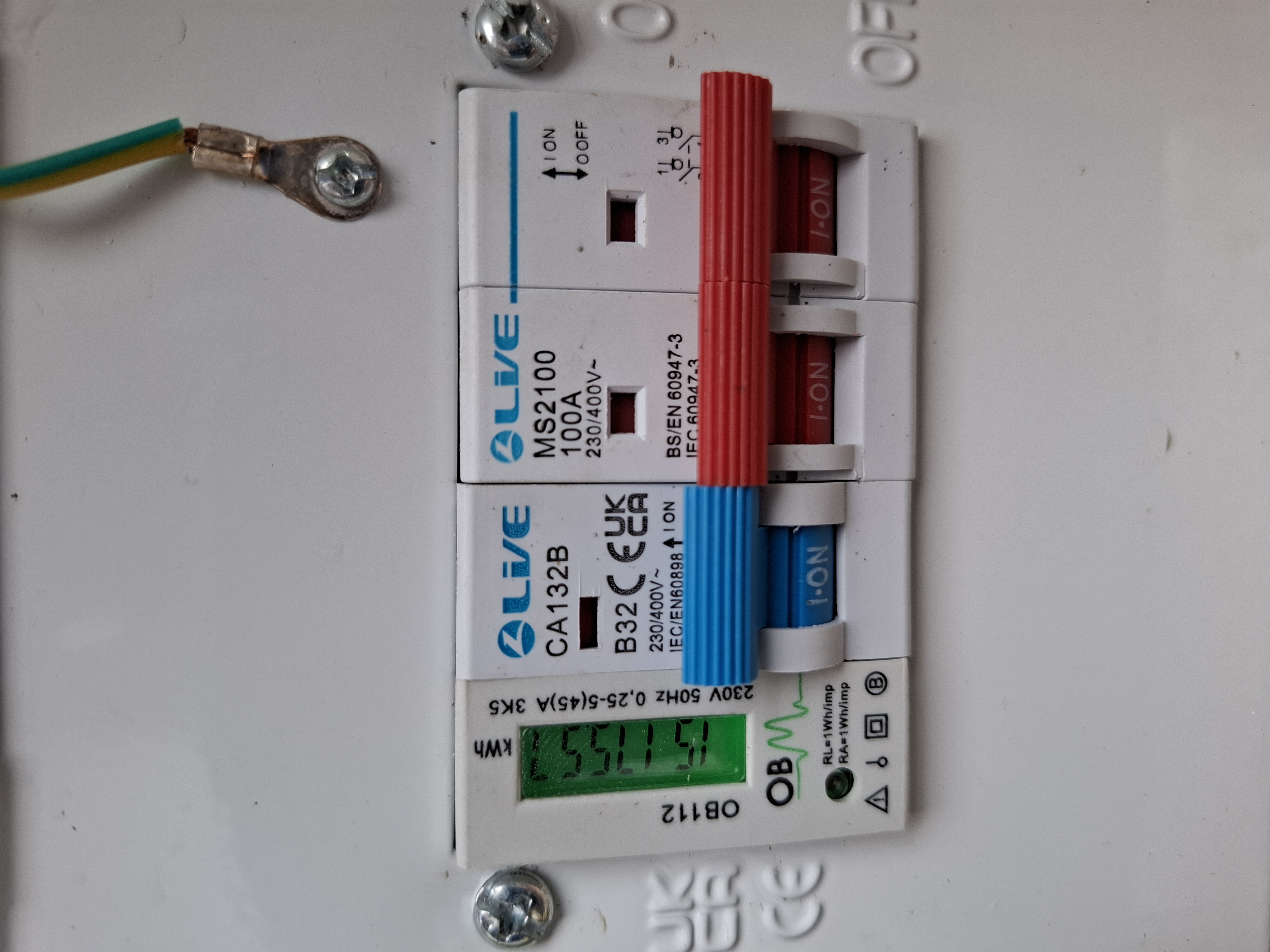

Hi All,
I am suffering from the same three fault codes. The mains breaker had tripped. I reset that and rebooted the inverter as per the instructions (twice).
The breaker remains made (ie it hasn't tripped again) but I'm still getting the error messages and there's no sign that the inverter can detect mains supply or the house load.
The battery is fully charged but the inverter isn't using it to service the house load.
When the sun is shining the solar panels are still supplying the house and returning electricity to the grid where PV production exceeds the house load (I can see this on my smart meter).
I have raised a ticket with Fox, but an ideas in the meantime would be very welcome.
Thanks in advance
Steve
There's definitely something wrong with the grid side of the inverter, those 3 errors come together when the grid connection is missing.
It's possible you have a wiring fault or a bad breaker (try opening and closing it again), sometimes there is an AC rotarty isolator switch fitted between the breaker and the inverter - check that as well.
If you cannot find an obvious fault, you need to contact your installer or an electrician as it is likely the breaker is faulty or there is a wiring fault between there and the inverters AC connector on the lower far right hand side of the inverter.

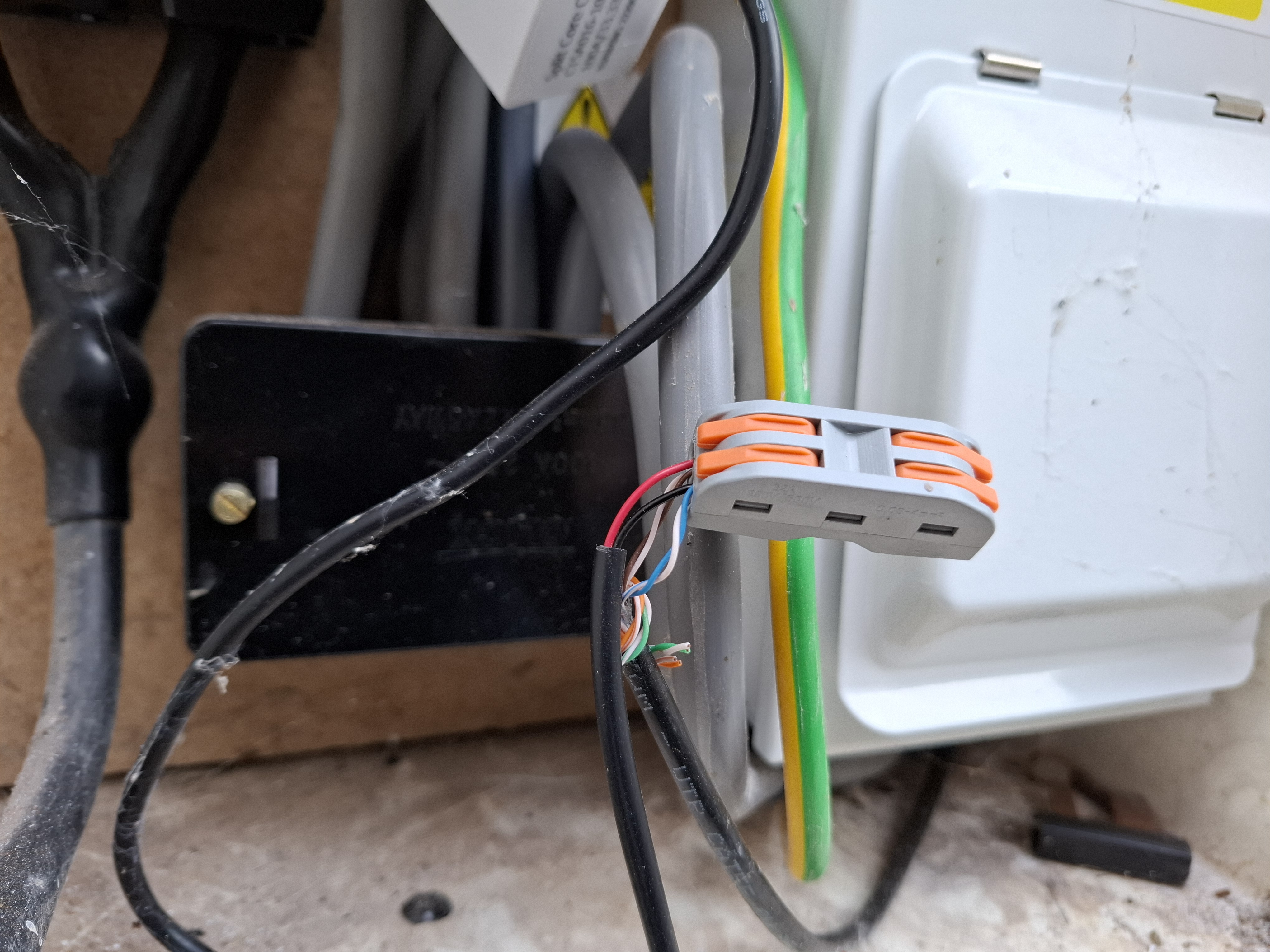

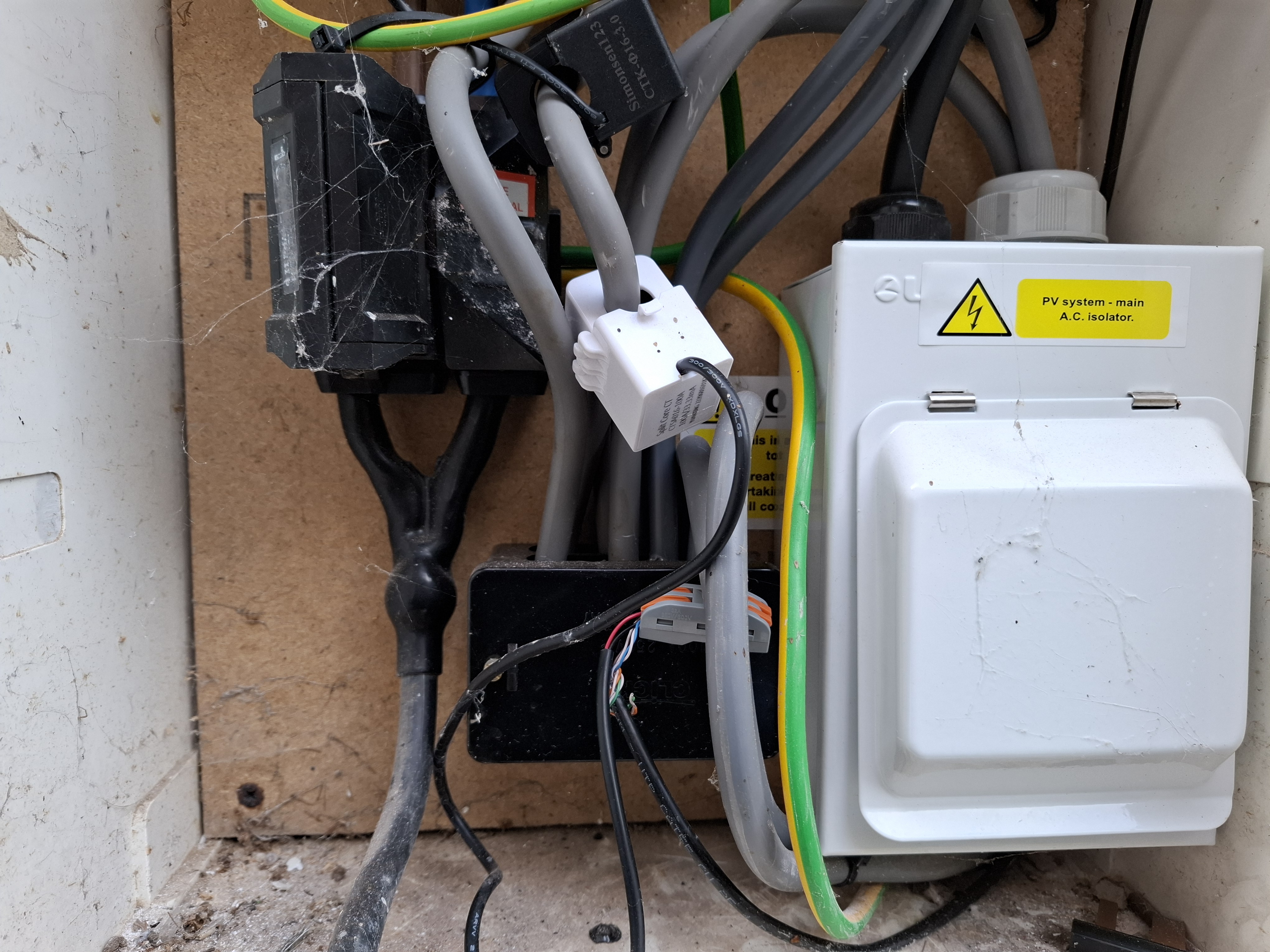

The weird thing is though - when I first tried to reset the inverter, it wouldn't start up again until I found the tripped breaker and remade it. Once I had done this it flashed back up and indicated normal function, but wasn't detecting the mains supply or domestic load.
So, there is obviously some connection to the mains supply through the breaker. Nonetheless, I have reset the breakers again.
There also seems to be a signal line that goes up with the power cables connected to this toroidal ring sensor (see picture) I gave the little connector block a wiggle to see if that made a difference. It still doesn't seem to be sensing any supply from the grid.
If it showed ‘Normal’ that means it has found grid supply to be present and is operational ‘normally’ - the errors will stay showing for a while but are time stamped so may be old errors.
If the inverter has started up ok and is showing ‘normal’ you are back on-line but i’m wondering if your batteries are off-line in which case you need to shut down the whole system including the batteries and the restart by powering the batteries on first.
The small toroidal device you mention is the inverters CT clamp and that measures the power flow at the meter, it is an essential piece of equipment without that being connected properly the inverter cannot work out how much load is present and so the batteries won’t be used.
Thanks Dave - now, this is intriguing.
Each time I previously powered down the system and brought it back up, I did as you suggested. Isolate DC > Isolate AC > turn off battery. Wait a bit, and then power-up in reverse order ie battery first, AC, then DC.
The inverter said that operation was normal but it wasn't detecting (or showing) flow to/from mains grid. What it was showing as 'load', included power going back to the grid (ie excess solar) but it didn't show that as export.
Perplexing. Could it be a sensor or sensor connection error? :?
StevePre wrote: ↑Sat Oct 25, 2025 3:58 pm Thanks Dave - now, this is intriguing.
It sounds like your CT clamp has a connection problem - that wago connector in the photo was not designed to splice such thin wire - try re-making that.
Also check that the inverter thinks there is a CT clamp installed from the panel go to Settings, password (enter 4 times for 0000), Feature, Meter/CT, Set - it should say >CT< if it doesn’t use the arrow keys to select >CT< then press set. If it does say CT just exit the menu by pressing the far right button.
