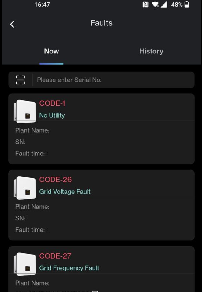

Error Code:
Error Code-1 No Utility
Error Code-26 Grid Voltage Fault
Error Code-27 Grid Frequency
I'm making this post to help other owners searching for this error message understand the problem and how to resolve it.
Issue:
These three errors above normally appear together because the grid power connection to the inverter has been isolated. I.e No power to the inverter.
Solution:
This is normally because your circuit breaker has normally tripped to an off state. Locate your circuit breaker or trip switches and try to reset it to restore power.
Circuit breakers should not trip, there is normally a problem or fault or the more commonly, the circuit breaker itself is undersized and tripping during high load situations like force charging.

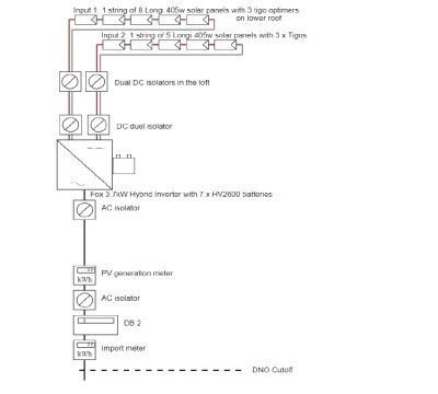

I have a recently installed 3.6k FoxH1 inverter, 11 440w CS panels and a Fox ESS 5kw battery with a B20 breaker.
This has happened once before, not during a charge event
Any thoughts?

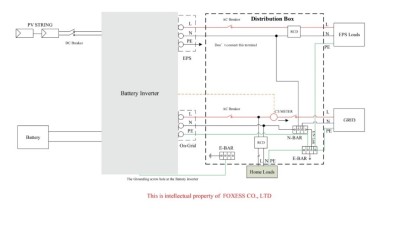

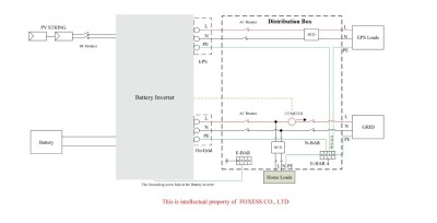

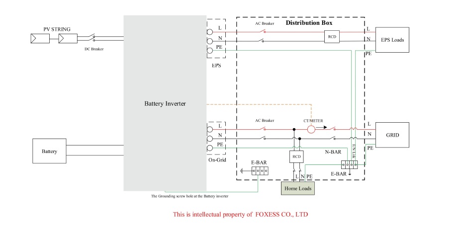

So, does anyone have a diagram for the general installation of a AC1-5.0-E, showing where the MCB and RCD sit in the connections to the grid?
Graham

I have an older issue of that manual, but I couldn't find any ref to the MCB and where it's connected in. Then it dawned on me to look for the RCD to see if I can infer the MCB's location from that. So the diagrams on page 30/31 in my copy (35/36 in the one you linked to), which I've included - hopefully without infringing any rights -, shows a switch or switches on the home loads side of the RCD, and I think that must be the MCB. In which case, the MCB would only carry current in one direction, either from inverter or grid, which ever is winning, and is fully isolated by the RCD.
Except they can't be right, because if they were right, then tripping the RCD would bring the house down, and it don't (doesn't even get a chuckle). So I remain most uncertain about where the RCD and MCB fit in the system, somewhere between the inverter, meter, and home fusebox.
I think they might be on the inverter side of the three-way junction with the smart meter and the home fusebox, and do pass current in either direction. So, when the RCD or MCB trip, the home loads stay connected to the grid through the meter, but no power can pass to or from the inverter. But, maybe, if the RCD is nearer the meter than the MCB, the MCB is isolated from the grid by the RCD. And, if the inverter cuts output when it can't see the mains, the MCB is then isolated on that side too. But I would very much like that confirmed before I even take the cover off to measure if there are any volts on it to speak of.

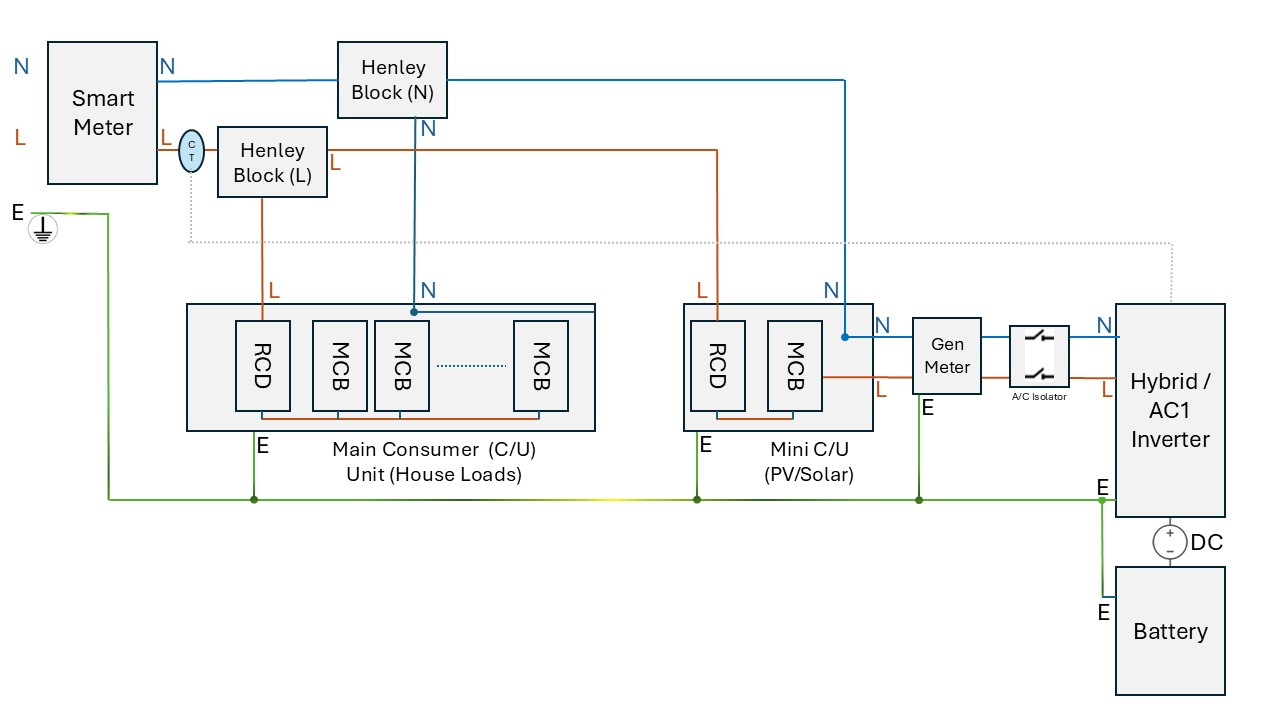

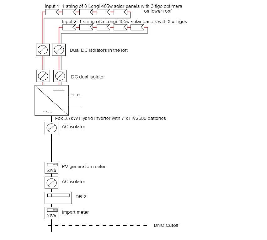

Sadly you can't rely on the manual schematics for your installation as each installer will very likely do things differently depending on your current home wiring and the type of install, the manual really lists the mandatory requirements that have to be met by the installer where the main pre-requisites are around conductor dimensions and it should be fed from an RCD 100mA and an MCB that are rated to handle the inverters current.
I've seen inverters wired off a breaker in a consumer unit (not recommended and dangerous in my view) but the most common is what I think you are describing.
The installer fits a Henley block just after the smart meter and this feeds the main consumer unit (all house loads) and is connected to a separate db (mini consumer unit usually marked PV or solar) which contains both the RCD and the MCB. This then feeds into a generation meter (OB112 in your case) which is an old legacy requirement of FiT installs, often into an AC isolator so the inverter can be easily isolated and then into the inverters AC connector.
I've attached a very simple schematic of what a common install might look like, but you'll have to do your own investigations to confirm.
Based on what does and doesn't happen when the MCB (and or the RCD) trips, I'm pretty close to certain that diagram shows where the PV MCB and RCD connect in my system.
The only question that I don't think there's evidence to answer, is about the relative positions of the RCD and MCB. If they are as shown, with the RCD on the grid side of the MCB and assuming the inverter shuts off its output when there's no grid connection through the MCB, then with the RCD tripped, the MCB will be fully isolated. But if they are the other way around, and the RCD is on the inverter side of the MCB, then the MCB will be live, even when the RCD is tripped. I can't see anyway to test that, other than to carefully take the PV unit cover off, and check with a meter. I may be being overcautious about swapping the MCB if it's live. But I think I'd rather not try that.
I have to say, that wiring the system with the PV MCB on the meter side of the RCD makes no sense to me. But just because it makes no sense doesn't make it impossible.
To be honest, the arrangement shown it the diagrams in the user manual makes no sense to me either. But maybe I'm missing something, and the RCD it shows is that in the consumer unit, and the RCD/MCB for the inverter are somewhere else.
Out of interest, what's the danger in wiring the inverter off the consumer unit, other than it then don't have its own, separate RCD?

It’s quite common particularly with larger RCD’s to have that as the main dual pole isolator, then you have the cheaper MCB’s downstream - it’s more cost effective if you have multiple MCB’s. There are also installs with a large dual pole isolator MCB feeding individual RCBO’s which works well giving you finer control where you have multiple large element appliances kettles, washing machines, EV charger etc.. they can easily overwhelm a single RCD isolator - so it will largely come down to cost and effectiveness what is chosen.
I’ve seen plenty wired off the consumer unit, I don’t like that you have the common live busbar at the bottom as you might reasonably expect when the MCB is open the outgoing feeds would be isolated but here you would have a live busbar at the bottom and a live feed at the top - I know you have to label as multiple sources but it just feels a potential risk.
But the main problem is if you have a main RCD isolator you would need to lift it to 100mA to meet the Fox requirements which means all the domestic circuits would then need 100mA to trip - not good.
You ‘could’ get round it by using a normal (non RCD) as the main isolator and have individual 30mA RCBO’s for each domestic circuit and a 100mA RCBO for the inverter but it’s expensive.
Issue:
Solution:

Hi, I have had this happen about 15 minutes ago. Ive looked at the breaker and it hasn't tripped. before I call the installer is there anything else?
All you can do is check all the circuits that feed the inverter, open and close any breakers in case it’s tripped but not dropped the lever - failing that if it doesn’t come back on it would be wise to leave the breaker feeding it open and call the installer.Wolfenden12 wrote: ↑Wed Jan 08, 2025 11:07 am Hi, I have had this happen about 15 minutes ago. Ive looked at the breaker and it hasn't tripped. before I call the installer is there anything else?![]()
