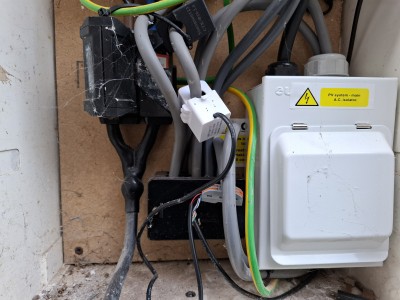

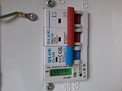

Here is the box (sorry, not an expert at all)Dave Foster wrote: ↑Thu May 15, 2025 8:46 amIs it a 32A MCB or RCBO one is simply a circuit breaker (and unlikely to trip unless faulty), the other will trip if it detects too high a leakage current.pm wrote: ↑Thu May 15, 2025 4:06 am We've had this trip three or four times in the last few months
Inverter is inverter H1-6.0-E and the Trip is 32A
When reset, the system works normally again.
In at least two of these cases, the first error seems to have been logged at around 01:00. We don't charge the battery from the grid.
Any thoughts?
If it is an RCBO it will likely be rated a 32A and RCD at 30ma - this can cause trouble, the reasons are complex but humidity is a part of it and that would be high at 1am - Fox recommend that and RCD (RCBO) should be rated at 100mA.
