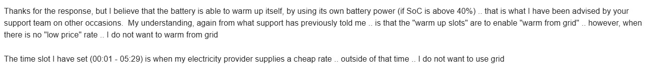

Honestly, I am going to lose it with Fox soon ... latest part of the saga below ..... is it me .. or are they just not understanding the problem at all
Re: EP11 with heater
albie999 wrote: Wed Jan 14, 2026 3:03 pm Honestly, I am going to lose it with Fox soon ... latest part of the saga below ..... is it me .. or are they just not understanding the problem at all
They are not testing things very well, as you answered above in my quirky test of setting end heater value lower than the start.
Self-use of the SoC when the battery is cold seems to not work, and something they are not getting.
Remember to put a cushion on forehead for when you bang head into the wall.
