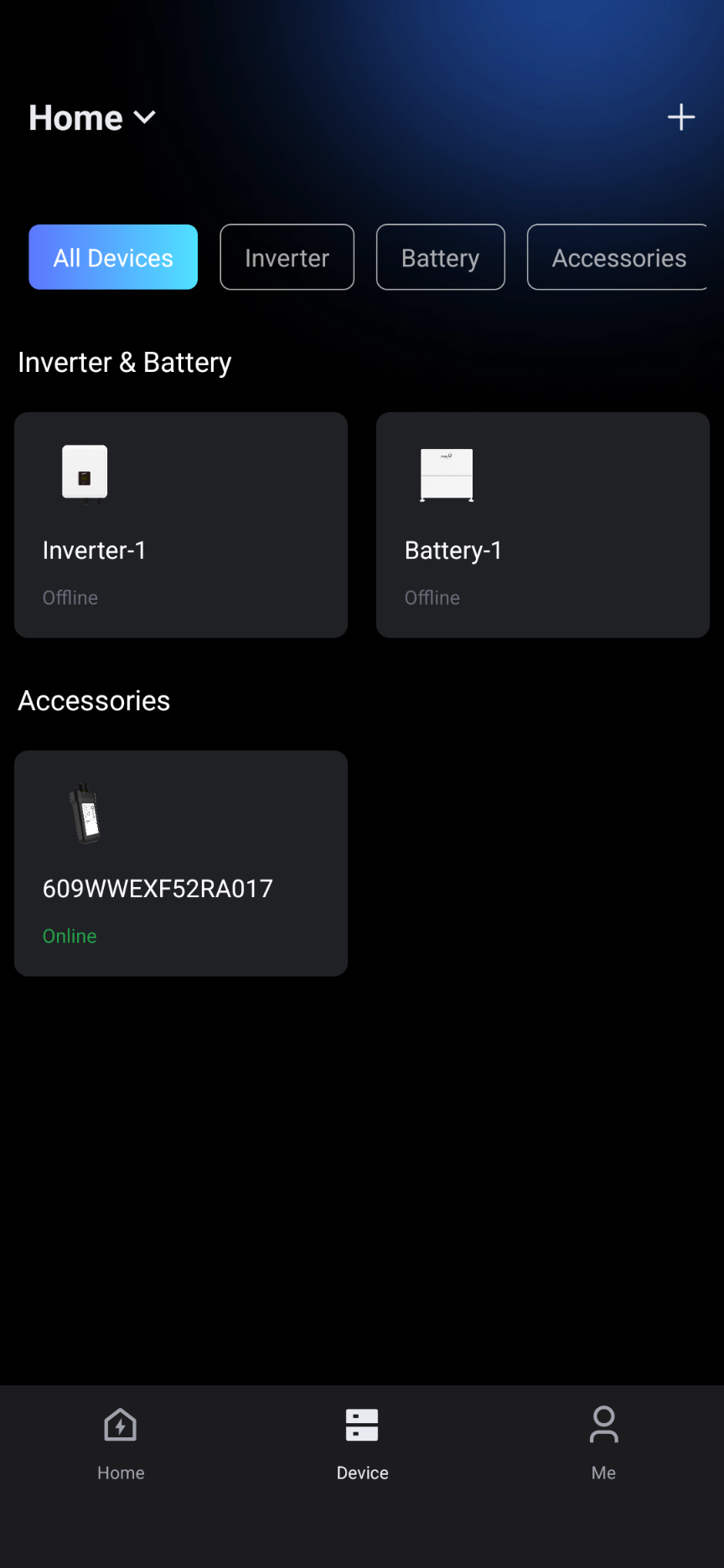

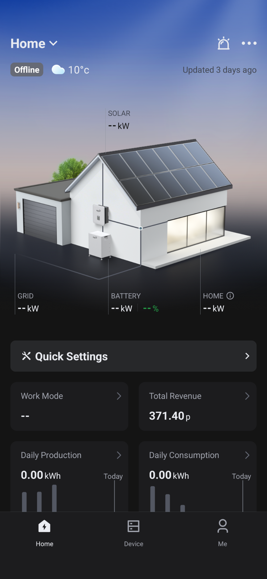

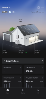

Sure. I have a KH7 / 3x EP5s with an 8.4kw array. It went offline at the same time - roughly 12:30ish a couple days ago. The inverter and batteries are offline, the WLAN / datalogger is online. I've got a slow blinking red light on the WLAN. It's been this way solidly since the downtime started, with no periods of reconnection.
Like I said earlier, I've tried all the community fixes. There's no modbus or any automation installed so I'm reliant on the app / website.
The system is working absolutely fine with no errors. It's just that connection to the fox cloud.

Thanks for the system details.
The only good news is the system still works, I presume your batteries are charging up ok?
So on the website, you can see just the WLAN logger in devices, and the Inverter and battery exist, but show offline?
Trying to picture what you see locally in my head.

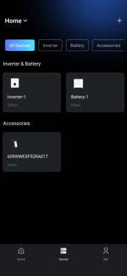

Everything is working fine, batteries are charging and discharging well.
Correct, both exist but are offline. Here's some screenshots.

Unfortunately the forum uploader isnt accepting the screenshot. But I've got the inverter, batteries, meter and data logger with SNs. The data logger is online, everything else is offline.
Re: Battery offline with no data
nosajxe wrote: ↑Sun Mar 15, 2026 11:09 am That would be great. Okay, that's assuming there's no issues with the Fox servers right?
Yes there still could be issues with the Fox servers, hence you are showing offline compared to most of us working.
