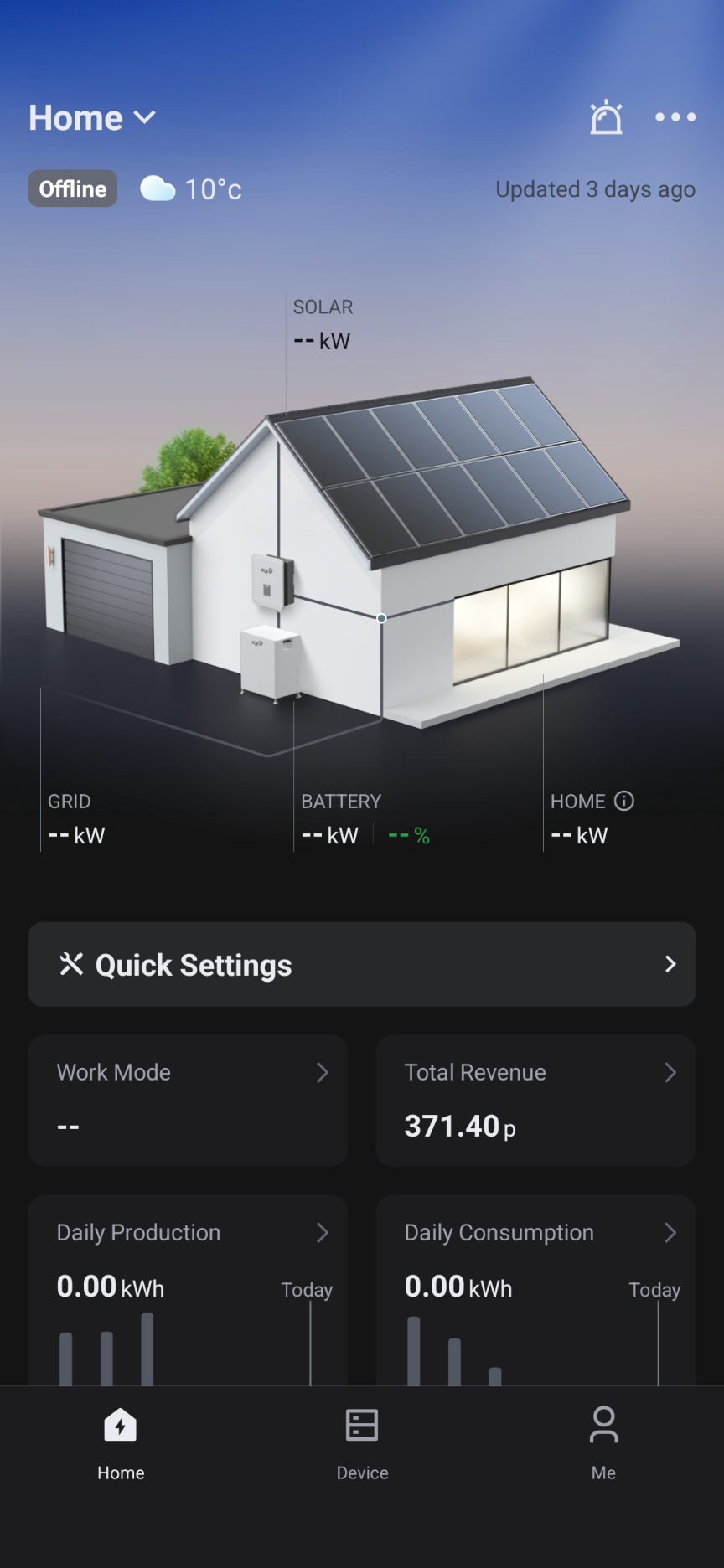

Correct, both exist but are offline. Here's some screenshots.
It's especially disheartening to head that others systems connection issues have been resolved. I feel left behind if it is the case that it's been resolved.
My frustration is the lack of official communication, if there are still fixes to be made on their servers, fair enough. I'm happy to wait but right now, I feel like I'm in the dark.
Re: Battery offline with no data
nosajxe wrote: Sun Mar 15, 2026 10:42 am Everything is working fine, batteries are charging and discharging well.
I know it could be a pain, but can you let us know the things you have tried. If you don't wish to (and I wouldn't blame you!) then that's ok, you can try to contact Fox/Installer for help.
