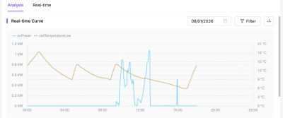

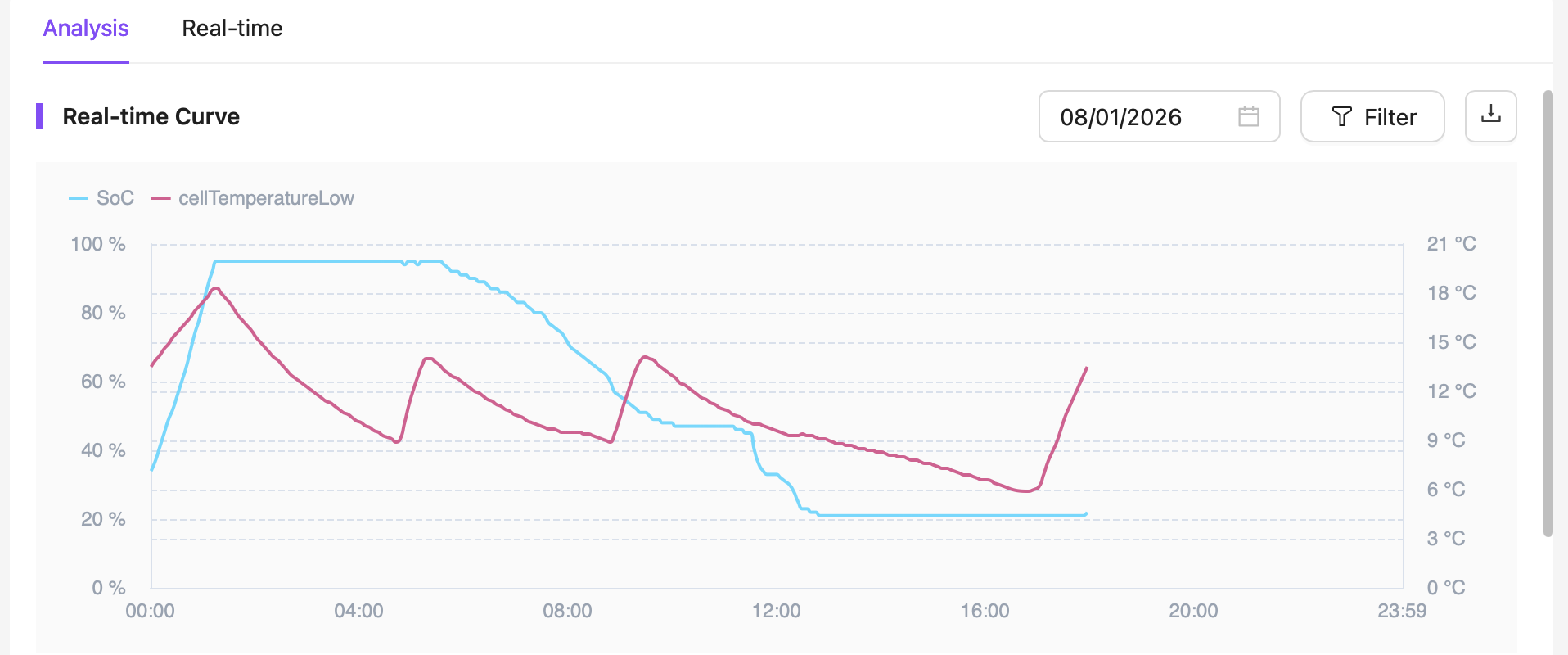

maccoylton wrote: ↑Wed Jan 07, 2026 5:50 pm Suggest it is not heating, since the temperature keeps dropping. My battery is outside, and currently it's around 0 degrees, looks like my charging kicked in around 16:08 today and it took 30 minutes to get BMS Cell Temp Low from 9 to 14 degrees
I agree, the logs are showing a lack of heating.

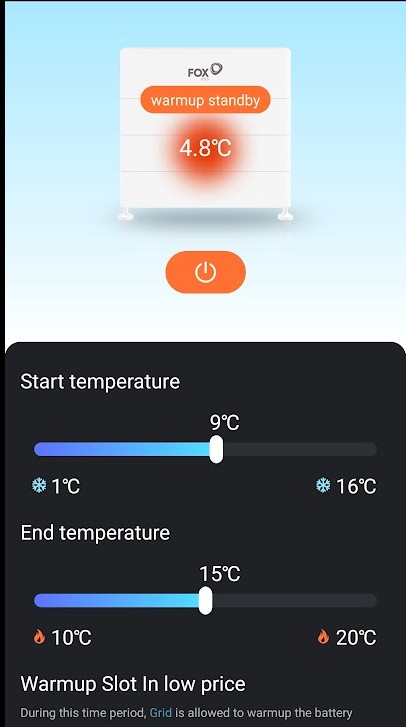

I am still on v1.009, yesterday temp was 6C for many hours, my heater min is 9C. The odd thing was, my phone was showing the heater animation, refreshing the screen, opening and closing the app it was same... perfect you would have thought.
Reality was, the battery didn't heat at all for me, flatlined at 6C. This was why I asked for the new v1.011, hoping it fixes the flakey heating. I know now that the new version is still broken, maybe there is a 1.012+ in pipeline as I suspect there are loads of tickets hitting them.
Your heater taking 30 mins was really fast, mine takes approx 55 mins from starting to end point in garage 9C to 15C. You probably have a very good battery heater, maybe the contact pad is making better contact.

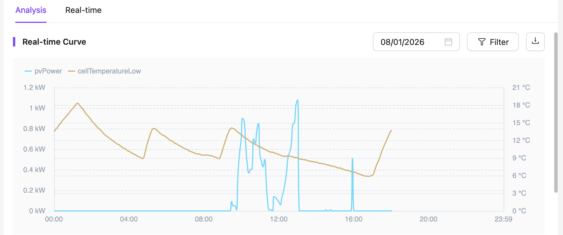

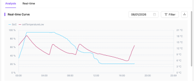

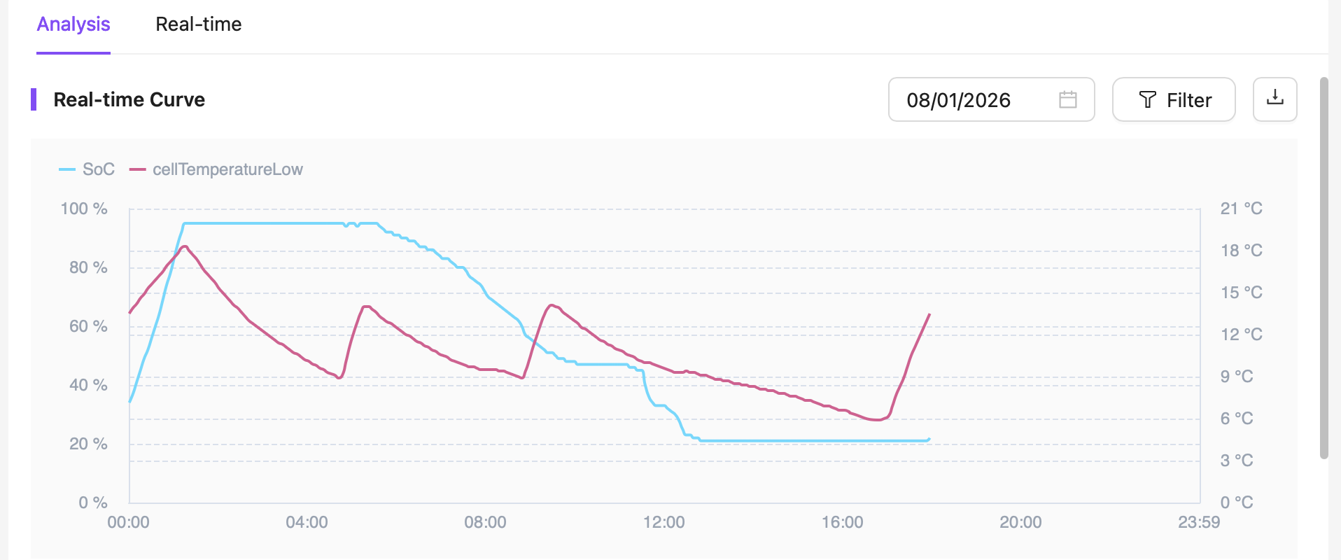

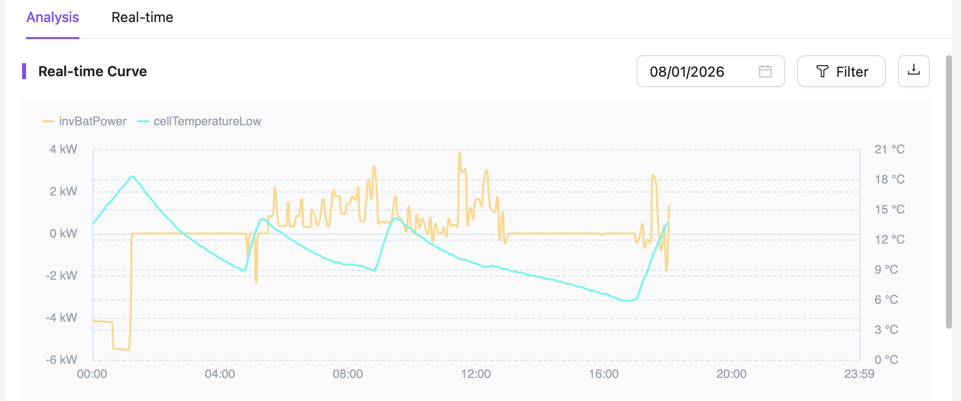

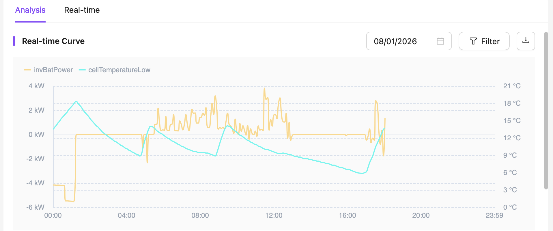

I had another occurrence of the reboot loop today with the Over-current Fault. Using the new graphing on FOX Cloud here is what I see.
The issue happened when:-
  • I am in self use mode
    The battery temp has reached the trigger temperature, its' set to heat for 9 to 13
    The SOC is at 40% or lower and therefore heating from battery power is no longer possible
    Heating is enabled 7x24 - 00:00-23:59
The heating cycle can be seen in the morning when the SOC is >40%, then around 13:03 ( reported by modbus) or (13:30 in the Fox app/cloud) the issue happens
There is some PV, but possibly not enough to heat and when the fault happens the PV power drops to zero ?

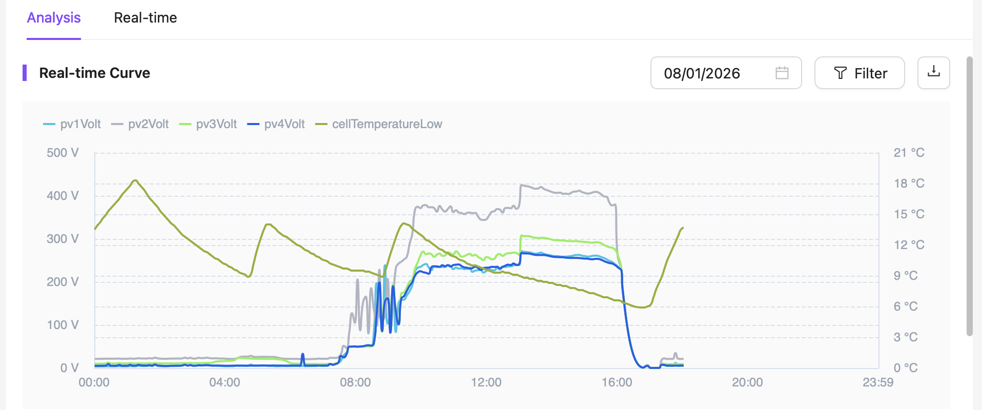

And the voltage on the PV strings jumps, I assume they have gone open circuit due to the fault.
You can also see it looks like the battery starts to charge very briefly (-ve) and the stops
On days where I have good PV production it runs all day ok, it;s there is low or no solar, and it's cold i.e. heating is required I see issues.
Today to get my system back up and running I switched off PV strings using the DC isolators, waited until I saw the inverter was back on the grid and saw it heating, presumable at this stage using grid power (its difficult to tell charging vs house load) , and then I turned the PV string back on.
Interestingly another user suggested they have tested as a workaround to only heat when mode is force charge. So it really does seem like this is related to the switch of heating sources in self use mode.

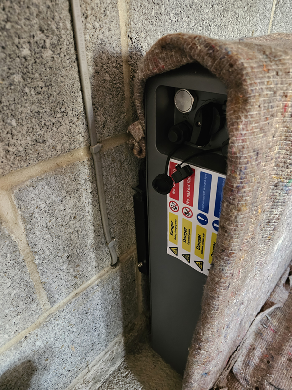

Since putting the blanket over my battery, my heater has not kicked in once since the 7th Jan 00:50. It did actually drop under the 9°C threshold just once, but the heater did not turn on.

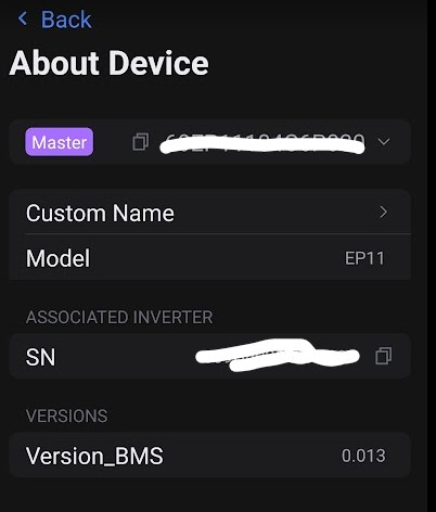

I'm glad it's not just me! Pleased you've got the update. I'll hang on to see how you get on with v0.013. Let us know how it goes if that's ok?

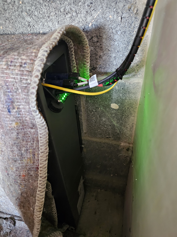

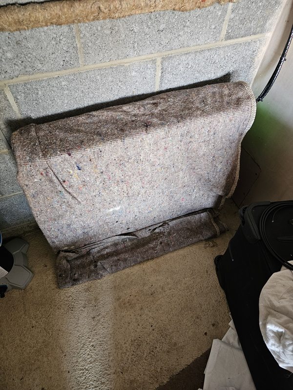

philt1808 wrote: ↑Wed Jan 14, 2026 11:47 am Morning MB - which blanket are you using for the battery? Any pics?
Mentioned here, and the next two posts down.
viewtopic.php?p=12015#p12015
It is one I found in my garage when moving in, a removal van looking one, I doubled it over and kept it away from the wiring. As it get's mild, I can open it up, and make it into a single layer if I cut the blanket (which I will do)
It has now been over 7 days and the heater has not had to come on once, saved a few kWh of heating... but most importantly, it has allowed the battery to charge and discharge for 100% up time.

Nice one. I was considering getting some foil insulation for my batteries as they're outside but don't really want to spend any more money given that the heaters should be sorting this! Your solution is obviously working well for you.

Yup it is a shame that the low tech solution wins.
It did once drop to under my 9°C starting point, to 8.7°C but the bugger didn't heat up (1.011) I have not bothered to reboot the system since getting a raft of firmware updates done, so it might have heated had I done this.
As a guesstimate, let's say it's 190 Watt of heating for 30mins (often longer) for 3x per day, over 7 days it adds up.
0.190kW x0.5hr (heating time) x 3 (times per day) x 7 (days) = 2kWh used or 4kWh if it heats for 1hr each time.
I am not concerned about this cost, but the real cost comes from having to buy peak price energy as it cannot heat up and charge/discharge at the same time. If our cars stopped working when we put the heaters on, we would be mad, it makes no sense that the heater pad stops charge or discharge.
philt1808 wrote: ↑Wed Jan 14, 2026 12:42 pm Nice one. I was considering getting some foil insulation for my batteries as they're outside but don't really want to spend any more money given that the heaters should be sorting this! Your solution is obviously working well for you.
I think if you have it outside, a box enclosure is more suited.
Wyndstryke has a little heater pad under his, but a simple blanket or maybe the foil could work for free.
No matter the choice, it is important to measure the temperature in any solution used.
And as a futher bonus, the additional warmth has made the battery charge and discharge rates improve. I was able to charge at the full KH7 7kW (6.72kW after losses) and discharge improved of course the same. Summer speeds!
