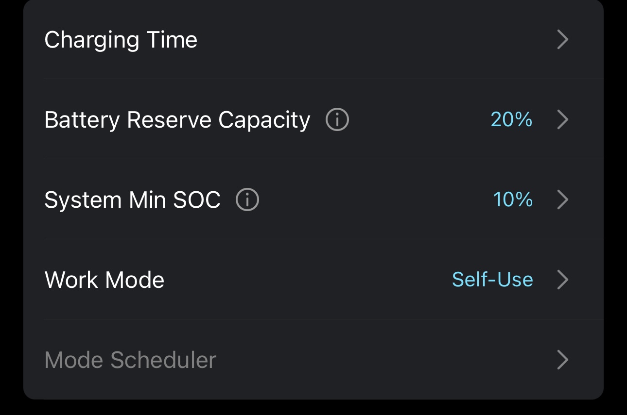

I recently had an H3 Pro system installed. Our inverter was operating as expected in Self-Use mode for about 2 weeks. However, for the past week it has used the grid instead of the battery for the majority of the night. I cannot figure out how to fix this.
Current settings:
+ Mode: Self-use
+ BRC: 20%
+ Min. SOC: 10%

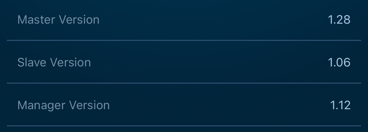

Firmware:
Master: 1.007
Slave: 1.07 (except one battery that is still on 1.06)
The battery will intermittently switch over with huge spikes and then switch back to the grid. I feel like there may be a significant issue with the battery. It is currently at 82%, but only discharging 5-20W.

Just to add to the list of common causes of battery not being used -
Do you have a charge period set ? - if they are set to *anything* other than 00:00-00:00 even with the grid charge switched off they will not discharge so double check the charge periods are set correctly or are left at 00:00.

It’s good practice to have all of the slaves the same, but they look like older firmware versions, which batteries are they ? - I can look up latest firmware versions.
On the Inverter itself, what firmware versions are you on - the H3 Pro is new and there have been recent firmware releases - Master is currently 1.28, Manager at 1.12
Re: Using Grid power instead of Battery on Self-Use mode?
Thanks again Dave!
I’ve checked the settings and they are all as you described. I cannot identify any particular pattern, except that it worked correctly until about a week ago.

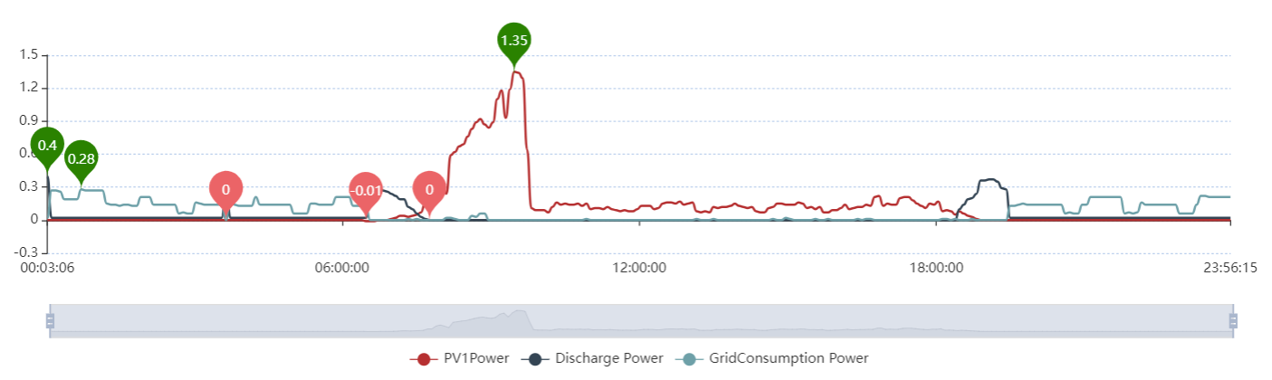

I just checked my inverter and noticed something strange from yesterday. It looks like the inverter is only using the battery when the PV is active.
1) We were on the grid overnight
2) As soon as there was voltage on the PV, the inverter switched over to the battery
3) The battery discharge went down as the PV power went up to fill the gap with the load
4) As the PV power went down at the end of the day, the battery discharged again to offset the load
5) When the PV finally had no voltage, the inverter switched from the battery back to the grid
Is it possible that the inverter would function like this? For the first 10 days that we had it, the self-use function worked properly with the battery discharging to the reserve amount before switching over to the grid. But now it seems like the inverter is only engaging the battery when the PV is on, otherwise it switches back to the grid.
NOTE: I still need to do the hard restart. I am currently out of the country, but should be back on Saturday.
It’s not a normal operating mode, i’ve seen it do something similar when the mode is set to feed-in first but only when there isn’t enough solar power and the battery fills in a bit - but you are in self-use ?…
I suppose it might be worth trying to change the work mode to be feed-in first, leave it a few minutes and then switch back to ‘Self Use’
If not lets see how it behaves after a full restart and we can investigate further

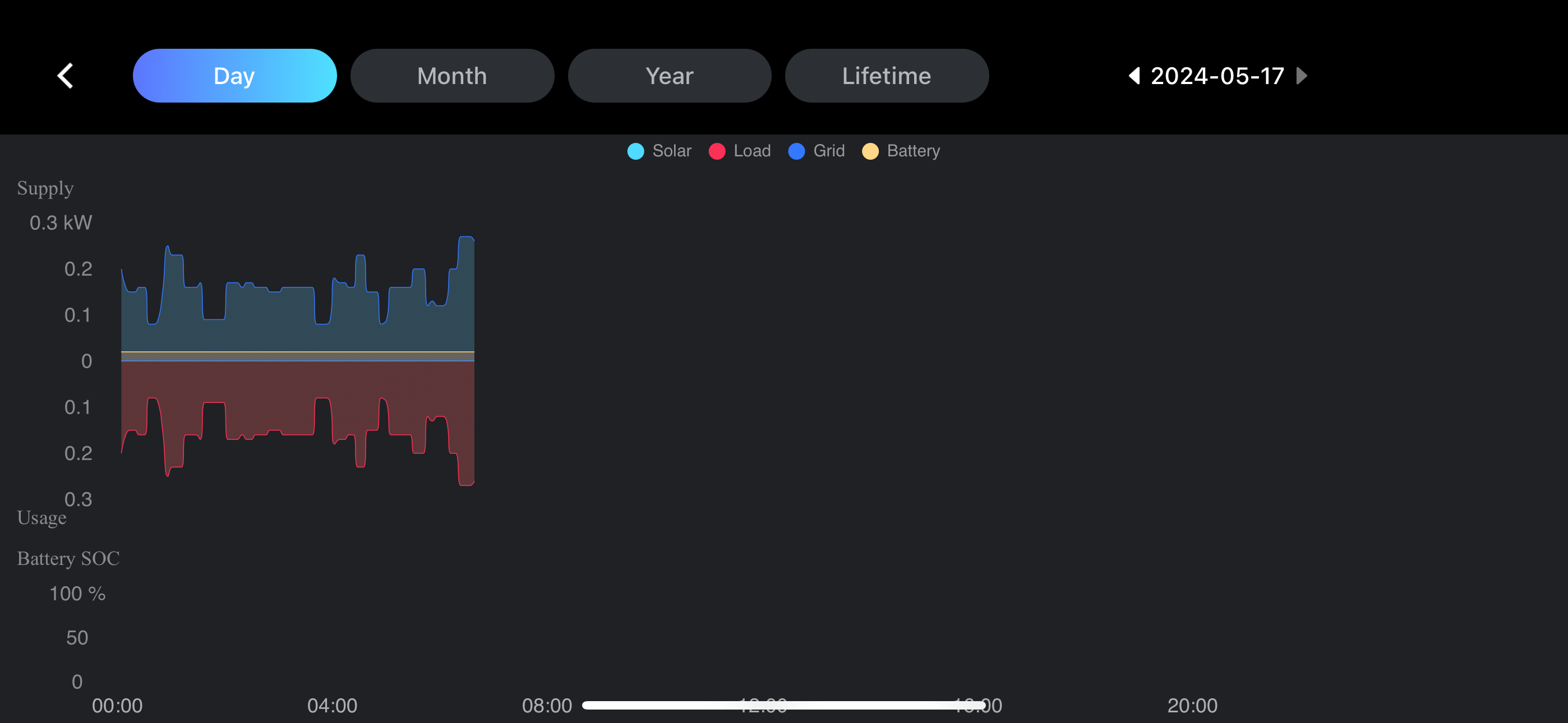

I wanted to provide a quick update:
+ Changing modes did not have an effect
+ So we did the hard reset on Monday
+ We also moved PV3 to PV2
The solar data is now showing correctly for the second set of panels both on the inverter and the app.
The data feed for SOC is still not logging in the app (ie shows as zero in the chart despite reporting correctly elsewhere in the app).
The battery now seems to be discharging as expected in self-use mode.
Thank you for your help!
Just flagging that this issue returned about 4 weeks after the hard reset. Will restart again. Any thoughts on whether this is a software issue or if there is a problem with the inverter itself?
Just looking at the data, it seems like around 28/4 it hit the SOC minimum and switched over to grid (correct function) and then it never switched back. It's almost as if the inverter's state changed because of the SOC settings, but then forgot to change back to the above-minimum-SOC state.
Manually toggling between states will fix it, but then at midnight it's like it switches back again.
