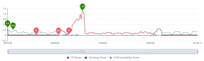

I think what you are looking at is data latency of the website - if a large load turns on or off the inverter has to source the load from pv/battery/grid to match - this often results in a very small time window where the grid is used to fill the gap, before the battery takes over. Likewise when a large load turns off, you sometimes see export again for a second or 2 before the inverter has the chance to adjust it's loads.
As the data 'snap shots' every 5 minutes you sometimes get strange looking traces (like this) where the system is mid change - If it settles down on the next 5 minute cycle then it is very likely this, it is better to view the graphs as they show the trend of the power usage - if it is higher than you expect on there, it's time to investigate.

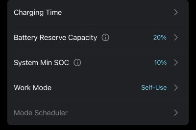

Current settings:
+ Mode: Self-use
+ BRC: 20%
+ Min. SOC: 10%

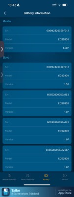

Firmware:
Master: 1.007
Slave: 1.07 (except one battery that is still on 1.06)

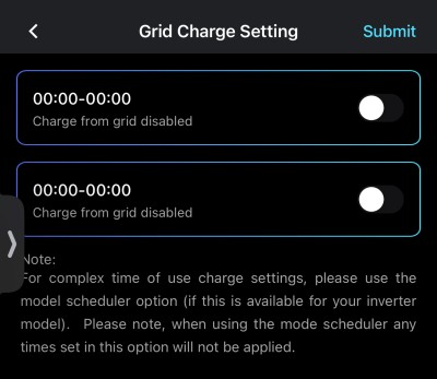

Do you have a charge period set ? - if they are set to *anything* other than 00:00-00:00 even with the grid charge switched off they will not discharge so double check the charge periods are set correctly or are left at 00:00.

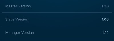

It’s good practice to have all of the slaves the same, but they look like older firmware versions, which batteries are they ? - I can look up latest firmware versions.
On the Inverter itself, what firmware versions are you on - the H3 Pro is new and there have been recent firmware releases - Master is currently 1.28, Manager at 1.12

I’ve checked the settings and they are all as you described. I cannot identify any particular pattern, except that it worked correctly until about a week ago.

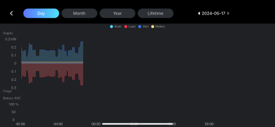

Just flagging that this issue returned about 4 weeks after the hard reset. Will restart again. Any thoughts on whether this is a software issue or if there is a problem with the inverter itself?
Just looking at the data, it seems like around 28/4 it hit the SOC minimum and switched over to grid (correct function) and then it never switched back. It's almost as if the inverter's state changed because of the SOC settings, but then forgot to change back to the above-minimum-SOC state.
Manually toggling between states will fix it, but then at midnight it's like it switches back again.
