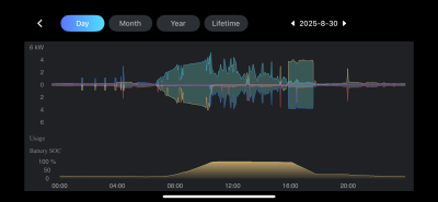

On 30/08/25 @ 2am: The battery discharges to 12% and there is a pulse charging up to 13%. Why doesn't it go down to 10% min SOC on grid?
There are a series of pulses between 2am and 5am when the battery drops to 12% that forces charge back up to 13%.
Also the discharge cycle at 4pm goes down to 25% at which point I manually reset the system to prevent further drop. This was schedules to go down to 30% so why drop to 25%?
