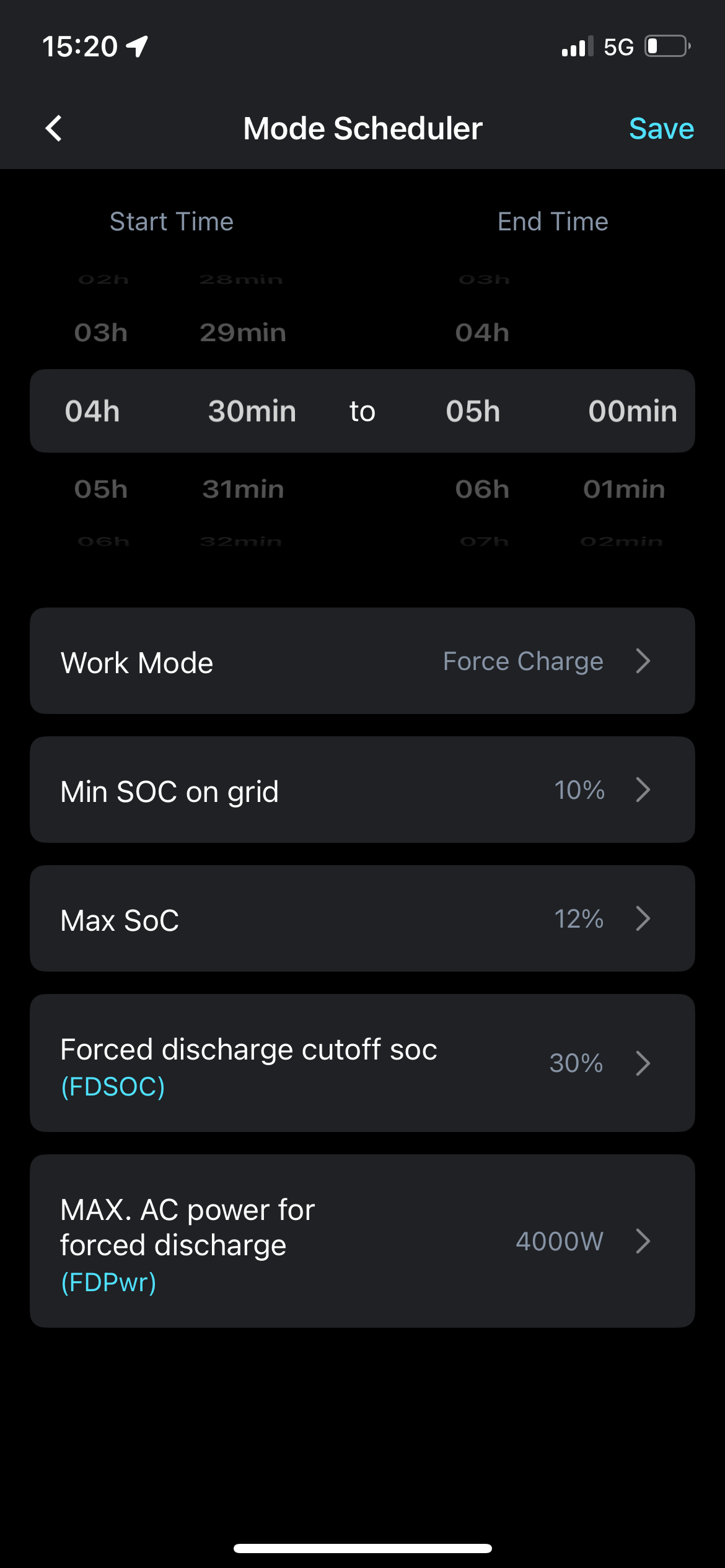

There seems to be an issue with charging up before sunrise. I have my mode schedule set to charge with the following settings:
Work mode: Force Charge
Min SOC on grid: 10%
Max SOC:12%
Forced discharge cutoff soc (FDSOC): 30%
MAX. AC power for forced discharge (FDPwr): 4000W

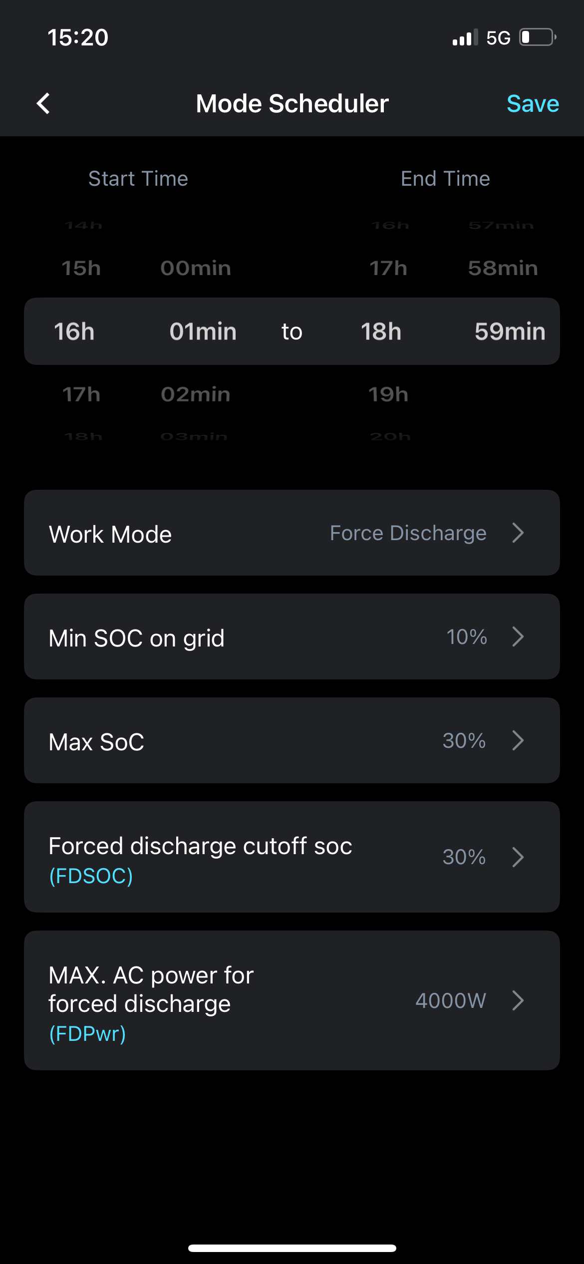

The only other entry in my mode scheduler is Forced discharge, min SOC on grid 10%, FDSOC 30%, FDPwr 4000W. This works fine on its own and discharges to 30% as required.
When I introduce the Forced charge, albeit the battery has already reached 10% prior to 4:30am, the system charges up past 12%, reaching 15% on grid before sunrise at which point PV is sufficient to take over charge.

Can you post a picture from your app of your scheduler settings please (particularly the times).
For force charge, FDSoC and FDPwr are not used and are ignored (but they have to be entered as a valid number).

Can I ask why you are using maxsoc of 12% in the force charge from grid, that would/should restrict the charge to no more than 12% soc which is only a very small amount above your minsoc (10%)
I only need 2% in the morning from 5am to 7.30am when PV takes over to charge the battery.

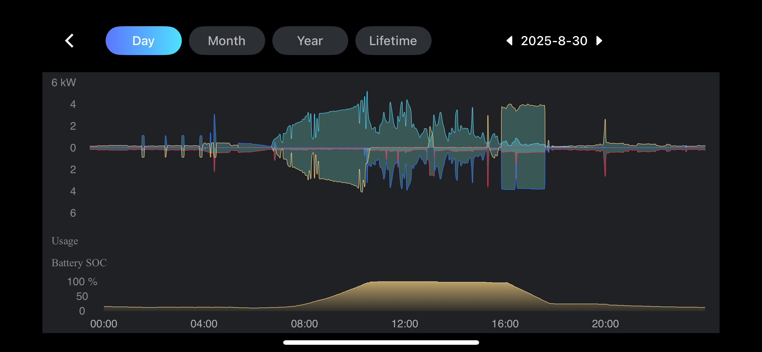

On 30/08/25 @ 2am: The battery discharges to 12% and there is a pulse charging up to 13%. Why doesn't it go down to 10% min SOC on grid?
There are a series of pulses between 2am and 5am when the battery drops to 12% that forces charge back up to 13%.
Also the discharge cycle at 4pm goes down to 25% at which point I manually reset the system to prevent further drop. This was schedules to go down to 30% so why drop to 25%?

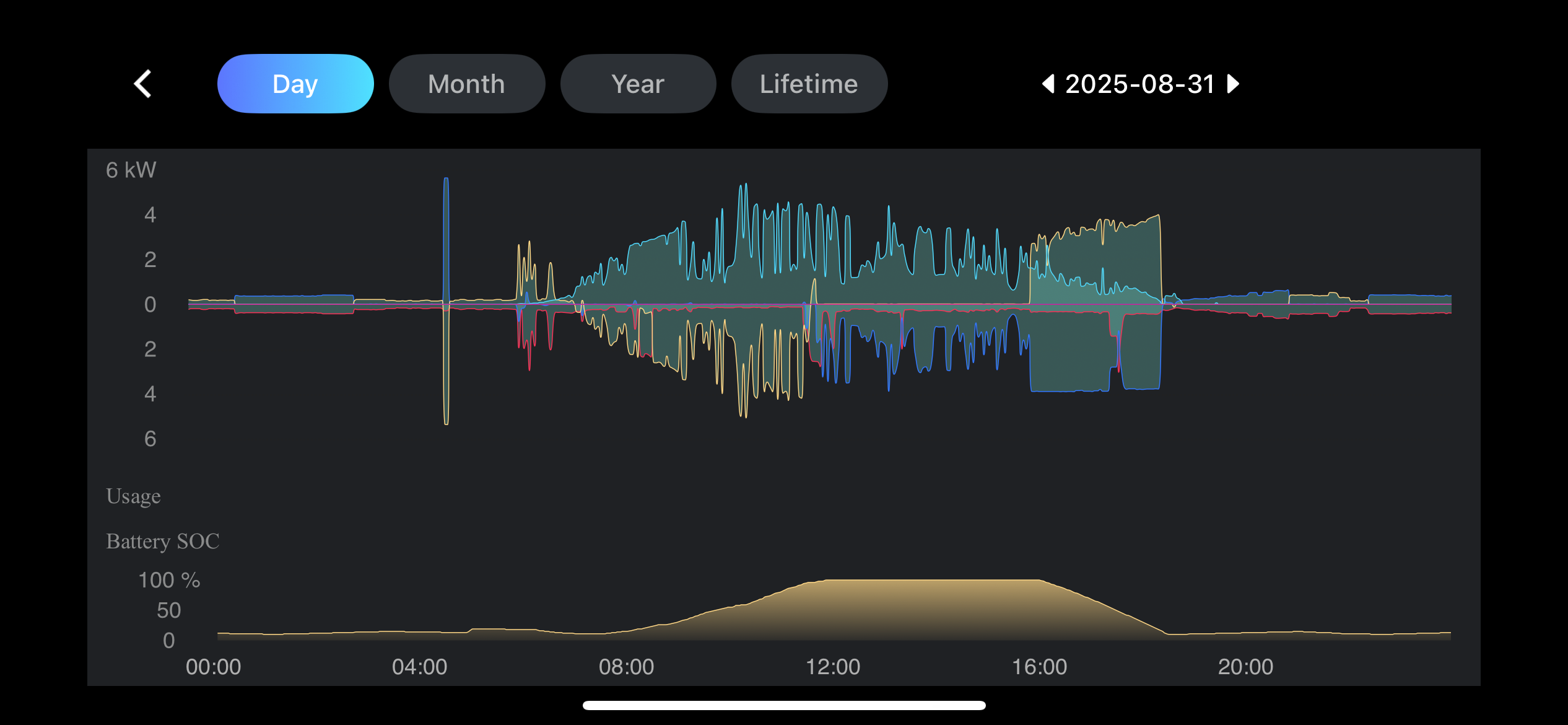

The following day (31/8/25): I attempted to use the charge time option to set overnight charging (rather than the mode scheduler). The charge period was enabled between 04:55 and 05:00 and a spike is visible charging from 13% to 19%. Prior to this, the battery drops to 10% at 01:00 and the system auto charges back up to 15%. Why does it do this?
The discharge cycle at 4pm goes below scheduler setting of 30%. I was not home in time to do the manual reset this time and the battery discharged all the way down to 10%. Again why drop below 30%?
