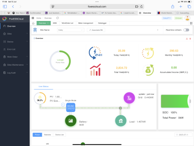

Hi Dave
So I’ve finally managed to get onto the web link for this and I have no clue what to do!
Can you talk me though it please?
Ok, it takes a bit of getting used to - but in the left menu, choose ‘Device’, ‘Inverter’ and it will list all the inverters on your site, in the ‘Operation’ box click on the blue icon which will take you to the Inverter Details page, approx half way down that screen is ‘Energy Flow’ and under that you will see the text Work Model : xxxxxxxx and next to that another blue icon, click that and it will take you to the scheduler page, stay on the ‘user defined’ tab and create your schedule and choose Force Charge, set your time period, minSoC (usually leave at 10%) and MaxSoC to 100% (that’s how high you want to charge the battery too) and ‘save’ which will write the schedule to the inverter.
