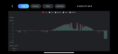

1. Is there a reason that the data on the House Dashboard does not match the data on the graph ?
The house dashboard shows total PV production of 5.2KW, export to Grid of 4.72kW and Load or 0.46kW.
When I swipe to look at the graph all the figures look correct, apart from the Load Consumed, which is showing 5.07kW.

Thank you Dave for your reply.
If the graph is showing a cumulative value for Load as you suggest, can you explain why the Load value then tapers off at the end of the day, this would suggest that my house is then Generating electricity when the sun goes down, ie a negative Load.
Do you know how the app is calculating the Load ?
Do you know if there is a way to export the data that the app is using, so that I can analyse this myself ?

There is definitely something wrong with the placement of the CT clamp if the load is reading as negative, something is generating power that is making the load calculation incorrect. I can't see the time scale so not sure what time of day that is occurring, but do you have another solar system or a generator installed ?.
The app calculates load by measuring the current flow through the CT clamp, when the CT clamp current is zero the inverter knows that the amount of power being generated is the same as the load being used, likewise if it is exporting 4kW and the CT clamp is measuring 3kW it knows that the house load is 1kW.
But this can never go negative unless there is something generating power that it doesn't know about - if that is the case you fit a second CT clamp (meter2/CT2) to the generator so that it can correctly calculate load and use any exported power effectively.
The calculation is -
House Load = Grid Consumption + Inverter Output Power ('R Power') - Feedin Power + Meter2 Power

Thanks again Dave
Yes I do have a legacy PV system, which uses a Solis inverter, this is being monitored using CT2, and appears as "Gen" in the app.
