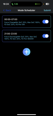

Can you please tell me the mode scheduler setting for my PV system where I can
1. force discharge my batteries between 2100 - 2300 every night for anything above 20%. I want my batteries to hold 20% at any point of time, so they don’t fully discharge.
2. Force charge my batteries between 0000 - 0700 every morning, all the way to 100%

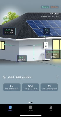

I had got in touch with Fox and they remotely applied the below settings but nothing is happening. More so the readings on the app have gone wonky. Attachments
The scheduler settings look ok for a force charge between 00:00 & 07:00 and a full power discharge between 21:00 & 23:00 (note your battery may run out and you end up using grid power which might be costly).
Is there a reason why you have chosen 20%, if you don't have EPS installed it should be set to 10% as this is what the batteries are rated and warrantied for and the 10% is the buffer the LFP batteries need to maintain them for the best lifecycle.

Secondly it appears that your CT clamp has stopped working, has become disabled or disconnected which is why you are getting negative load values - without that the Inverter cannot calculate the house load and the battery will not be used to - again I think you need to call your installer and get them back to check that.

Also I need the battery to always retain 20% so that if it doesn't charge up during off peak hours from the grid, as i also charge my EV car during then, then at least I will have 20% left for the next day which is sufficient for my use.
You mentioned the current schedule is set for completely draining the battery, can you please advise on the changes I need to make in the mode scheduler.
If it continues to show a negative load your CT has either stopped working or been disabled and there's nothing you can do on the app, you need to know if a CT or a meter has been fitted - if you know what has been fitted a CT for instance, you can check in the inverter Settings, Feature, Meter/CT to see if it has become disabled but if you don't know you will need your installer back as it's just as likely it could be a cabling fault.

On the Force Discharge schedule you would be better raising the FDSoC to (say) 30% that way it will stop discharging to the grid when the batteries reach 30% and as your minSoC is set to 20% the remaining 10% will be used to power the house.
Is there a number i can reach out to you for a Facetime session. I do have CT clamps (1 for the EV charger and 1 for the Solar system). But i think the DNO folks messed up the direction when they upgraded the fuse.
Additionally, the inverter meter shows as offline on the Foxess portal.

Hmm, as it is such a new install I really do think you should get your installer back to look at this for you, it could be CT direction or a cable break either are very possible if things have been changed recently,
