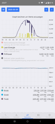

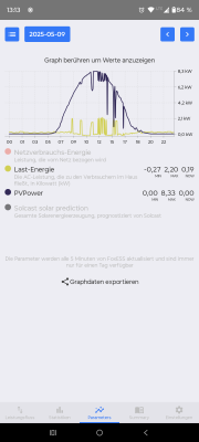

I'm experiencing a strange behavior with my inverter. On sunny days with high PV output, the PV power drops significantly when there's grid consumption. You can see this clearly in the screenshot. The yellow line represents consumption and the black line represents PV power. Is this just happening to me?"

It's not unusual to see drops in peak output with clouds or shading effect - have you ruled that out?
It is possible your inverter is tripping when exporting because the grid voltage is going too high - do you see any alarms or error messages for that period ? - If you look at Foxesscloud in the Inverter Details, in the empty graph at the bottom you can select RVolt, SVolt, TVolt sensors and that will show you the voltage for the day - and highlight the peaks - does that look to be high when the PV output falls ?

"Thank you for your quick response.
In this case, I can rule out clouds.
I can intentionally trigger this behavior by turning on larger consumers (kettle, oven, ...).
The R/S/T voltages also look very constant on this day. As I mentioned, the behavior is reproducible and was also present in older firmware versions. What additionally puzzles me is that there was more than enough PV power available, and I fed a lot into the grid."

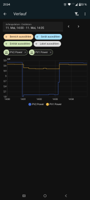

Today, I ran the kettle for two minutes (~2kW).
For exactly that time, the PV power from the PV2 string dropped.
I find it strange, as the inverter should have more than enough power.
However, I can now imagine what's happening. The inverter sees the load on one phase and wants to balance it in the grid, but due to the 3.5kW limit per phase, it can't distribute properly.
For example, PV power is 8kW
R - 0W
S - 2000W
T - 0W
Now it wants to distribute the 8kW and balance the load.
R - 2000W
S - 2000W + 2000W
T - 2000W
But since it can only do 3.5kW on phase S, it will have to throttle back... That's my idea.
Is there maybe a setting that allows asymmetric feed-in?"

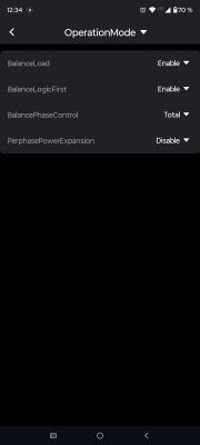

My question now is, I've found the options
BalanceLoad,
BalanceLogicFirst,
BalanceFaceControl
and PerphasePowerExpansion in the settings.
Could I solve the problem by disabling BalanceLoad?
I don't want to just try it out, as I'm not familiar with the function of these parameters.
Can someone explain these functions to me?
Posts: 7
Joined: Sat May 10, 2025 12:16 pm
Problem solved.
Simply setting the BalanceLoad option to disabled resolves the issue, allowing to bypass the temporary overload.
However, please be aware of the regulations of the local grid operators, as this may not be permitted in some cases.
Greetings!
