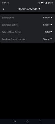

My question now is, I've found the options
BalanceLoad,
BalanceLogicFirst,
BalanceFaceControl
and PerphasePowerExpansion in the settings.
Could I solve the problem by disabling BalanceLoad?
I don't want to just try it out, as I'm not familiar with the function of these parameters.
Can someone explain these functions to me?
