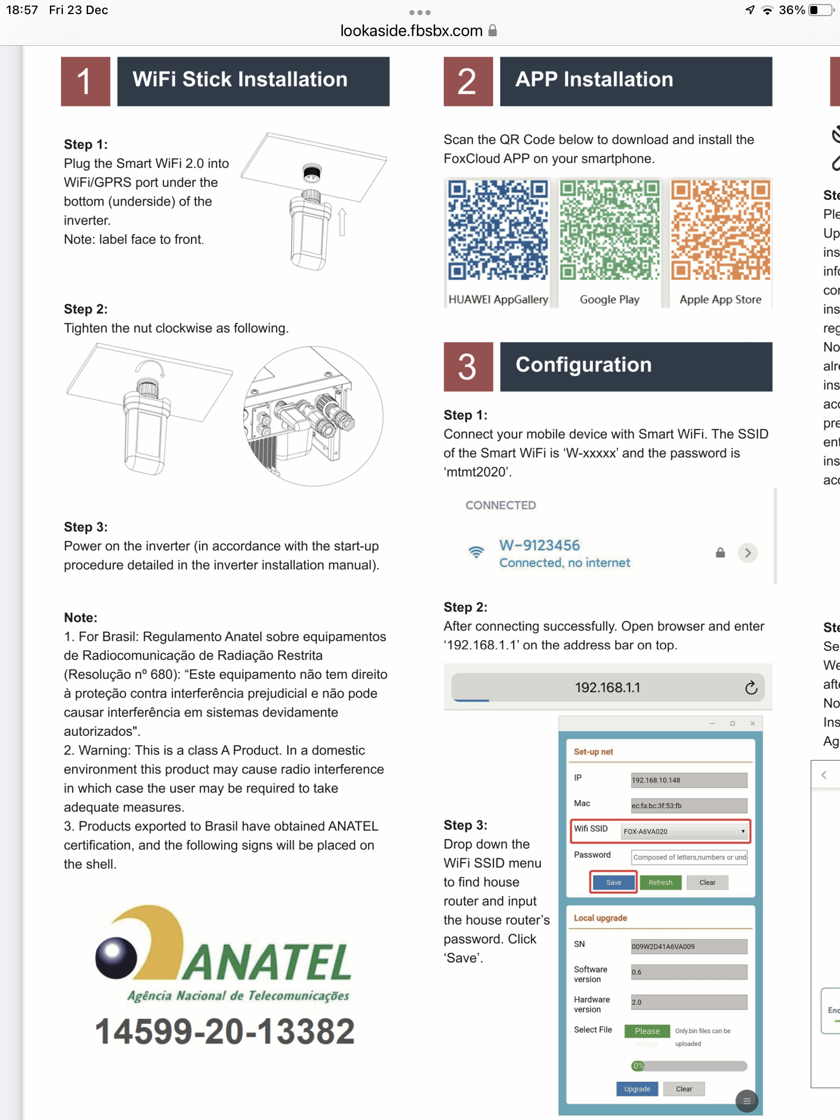

If you have to change the wifi dongle to match the new router - the default password is mtmt2020 (all lower case), the connection guide is attached.
