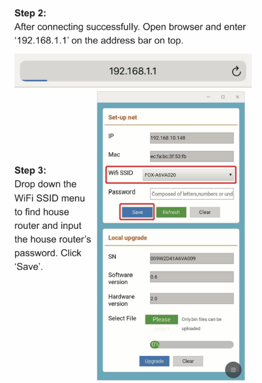

I followed the advice in this helpful image to connect to the wifi module on my phone; for me, this is W-497A119, which is already stored in my phone's system, with the password mtmt2020 coded in. When I am connected to that network, I then went to 192.168.1.1 on a separate browser and hit enter

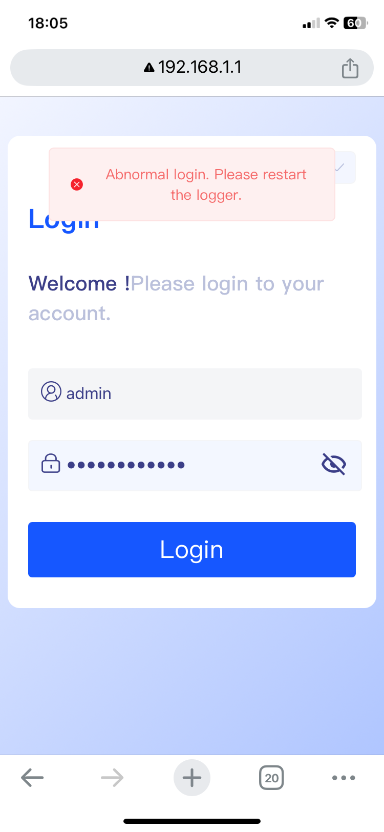

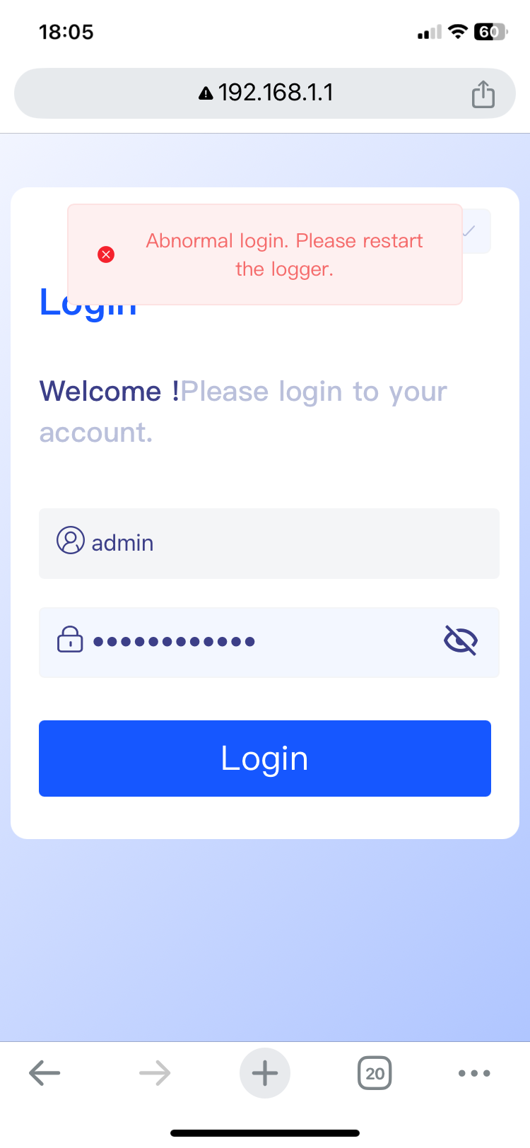

Here's where I get something different from what I expect. I get a page asking me to log in to the admin account (which can't be changed, there's no way I can try to log into a different one). If I enter my wifi network password, it gets rejected (abnormal login, as shown in the image below) as does mtmt2020. So I can't get past this to the page where I can select my home network and then put that network password in

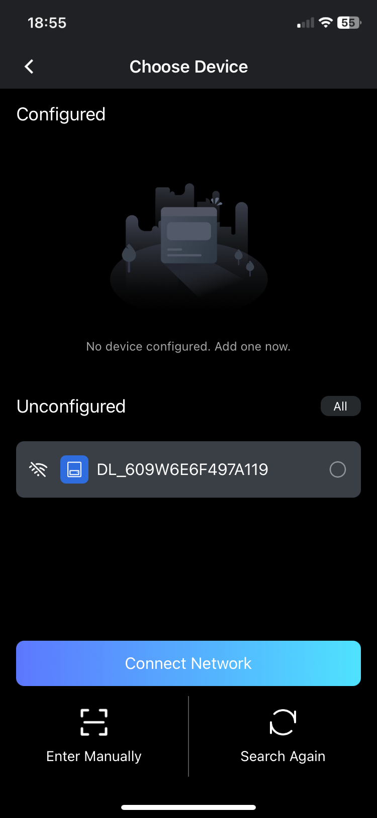

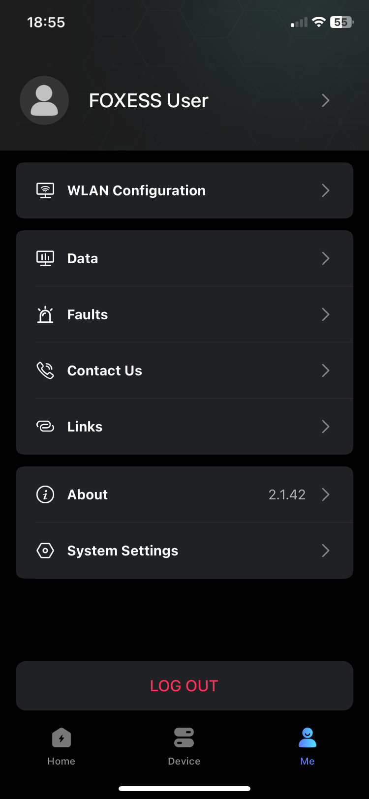

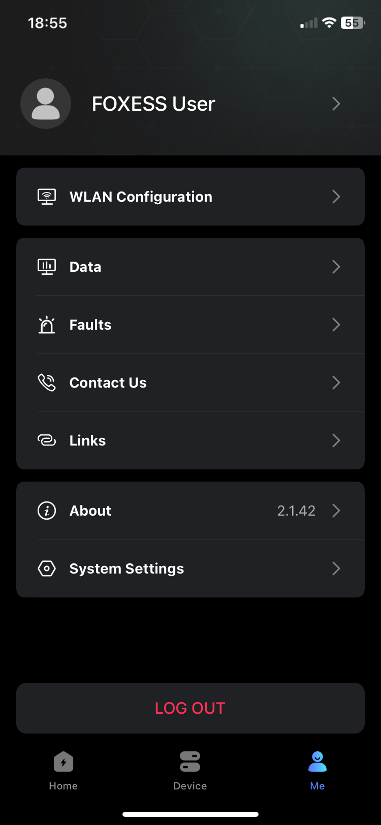

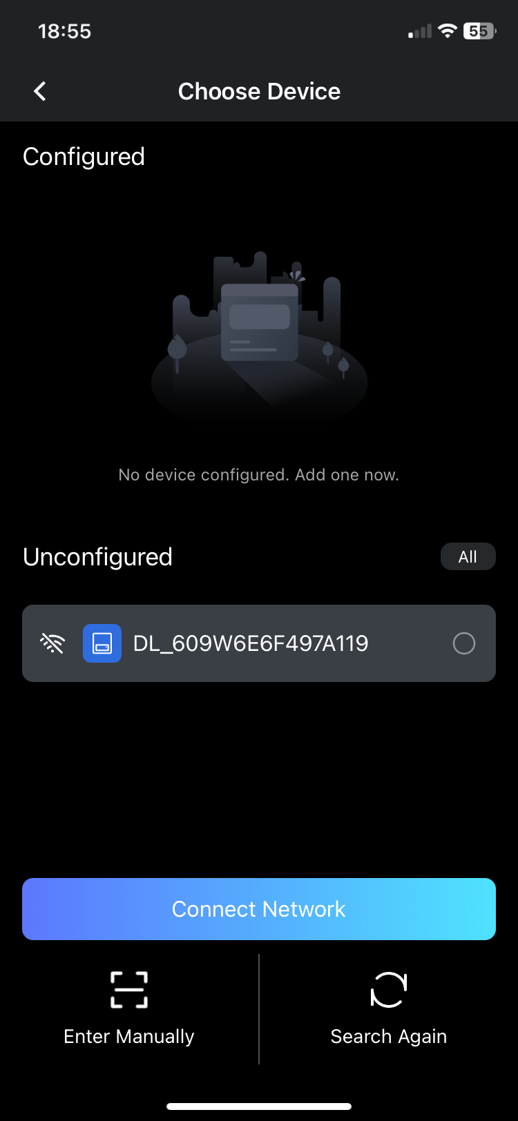

I went into the app.
Used the "me" button at the bottom left and selected WLAN configuration let it search for devices, and it found my module (shown in the middle of this picture), so I selected that, connected network and entered my wifi router password, and we're back on again. Really appreciate your help, Will.

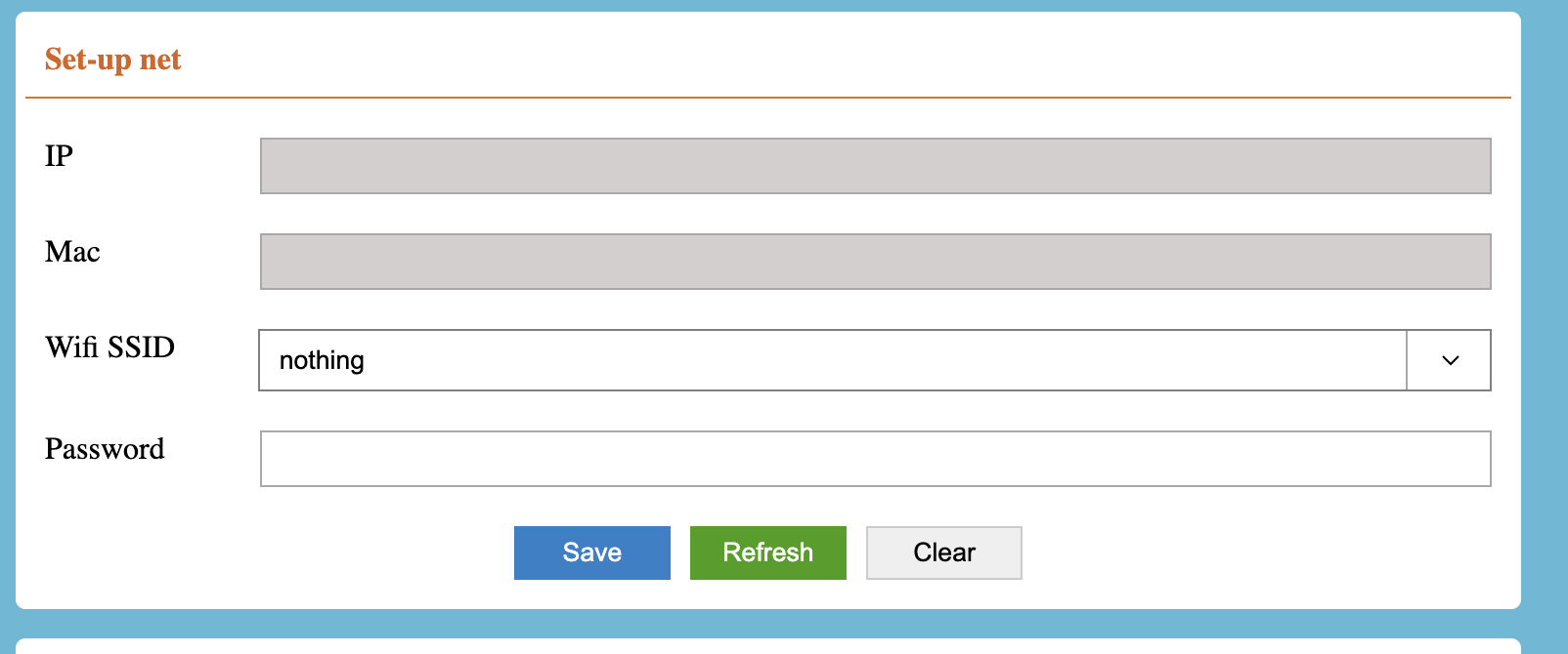

Hi, I have been trying to connect to my wifi network and have followed some of the tips on this forum. However when I connect directly to the dongle wifi (page 192.168.1.1) it loads the page but does not give me a list of available networks. See screenshot .
I have tried ensuring I have a wifi with only 2.4ghz signal but get nothing.
Help appreciated.
Help appreciated.
make sure you put it into airplane mode, then only enable wifi. Phones are too clever nowadays and will try to bridge wifi with mobile networks when it can't access the internet causing the browser to stall. Airplane mode solves this.
Thanks, I just tried putting into Airplane mode and just starting Wifi but makes no difference. I also tried with a Mac laptop. I can see the page connecting and initializing but I never see any available networks in the dropdown.
