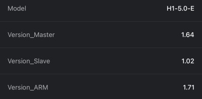

Hi - wondering if this might just be a firmware issue, but could do with a steer.
Have connected the 304 to the H1 inverter. Get most of the data in HA, for about 12h, then suffer the following connection error:
