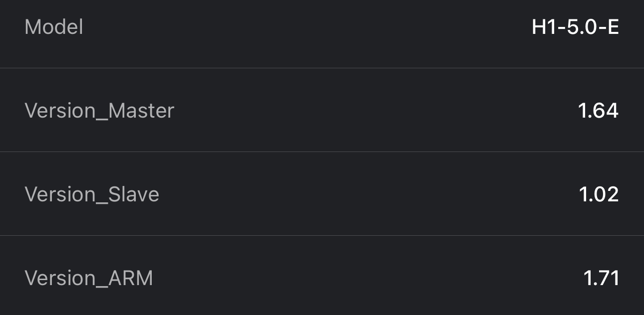

Hi - wondering if this might just be a firmware issue, but could do with a steer.
Have connected the 304 to the H1 inverter. Get most of the data in HA, for about 12h, then suffer the following connection error:
Changed to Error reading registers. Type: RegisterType.INPUT; start: 41000; count: 12; slave: 247 from rtu_over_tcp://192.168.86.42:502: Modbus Error: [Input/Output] Modbus Error: [Invalid Message] No response received, expected at least 4 bytes (0 received)
Any help appreciated.
