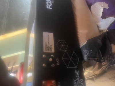

I purchased a 5.7 system from The battery factory in September and to date have not been able to commission the system.
The batteries were low in charge and so far have abot 20 volts each. The BMS does not boot up.
I am waiting for a replacement BMS but what voltage does it need to function.
Both the 2 HV2600s and the BMS have a white label "version D"
I also notice that there is no Battery Awaken Breaker. Is this no longer included.
So the question is how do I get this system to start?

Can you upload a photo of the BMS?
Normally HV2600 are around 53volts. 20 voltages sounds like permanent damage has occurred.
I assume you have the BMS connected to an inverter right? then you set the dip switches to the correct dip position, turn on the main MCB breaker and then press the silver power button on the BMS. Then I would tell your inverter to do a force charge asap.

Connecting to the HV1 inverter and powering on gives zero result so no communication to the inverter. so is there a minimum voltage required to power the BMS?
Also checking behind the cover of the "Battery awaken breaker shows a large space. Is this an omission or does this BMS now have no breaker?
So no BMS, no chance to charge the batteries. No response from Fox so altogether rather a poor purchase

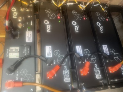

Can you upload/attach a photo of your full setup?
Sorry, not sure why.
two hv2600 connected in series to BMS connected to AC 3-7 Hybrid inverter.
All installed as per Fox videos and manual.
question does you bms have the Battery awaken breaker?
Battery awaken breaker should be turned off and the cover should be closed flush with the bms.
if combine they're at 50volts and they should be more like 100ish volts this is likely why the system is dead. I bet it's expecting 100v minimum as it requires 2 battery units.

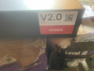

I have just had collected my 4x HV2600 and BMS on Friday.
After setting everything up as instructed I was getting a BMS alarm and fault on the cloud.
I looked over the batteries I realised one of them hadn’t woken up. All voltages were as expected.
Looking at the labels 3x had Ver.D and 1x didn’t.
After removing the battery I noticed it had a label on the side at the rear showing V2
I guess that I have been delivered 3x HV2600 and BMS are V1 and 1 battery is a V2.
I have spoken to my installer and he is going to contact his supplier on Monday.
Please see pictures.
I hope is of some use.
