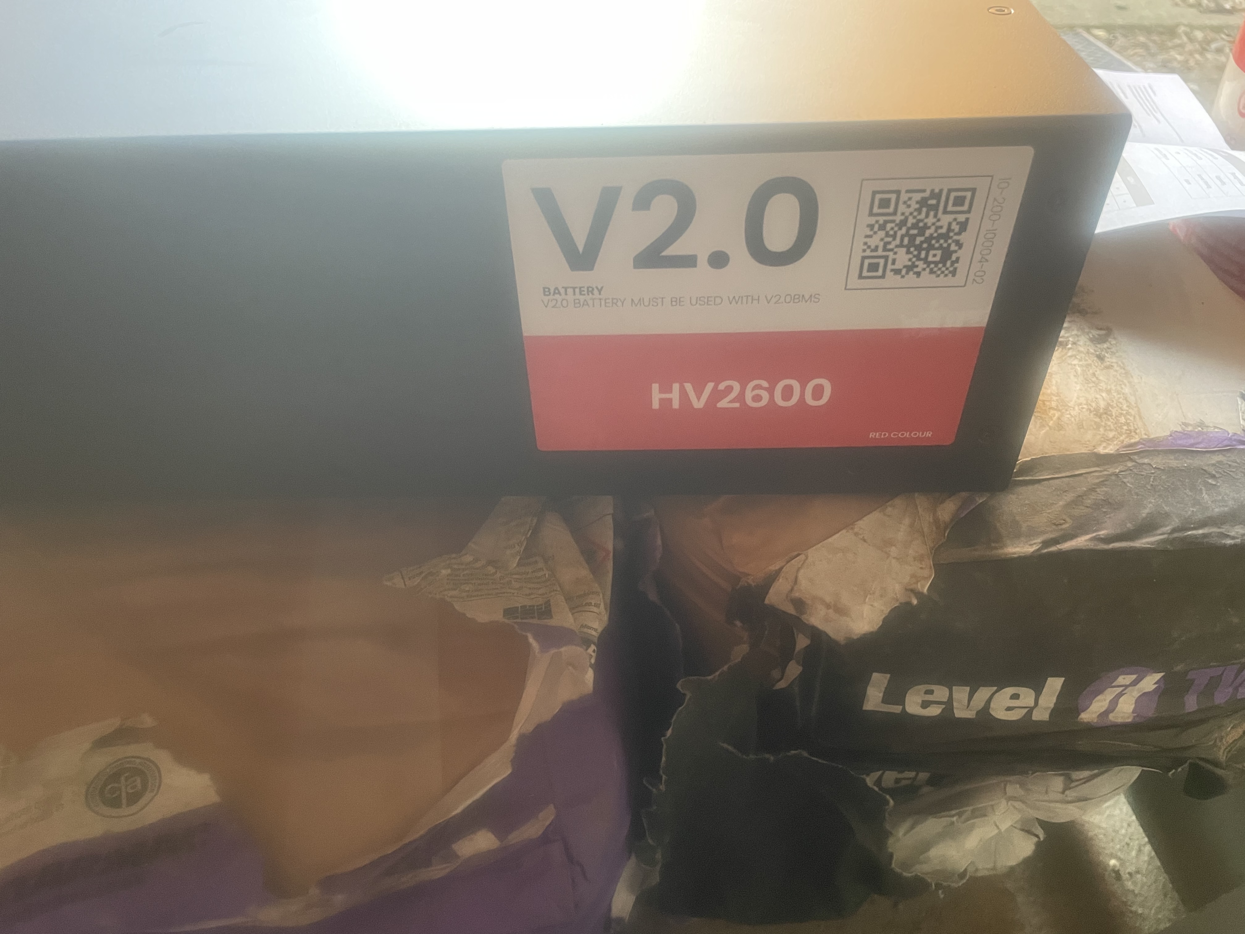

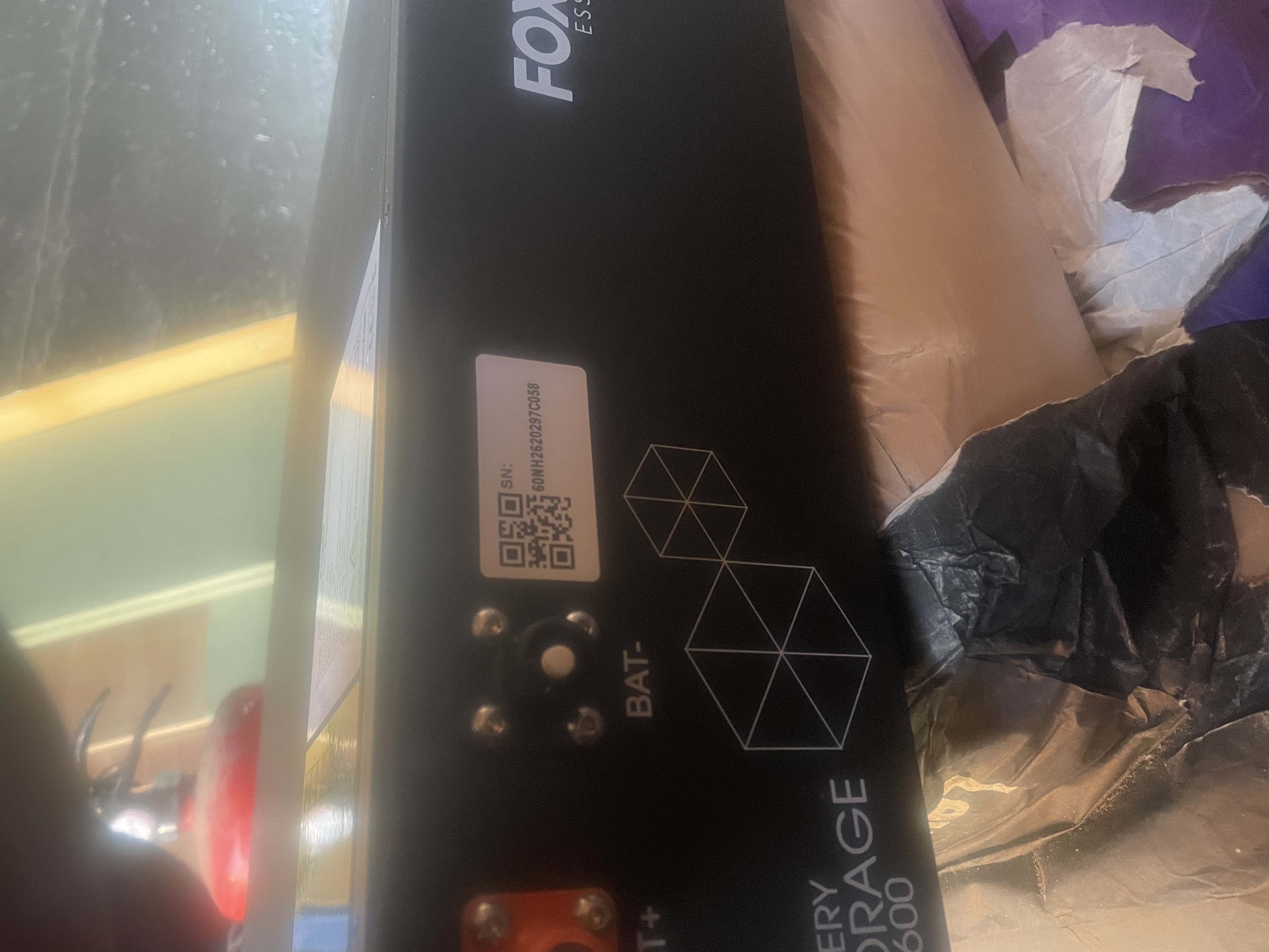

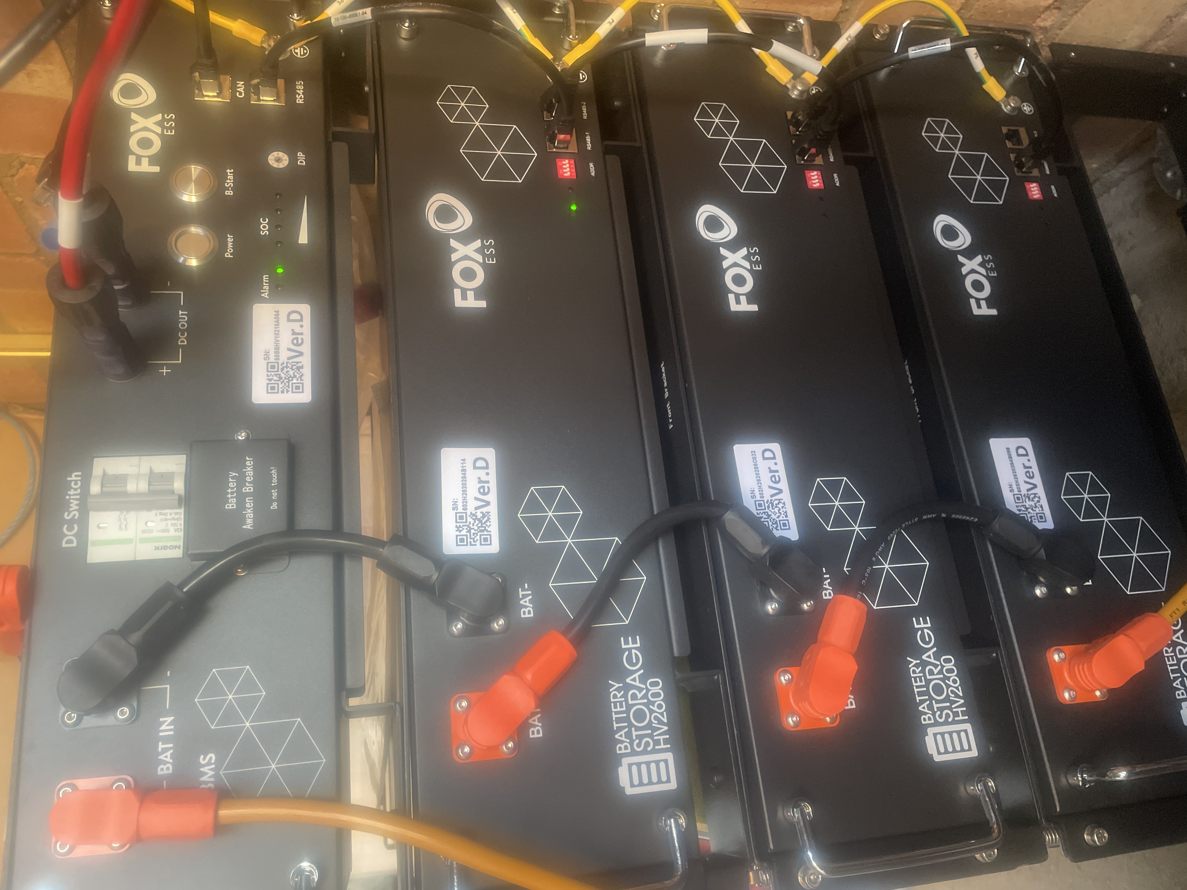

I have just had collected my 4x HV2600 and BMS on Friday.
After setting everything up as instructed I was getting a BMS alarm and fault on the cloud.
I looked over the batteries I realised one of them hadn’t woken up. All voltages were as expected.
Looking at the labels 3x had Ver.D and 1x didn’t.
After removing the battery I noticed it had a label on the side at the rear showing V2
I guess that I have been delivered 3x HV2600 and BMS are V1 and 1 battery is a V2.
I have spoken to my installer and he is going to contact his supplier on Monday.
Please see pictures.
I hope is of some use.
