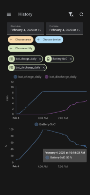

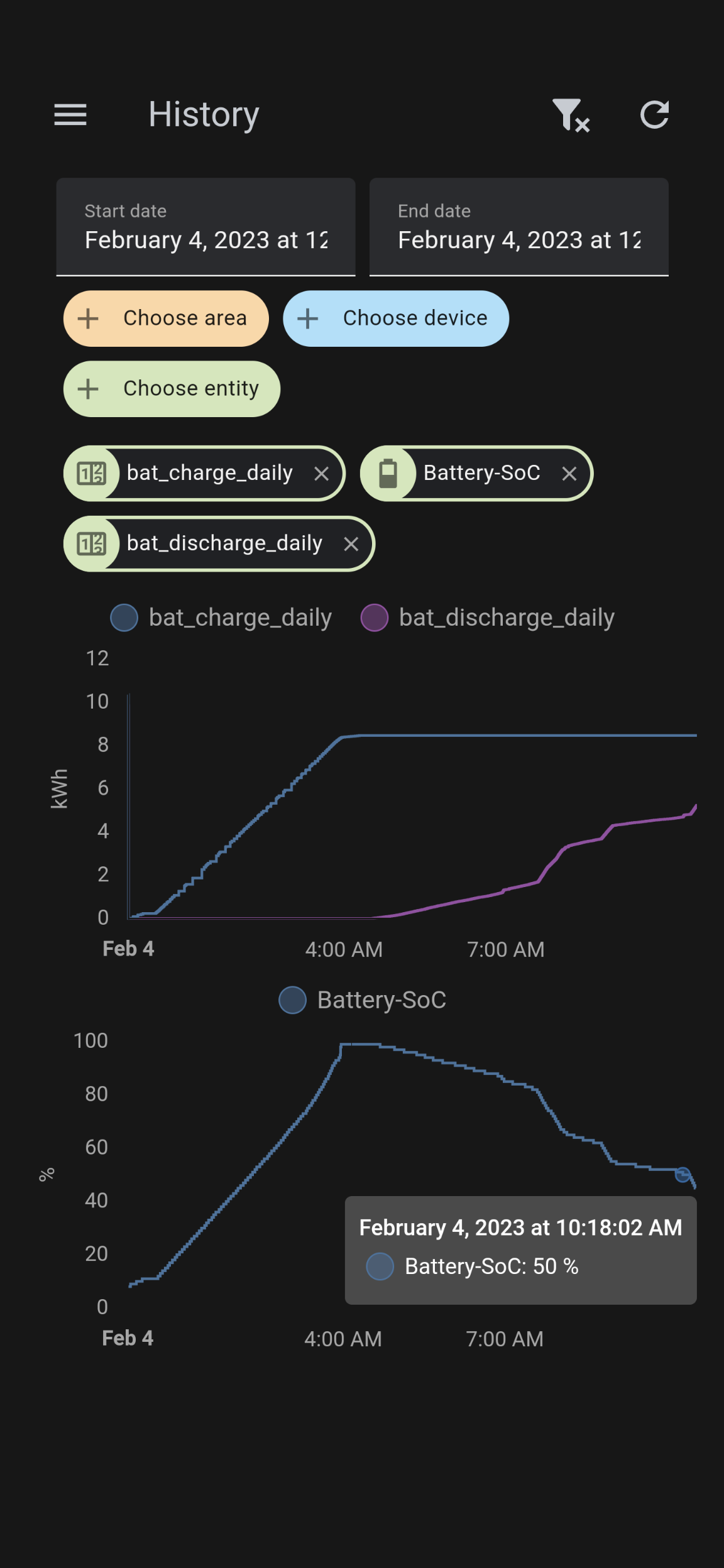

I have the LilyGo CAN485 running with dual can bus. Pretty nice unit.
Edit: Some screenshots from Home Assistant from BMS can comms (MQTT)
