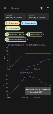

I feel like things are slowly improving. After a charge last night I'm on 5.3kw discharged with 45% left (3.3kw) - should end up around 8.6-8.7kw from 9.26kw usable capacity.

Quick update.
I have the LilyGo CAN485 running with dual can bus. Pretty nice unit.
Edit: Some screenshots from Home Assistant from BMS can comms (MQTT)
