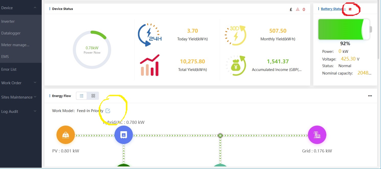

MANAGED TO LOG ON NOW VIA LAPTOP.HOW WOULD I CHANGE MY BATTERIES TO TAEIN POWER FROM THE GRID AT NIGHT AS IM ON OCTUPUS FLUX AND I DONT THINK ITS SHOWING THAT I AM DOING THAT.
Posts: 1557
Ironically it’s much easier to set a charge period in the app, try logging into the V2 app with the same credentials you’ve used on the website, and you will find charge periods in ‘Quick Actions’ - set the time, set it to charge from grid and make sure the slider is enabled.
You can do it on the website but it’s harder to find, It’s under the ‘Device, Inverter’ screen and click the view option on the right hand side of the screen to get to the Inverter Details screen then click the top left where i’ve circled it in red next to battery - that also lets you set the charge period and click ‘save’ when complete.
