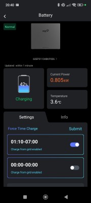

Just had a fox system installed. We have 6 panels and a battery.

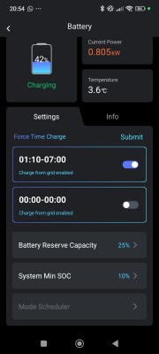

I have set it up in the app to charge overnight when we have a cheaper rate. This was working OK but I just noticed this evening it is now charging outside of the set time. I have attached a screenshot.
Any idea why it might be doing this? And more importantly how I can stop it?

The settings look ok, and you soc is above minsoc (if it were equal to it you will see a small bump charge every hour or two).
But your battery temperature is 3.6C - where are they located, in an enclosure, any insulation?.
When the battery drops below 10C it’s operation will start ti be limited and should it get to 0C the battery will no longer allow charge until the temperature recovers (it will discharge all the way to 10C but cannot be charged) - the BMS will try occasional small low power maintenance charges to keep the batteries warm which I suspect is what is happening here.,

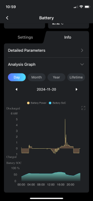

Hi Martyn, mine done exactly the same last evening. Stopped charging around 1130pm. Looking at the graphs, it didn’t look like an occasional low power charge due to temperature but I may be wrong. If it was this then not sure why it would have suddenly stopped?
Here is the charging graph….

It'll definitely be due to the cold. The temperature at the top of your image looks like it's showing 2.2C. It appears the threshold for this behaviour is approx. 4C. Below 0C it won't charge, so it's a last grasp effort by the BMS to maintain the temperature before it gets too cold and can no longer charge.
