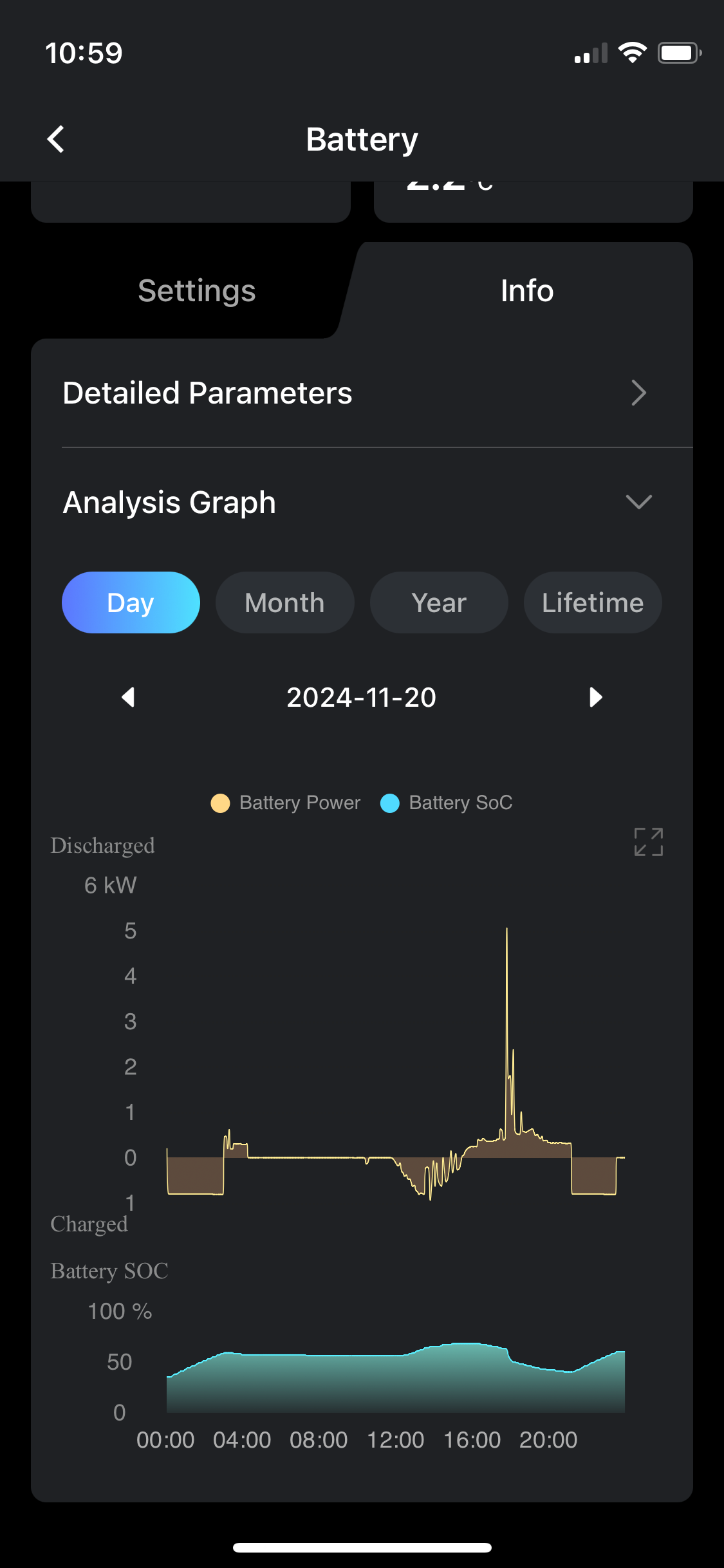

Hi Martyn, mine done exactly the same last evening. Stopped charging around 1130pm. Looking at the graphs, it didn’t look like an occasional low power charge due to temperature but I may be wrong. If it was this then not sure why it would have suddenly stopped?
Here is the charging graph….
