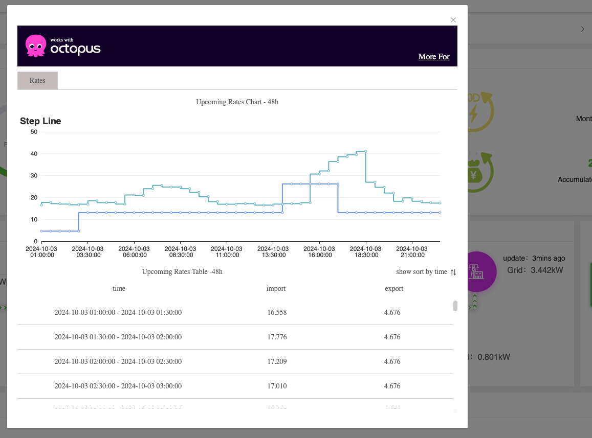

I have just setup Octopus Agile with my fox cloud setup. I can see the details coming through from Octopus in terms of the API calls both on the app and browser. I have attached a screen shot from the browser. However what I can't get is it either to charge when the costs are low or feed in when the payment is at the maximum. I have a H1 inverter and I had it upgrade to the latest firmware after emailed the support team. I have tried both trigger price and Time Slot mode but neither seem to make any difference, so I just wonder what am I missing?
I have tried changing the values for Max and Min SOC but it has no impact.
