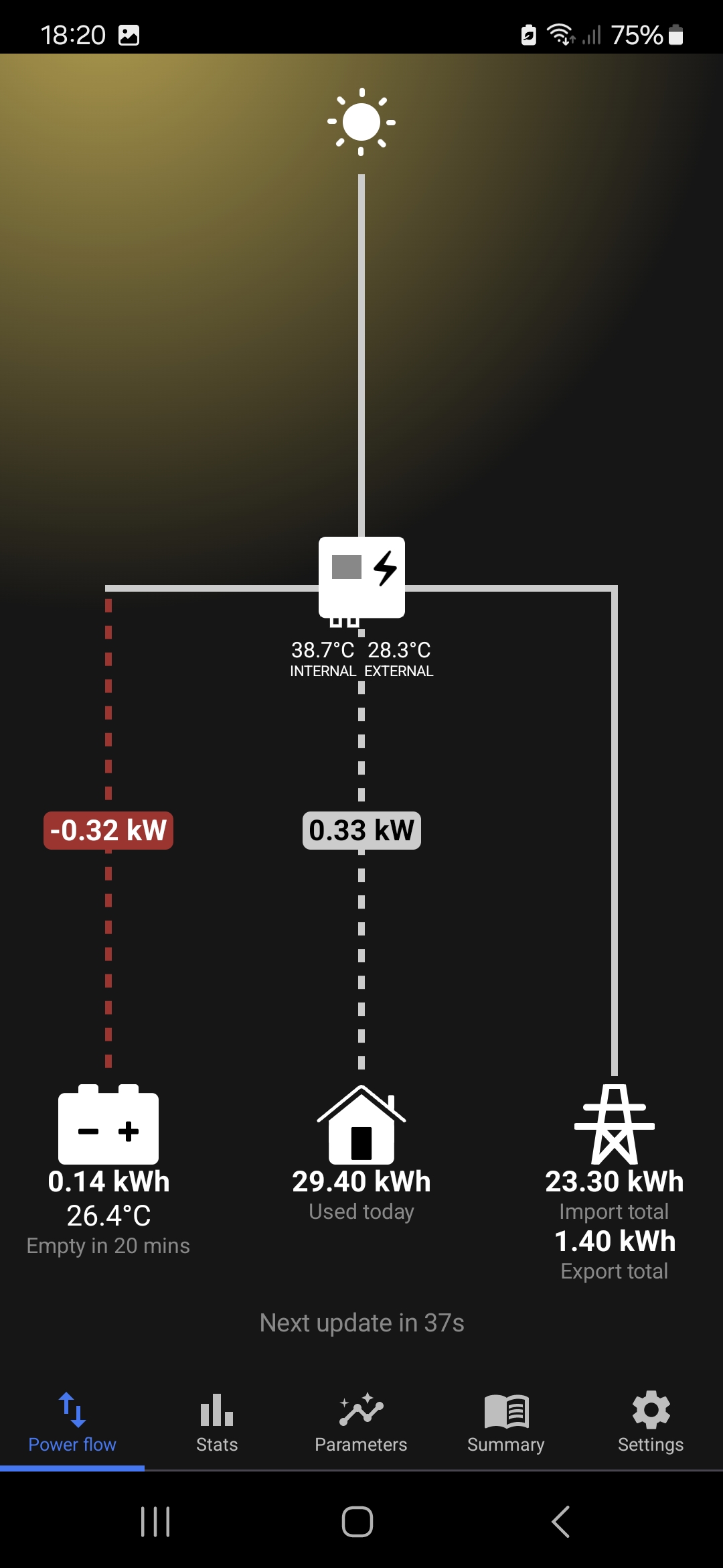

OK, what am I doing wrong here? I attach two screengrabs. The Energy Stats seems to show the battery with a very low SOC, but the Fox app says the battery is 63%.
Posts: 1298
I think you need to go to ‘settings’ and click on ‘Battery’ - about the 3rd line down is your battery capacity - enter your battery size there i.e. if you’ve got 10.4kWh of storage enter 10400 Wh
Northspoon
Posts: 29
Joined: Fri Apr 26, 2024 10:20 am
Aah....thank you, I didn't know I had to input that. That looks better now, the battery says 62 % in Fox, with the Energy Stats showing 8.67kWh left (the battery is 13,980 Wh).
