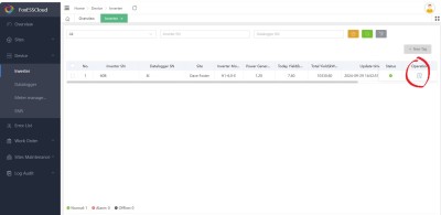

Hi Dave. As per your instructions re: foxESScloud.com, I’m struggling to see the “button under ‘operation’” that leads to the page, the screenshot of which you annotated with red and yellow circles. Please would you send me a screenshot of the preceding screen?
    				    			Ok, yes it's this one
On the left menu, click on Device, then Inverter underneath - it should show you the list on the right and click on the blue 'button thing' where i've ringed it in red

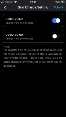

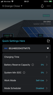

Hi Dave.
I managed to improve the signal strength to the inverter, and tried again to set those 2 parameters as you described earlier.
You previously said “Also double check that you have no charge times set.” I assume you were referring to the settings shown in my screenshot 1? The one setting that was already there was the lower one, and I added the upper one. Did I do this right? I assume so because I then saw that the Quick Settings had changed to what you said they needed to be.
That was yesterday. Today I looked and the 2 settings are back at 0% (screenshot 2)!! Why did they reset?

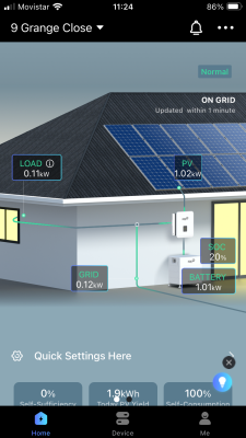

Also, just now I looked at the app and it’s still drawing on the grid although the panels are generating more than enough (screenshot 3).

    				I think the reason they are at 0% is the same reason as before, it was unable to read the battery settings from the inverter.
If you have installed a wifi extender, depending on the make it will usually create a new network called {whatever your old one was)_EXT - unless it was changed by the person that installed it.
If the datalogger has not been connected to the new _EXT name, it will still be trying to connect to your router which probably explains why it's failing.
But looking at your charge time 1, that's the reason why your battery isn't being used - it has been set to 00:00-23:59 (all day) but the charge from grid switch is disabled and when set with a time period like that the battery will neither charge or discharge.
The rules for Charge Periods are -
If you do not want to charge your battery from grid on a low tariff but want to use the battery normally it must be showing 00:00-00:00
If you do want to charge your battery from grid on a low tariff, it should be set for that time period and the charge from grid switch enabled.
If you do not want to charge your battery from grid, or discharge your battery you set a charge period with the grid switch disabled.
i.e. you do not need to set any charge periods to charge your battery from solar, it will do that anyway if it is in the workmode 'Self Use' which yours is.

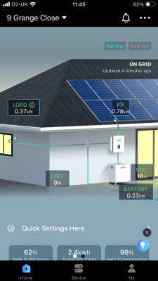

Hello Dave. Been back a week and finally got round to checking the inverter settings directly, using your instructions. I found them to already be at 10%, so  I assumed nothing more needed to be done. (For what it’s worth, the app settings are still showing 0%. You mentioned the possibility of Wi-Fi connectivity issues but the app seems to otherwise provide an accurate snapshot of usage/demand).
From the attached screenshot you will see that when the PV supply is more than enough for the load at the time, the grid is still supplying some. In the final analysis this latter amount is very small, so I’m not too bothered, but I’d like to understand why.
I have also now seen that when the load increases to more than the available PV supply and there is enough charge in the battery, it kicks in, but there is still a small residual demand on the grid. It makes me wonder whether this by design.

    				There will always be a small residual power flow on the grid, the inverter is grid tied which means that it meets the house load by pushing just enough power back into the grid to balance the load it measures on the CT clamp.
When a load changes quickly such as switching a kettle on, the grid instantly provides the power and the inverter provides enough battery power to meet it (which takes a fraction of a second), likewise when the appliance turns off the inverter needs to turn the battery power down it will feed the balance into the grid but again only for a fraction of a second.
As you’ve seen the bias current is very small, usually less than 11 watts, and so even when on battery you are likely to see a small amount of power taken from the grid each day (~0.3kwh).
During the summer when it is exporting most of the time the bias is in the opposite direction so the power used from the grid is much lower on good production days.
