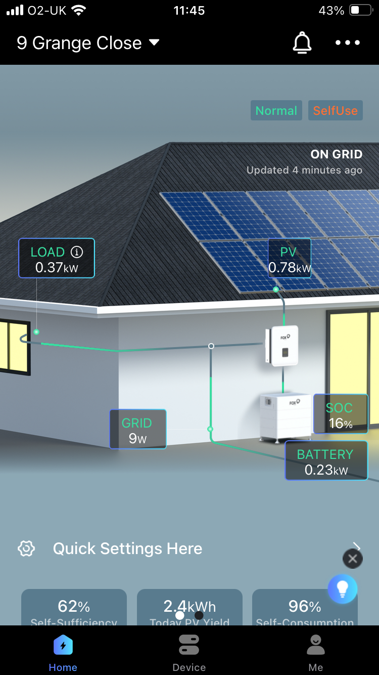

Hi Dave.
I managed to improve the signal strength to the inverter, and tried again to set those 2 parameters as you described earlier.
You previously said “Also double check that you have no charge times set.” I assume you were referring to the settings shown in my screenshot 1? The one setting that was already there was the lower one, and I added the upper one. Did I do this right? I assume so because I then saw that the Quick Settings had changed to what you said they needed to be.
That was yesterday. Today I looked and the 2 settings are back at 0% (screenshot 2)!! Why did they reset?
Also, just now I looked at the app and it’s still drawing on the grid although the panels are generating more than enough (screenshot 3).

- Posts: 1241
I think the reason they are at 0% is the same reason as before, it was unable to read the battery settings from the inverter.
If you have installed a wifi extender, depending on the make it will usually create a new network called {whatever your old one was)_EXT - unless it was changed by the person that installed it.
If the datalogger has not been connected to the new _EXT name, it will still be trying to connect to your router which probably explains why it's failing.
But looking at your charge time 1, that's the reason why your battery isn't being used - it has been set to 00:00-23:59 (all day) but the charge from grid switch is disabled and when set with a time period like that the battery will neither charge or discharge.
The rules for Charge Periods are -
If you do not want to charge your battery from grid on a low tariff but want to use the battery normally it must be showing 00:00-00:00
If you do want to charge your battery from grid on a low tariff, it should be set for that time period and the charge from grid switch enabled.
If you do not want to charge your battery from grid, or discharge your battery you set a charge period with the grid switch disabled.
i.e. you do not need to set any charge periods to charge your battery from solar, it will do that anyway if it is in the workmode 'Self Use' which yours is.

- Posts: 1241
Just a quick follow up, I was on a quarterly update call with Fox last night and it was mentioned they are looking into a problem that is showing the battery soc's at 0% for some users - so this could well be a bug either in their cloud or the app - i'm not sure which yet, but I thought I best mention it as it's probably driving you nuts.
NB: you do still need to remove that charge period for your batteries to discharge correctly.

Hi Dave. Thanks for the update. I don’t think I’ve got a problem with the router signal strength at the inverter, it’s showing 3 bars on the app.
I know what you mean about the SSID business, but I’ve got a “mesh” setup, and the new bit of kit is called a “node”, it isn’t an extender and the SSID stays the same, so mobile devices just latch onto the node(router) with the strongest signal as you move around. At least, that’s my (limited) understanding of the technology.
I have to say that the app wording is confusing anyway. The Grid Charge Setting says “charge from grid disabled” all the time, whether the toggle is off or on . I assume it needs to be on but
when I switch it to “on” (and see a “success” message), if I switch away from that screen then go back again, the toggle has reset itself to the “off” position
