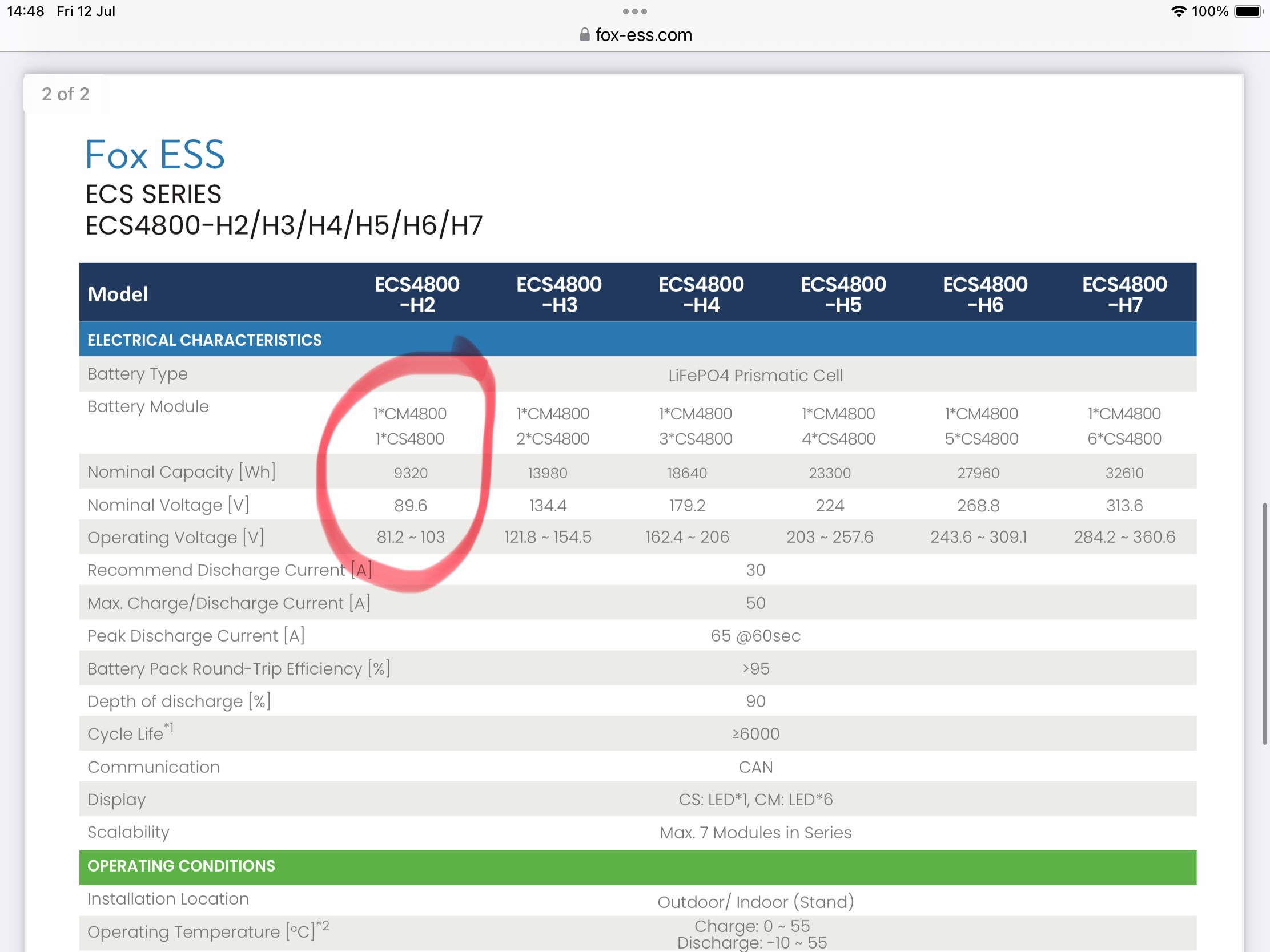

You can’t connect just a CM4800 to a system, it has to be wired in with at least 1 slave attached - it needs the master/slave combo to get past the minimum voltage.
Spec sheet attached.

Thanks for your reply, does the slave battery need to be the same size as the master? Or can I fit the 2.9kw slave?
Thanks again
Posts: 1295
The slave has to be the same size as the master (and any other slaves)
