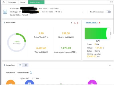

One extra question, the Fox app on my PC only shows the inverter in the device list. Should the batteries show and how do I get that to show? Is that down to the installer to input?

The website is a bit different to the app, to get to the battery details you have to go to the inverter details page, and click on the ‘blue’ words ‘“Battery Status”, it should then pop up a box with your BMS/battery serial numbers.
Thank you very much for your help. BTW, you have quite a battery capacity there. I might need more, but see how it goes with my first winter with PV.
