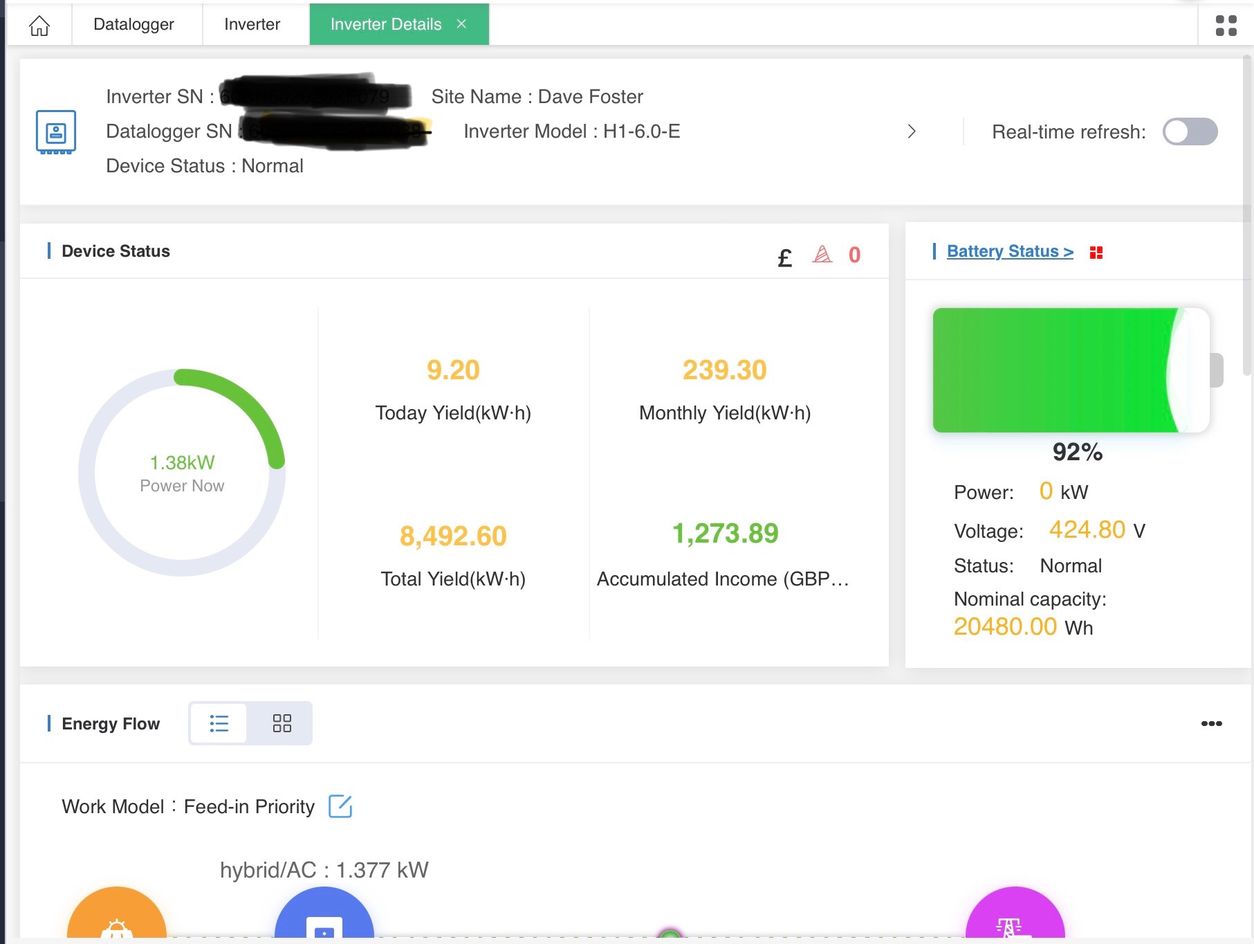

One extra question, the Fox app on my PC only shows the inverter in the device list. Should the batteries show and how do I get that to show? Is that down to the installer to input?
Posts: 1297
That great, and yes that is the correct nominal capacity for 3 * 4800
The website is a bit different to the app, to get to the battery details you have to go to the inverter details page, and click on the ‘blue’ words ‘“Battery Status”, it should then pop up a box with your BMS/battery serial numbers.
