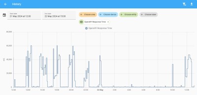

I know Al is on at them several times a week but there's been no update yet on this, my test system is being used to benchmark the API performance which to be honest is unusable at certain times of day - the graph does however show the problems are cyclical and so if you avoid the peak times it works ok.

This issue has been really frustrating me, so I was really relieved when I saw your graph - It tells us that it will work at the half of the time that surrounds odd hour numbers (on BST ) - eg 12:30-13:29, but not so well on the even hours eg. 13:30-14:29.Dave Foster wrote: ↑Wed May 22, 2024 1:10 pm I know Al is on at them several times a week but there's been no update yet on this, my test system is being used to benchmark the API performance which to be honest is unusable at certain times of day - the graph does however show the problems are cyclical and so if you avoid the peak times it works ok.
This pattern suggests that the server hosting the API has a big process that repeats every 2 hours, so it should be easy for the Devs to spot. I'm sure that they wouldn't be running the API front-end on the same 'hardware' as the back-end processing (eg. summarising 5-minute chunks to hourly and daily totals), would they? Of course, waiting for additional hardware would explain the time needed for a fix...
