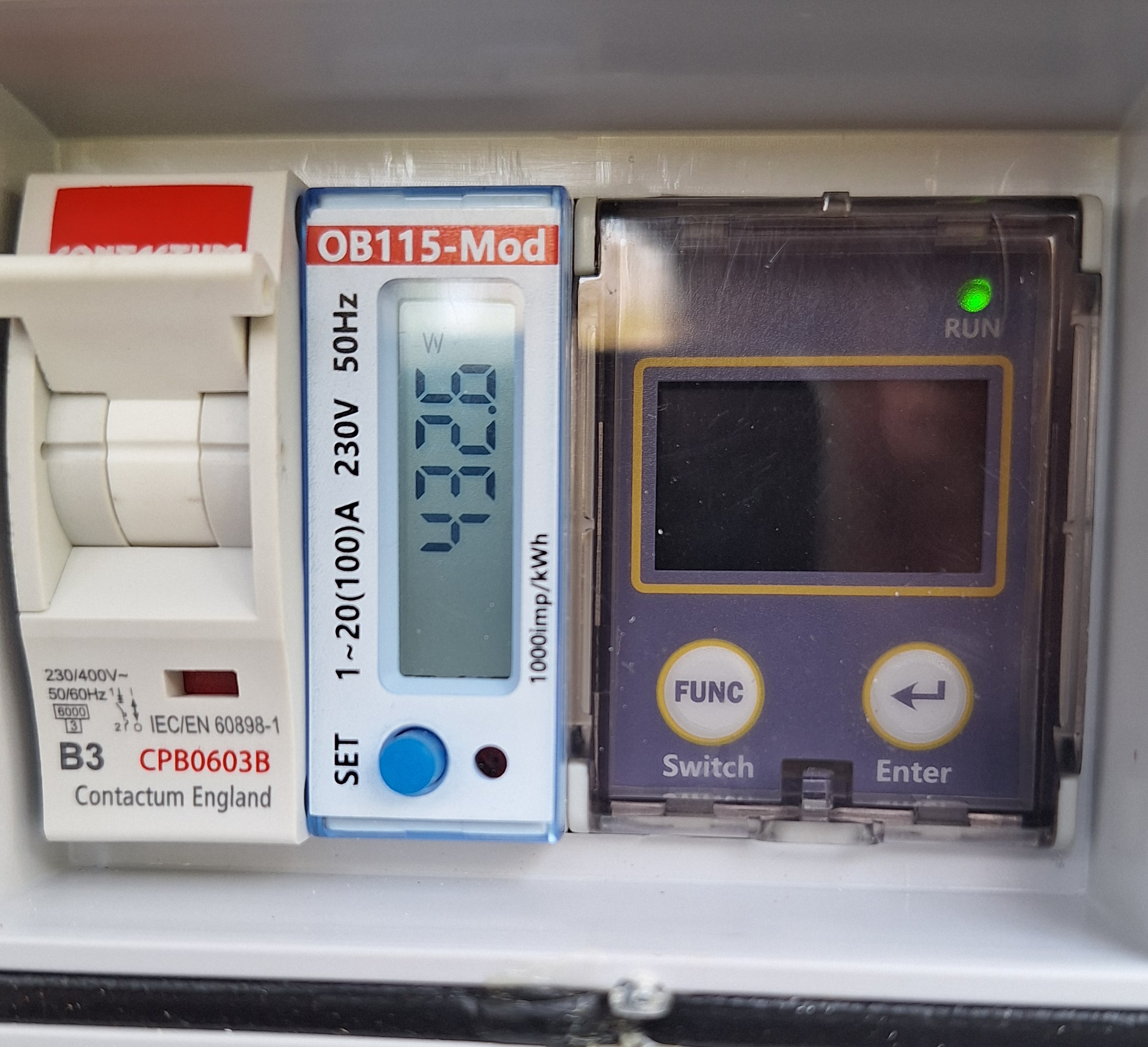

This is a photo of the box that has been fixed under my outdoor meter box. The CT clamp is inside that meter box.
Re: Error code 240 "Manger fail to detect CT"
Just thought I would ask if that photo shows a R485 meter module?
Northspoon wrote: ↑Mon Apr 29, 2024 2:09 pm Just thought I would ask if that photo shows a R485 meter module?
That’s a modbus CT clamp, similar in that it converts the CT clamp measurement to a modbus RTU serial data stream that can be transmitted over distance.
An RS485 meter measures the power directly a bit like a smart meter, it then encapsulates it into an RS485 packet for transmission over distance as it is a packet based system it is effectively designed to be used this way.

I didn’t really want to speak out against your installer, a CT or meter is critical to the systems operation and must be connected securely. I have not heard of this CT clamp transmitter being used on a Foxess system, I am told the Givenergy system will work but from what you have said the error you see suggests it does not work on Foxess.
The normal configuration for a Foxess inverter where it sends it’s data over a link would be to use a Chint or Eastron meter (both listed in the installation manual) which is designed to send over a long cable or data stream (such as LoRa).
