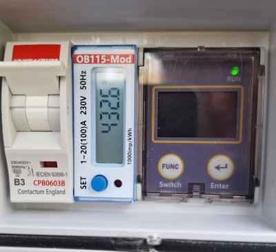

This is a photo of the box that has been fixed under my outdoor meter box. The CT clamp is inside that meter box.

Just thought I would ask if that photo shows a R485 meter module?

That’s a modbus CT clamp, similar in that it converts the CT clamp measurement to a modbus RTU serial data stream that can be transmitted over distance.Northspoon wrote: ↑Mon Apr 29, 2024 2:09 pm Just thought I would ask if that photo shows a R485 meter module?
An RS485 meter measures the power directly a bit like a smart meter, it then encapsulates it into an RS485 packet for transmission over distance as it is a packet based system it is effectively designed to be used this way.

Thanks Dave,
Sorry for my lack of knowledge, but are you saying that what the installer has fitted is wrong and that is why I get that error code?
Stll hoping that the installer can get the system working using a LoRA link.

I didn’t really want to speak out against your installer, a CT or meter is critical to the systems operation and must be connected securely. I have not heard of this CT clamp transmitter being used on a Foxess system, I am told the Givenergy system will work but from what you have said the error you see suggests it does not work on Foxess.
The normal configuration for a Foxess inverter where it sends it’s data over a link would be to use a Chint or Eastron meter (both listed in the installation manual) which is designed to send over a long cable or data stream (such as LoRa).
I’m sure your installer will get this sorted.
