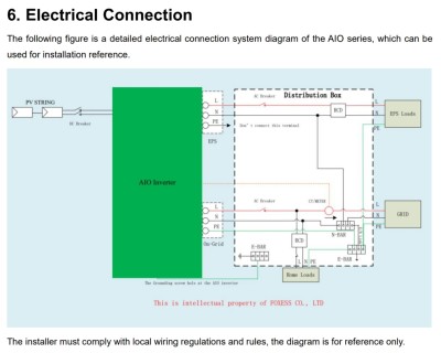

Came across this diagram in the Fox AIO installation guide, using internal switch mode:
Clearly shows direct bonding of EPS N to grid N (no switch). This avoids EPS floating and generating a signficant N-E potential.
Also shows EPS E not connected. I checked this and EPS E is bonded to grid E inside my H1-6.0-E, so my assumption is that this is so any external fault current is not sent through the inverter EPS connection.
Don't know if this helps?

Thank you Tony, that is interesting.
There are two similar diagrams in the AIO installation guide, one as you post showing permanent N-E bonding in the distribution box and the other showing no N-E link at all.
(The distribution box is probably the EPS box shown in a preceding diagram. This seems to be a Fox ESS accessory, a web search discovered a manual for it.)
The H1/AC1 User Manual on the Fox website also includes the same diagrams, although my paper manual that came with the inverter does not.
Both of these diagrams relate to installations where the EPS is permanently supplying a subset of loads that are required to be kept going on loss of grid, in effect a UPS for some loads. See Ryan Morgan's post 'What is EPS?', this would correspond to what Ryan calls Level 1 or Level 2.
My installation has a manual changeover switch to the whole house supply, so that when the grid dies, the battery and inverter will run the whole house, subject of course to not exceeding the maximum inverter power. This is the same as would be done with a backup petrol generator.
This corresponds to Ryan's Level 3.
The Fox ESS guides and the diagrams direct the installer to follow local (country) installation practice. The diagrams will suit some countries' practices but not others. In the UK, there should be only one N-E bond in the supply.
In a TN-S supply, this is at the DNO supply transformer. In a TN-C-S (PME) supply, there is a combined PEN conductor into the premises, which then splits as separated N and E.
The concern is that when the supply is lost and the PV/battery/EPS system is disconnected from the grid and operating as an island, it becomes a TN-S system. In other words, it takes the place of the DNO supply transformer. The single N-E bond should then be made at the battery/inverter 'generator' while, and only while, the system is operating in island mode.

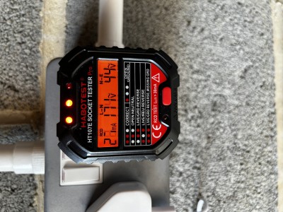

We got a fox hybrid inverter fitted and I've just gone to connect a battery system to it (Fox ess) and discovered that the installer never even earthed the system. Is this usual practice in the UK if inverter is in the attic?
I checked in the inverters handbook and it mentions the red led being on if there is an earthing fault, yet the engineer said it was on because we had no battery system.
- Posts: 1256
The inverter will be earthed via the ‘grid’ connection - this is the main LN-E feed from the grid, if you mean the earth point on the right hand lower side, that is the earth take off point to earth the battery pack - it can also used in off-grid connections where no earth is presented to the grid connector.NorthernLad wrote: ↑Tue Aug 13, 2024 9:52 pm We got a fox hybrid inverter fitted and I've just gone to connect a battery system to it (Fox ess) and discovered that the installer never even earthed the system. Is this usual practice in the UK if inverter is in the attic?
If the inverter detected an earthing fault it would disconnect and stop operating.
The red light is simply an ‘error’ light which would be illuminated if there were no battery pack fitted.
As you are connecting a battery system, you simply connect from the earth point on the lower right hand side to the earthing point on the battery pack (if you have the HV series you have to daisy chain it between each battery pack).
