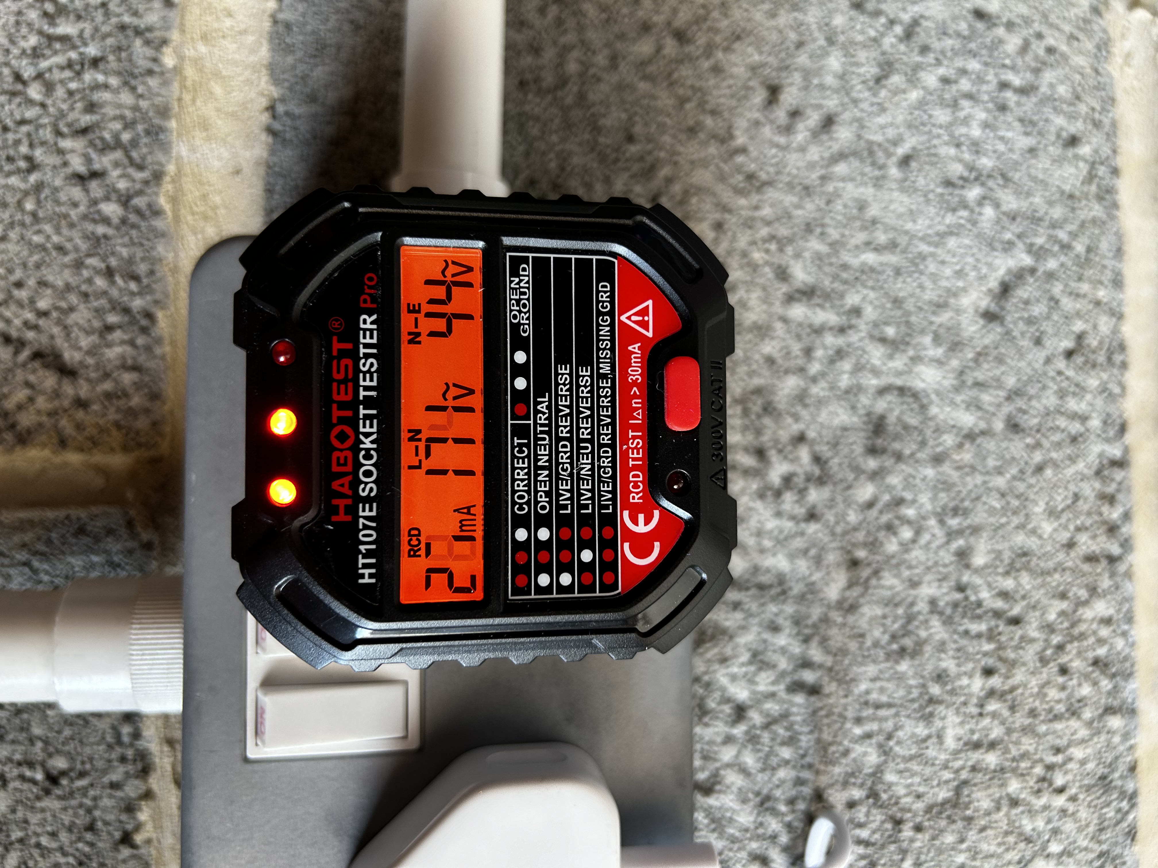

When operating as an EPS in island mode, typically to supply the whole house in the event of grid failure, there needs to be an effective earth and a Neutral-Earth bond.
The need for an earth that does not rely on the distributor's earth seems to be well accepted in these discussions. One cannot rely on the distributor's earth as, for example, the reason for the grid failure may be that the cable has been cut. However, that is easily sorted by installing a local earth rod connected to the main earth terminal on the incoming distribution board.
The need for N-E bonding is more subtle. When switching to island operation, the supply N-E bond is lost and so a N-E bond should be switched in at the new power source - the inverter. Several documents and YouTube videos show this being done by a separate relay or contactor, but it could equally well be performed by an additional switch section on the changeover switch.
This seems not to be provided on my installation, in island mode there is significant voltage neutral to earth, as others have noted. The inverter clearly does not make this bonding connection automatically
My question is, how have others addressed this issue?

Have you made any progress on this? I'm experiencing the same voltage difference between N and E when in EPS mode.

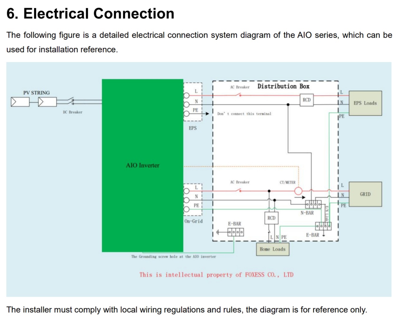

Came across this diagram in the Fox AIO installation guide, using internal switch mode:
Clearly shows direct bonding of EPS N to grid N (no switch). This avoids EPS floating and generating a signficant N-E potential.
Also shows EPS E not connected. I checked this and EPS E is bonded to grid E inside my H1-6.0-E, so my assumption is that this is so any external fault current is not sent through the inverter EPS connection.
Don't know if this helps?

Thank you Tony, that is interesting.
There are two similar diagrams in the AIO installation guide, one as you post showing permanent N-E bonding in the distribution box and the other showing no N-E link at all.
(The distribution box is probably the EPS box shown in a preceding diagram. This seems to be a Fox ESS accessory, a web search discovered a manual for it.)
The H1/AC1 User Manual on the Fox website also includes the same diagrams, although my paper manual that came with the inverter does not.
Both of these diagrams relate to installations where the EPS is permanently supplying a subset of loads that are required to be kept going on loss of grid, in effect a UPS for some loads. See Ryan Morgan's post 'What is EPS?', this would correspond to what Ryan calls Level 1 or Level 2.
My installation has a manual changeover switch to the whole house supply, so that when the grid dies, the battery and inverter will run the whole house, subject of course to not exceeding the maximum inverter power. This is the same as would be done with a backup petrol generator.
This corresponds to Ryan's Level 3.
The Fox ESS guides and the diagrams direct the installer to follow local (country) installation practice. The diagrams will suit some countries' practices but not others. In the UK, there should be only one N-E bond in the supply.
In a TN-S supply, this is at the DNO supply transformer. In a TN-C-S (PME) supply, there is a combined PEN conductor into the premises, which then splits as separated N and E.
The concern is that when the supply is lost and the PV/battery/EPS system is disconnected from the grid and operating as an island, it becomes a TN-S system. In other words, it takes the place of the DNO supply transformer. The single N-E bond should then be made at the battery/inverter 'generator' while, and only while, the system is operating in island mode.

I got a H1-G2 installed this week. I've been playing about with the EPS mode and grounding today. From my testing it seems to verfify what others have said. When on-grid, The grounding setting seems to do nothing whatsoever, which I assume is normal operation. However by simulating a power cut, when grounding is set to on, N & E are bonded together, verified with resistance testing, voltage testing and socket testing. When grounding is set to off, N & E are not bonded together, and the Earth is 'floating' with reference to N and L. Changing the setting whilst inverter was disconnected from grid resulted in an audible relay click, but whilst connected to grid, no relay click could be heard. In both modes, the Earth terminal on the EPS and the Earth on the chassis appear to be connected together. I imagine they are permanently connected inside.
In my opinion it should be in the manual as it's an important safety setting, and probably should be labelled as N&E Bonding rather than just Grounding in the settings, and probably should be under EPS settings too rather than Features (my firmware Master 1.53, Slave 1.04, ARM 1.39)
There is also no right answer whether it should be On or Off, This all depends on your earthing arrangements and regulations where you live. In my case, it should be On, but someone else, it should be off. Also if you have a changeover switch which bonds N&E together, you must have it set to off, otherwise you'll have current flowing in the earth as there should only be exactly 1 bond in place at any one time.

We're fitting a newer H1 with the built in NE bonding.
Also using an EPS back up box.
Is there any reason why we can't use the contactor in the box to disconnect the E on the TNCS earthing system on power failure - hence relying just on the installed earth rod? rather than some sort of external solution?
Update, NO, you can't use the contactor in the EPS box - we went with the external solution.

I'm no electrician but as far as I understand it only the N and L need to be isolated from the grid, to avoid back feeding and all the problems and dangers that causes. No need to disconnect the E in the UK if the earthing installation is good. The earth rod can be part of the permament installation, which becomes a supplementary earth, to supplement the TNC-S under normal grid operation.
The earth rod and associated cabling needs to be up to regulations and a certain size and connect directly to the MET in a single run. I used 16mm² for my earth rod with a earth loop measurement of around 60ohms from memory, compared to about 0.2ohms through TNC-S (again from memory.)
In my case on loss of power (or simulated) N&L is isolated from the grid supply, The N on the EPS output is no longer bonded to E due to the prior isolation, so my H1-G2 bonds N-E inside the inverter.
When operating on grid since N (and L) are not isolated, N and E are bonded by my DNO cutout's TNC-S instead. but only one bond is in place at any one time.
Like always, consult someone qualified if unsure.
