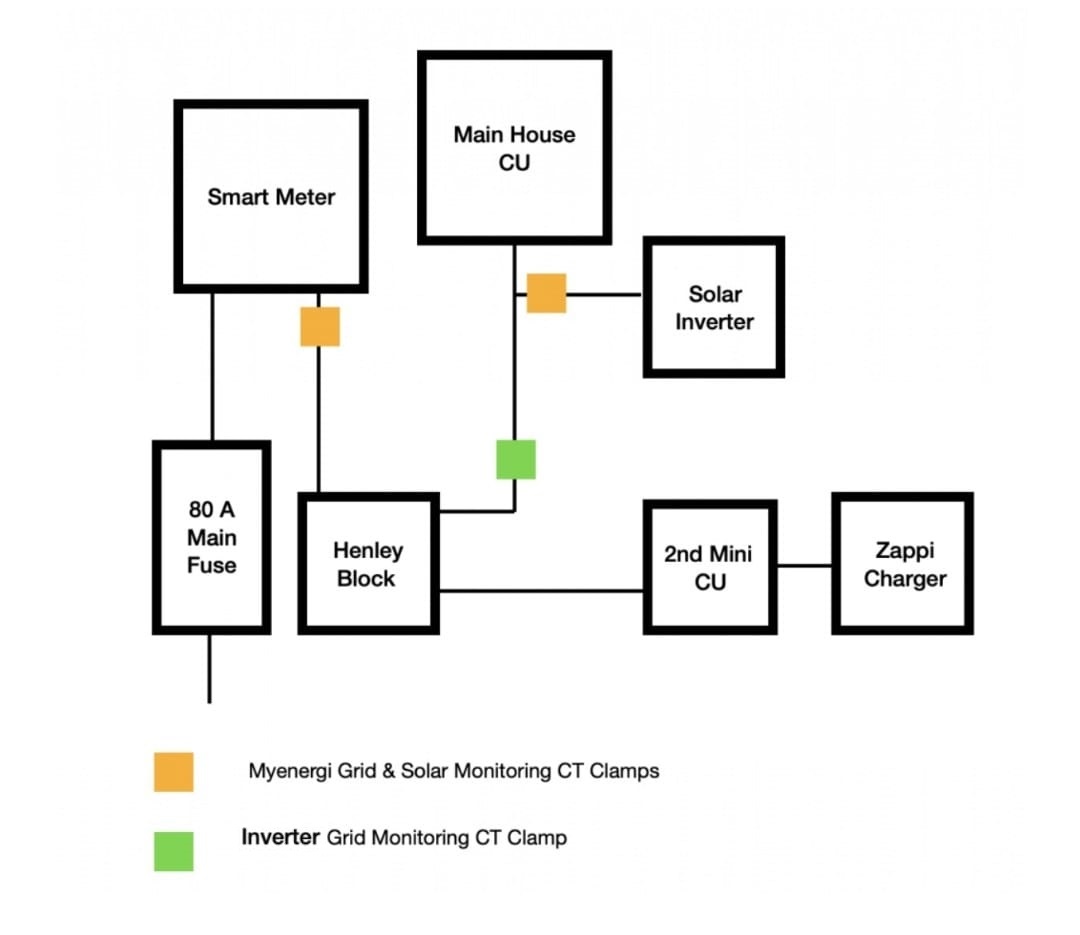

Now we have new modes and templates, has anyone created an automation to connect Octopus Intelligent Go & Zappi with FoxEss to stop the Zappi discharging the battery - out of the 11:30 to 5:30am cheap period if Octopus command the zappi to charge?
I was thinking about getting them to install a henley block and sub main board so the FoxEss system can't see the Zappi load but very limited space to install and I'm not confident the installers would understand what I would be asking them to do - it's a zappi 'supply and install deal' - fixed price.

The sure way to stop your Zappi discharging your home battery is to fit it in such a way so that the inverter doesn't see it as house load - This is done by fitting a Henley block which splits the feed coming out of the smart meter - one feed goes to the house, the other to the Zappi charger - I don't think the extra CT clamps will help.Jonesey wrote: ↑Fri Mar 01, 2024 11:30 am I'm having the same issue, ordered zappi from Octopus EV and charger was installed by sub contractor and not an Octopus installer as expected.
Zappi discharges home battery first unless I charge home battery at the same time, not easy when IOG has charging sessions outside of 23:30 - 05:30 window and as the lighter days are approaching I don't want to charge the home batteries every night. Called Octopus EV and complained and was asked if the installer had installed an extra 2 CT clamps which I confirmed they hadn't, just the one that came with it. Octopus customer advisor expressed surprise that this had not been done and has confirmed that a revisit will be required to install 2 more CT clamps. Revisit will be foc as normal practice to install extra clamps when solar/batteries are on site. I'm still waiting, now over 3 weeks for the revisit to be booked.
i've attached a schematic which shows this, hope it helps.
